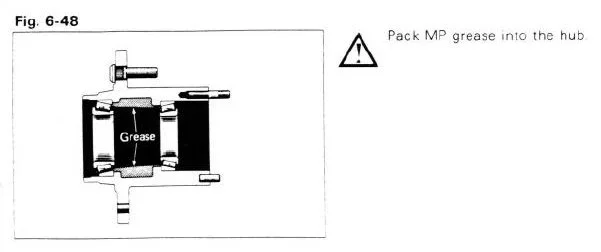

I am rebuilding the hubs as well as the knuckles with new wheel and trunion bearings. I'm worried about this idea of overpacking grease leading to premature wear. I used synthetic lithium grease in the hubs and put a fair amount in there. When I pulled my hubs the entire knuckle was filled with grease, which is what I had intended to do myself. Naturally I am also going to pack the bearings. How do I tell "too much grease" from "enough grease"?
No more than this for your hubs:
(1980 Chassis & Body FSM)
As far as the knuckles are concerned ... I don't think you need to worry (so long as you don't let that grease dry out to the point where it doesn't want to move at all). Surplus grease there will soon get pushed out your wiper seals IMO.
(On the rare occasions when my knuckle grease gets too dry I squirt a little gear oil in there.)
