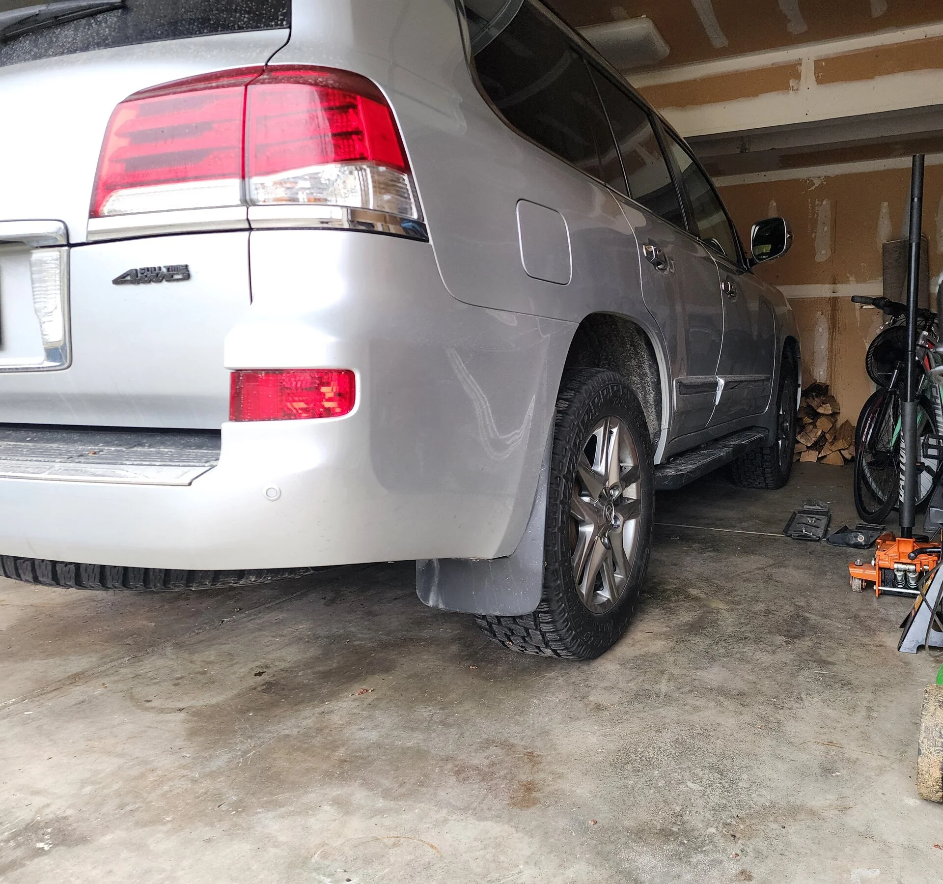

I'm thinking about installing a set of Cruiser Teq 15mm rear coil spacers on my 2015 LX570. I recently removed the AHC suspension, and installed stock 200 series L.C. suspension for the time being.
I also installed a set of OEM 10mm front spacers to level out the front and back. Well now, my LX looks too level, to the point that any unevenness on the ground makes the rear look like it's sagging, and this is with the 3rd seats removed as well.
Will a 15mm spacer be enough to give me a slight rake in the rear to help with this issue? Any good or bad you guy's can share with using the spacers vs. going the route of a longer spring?

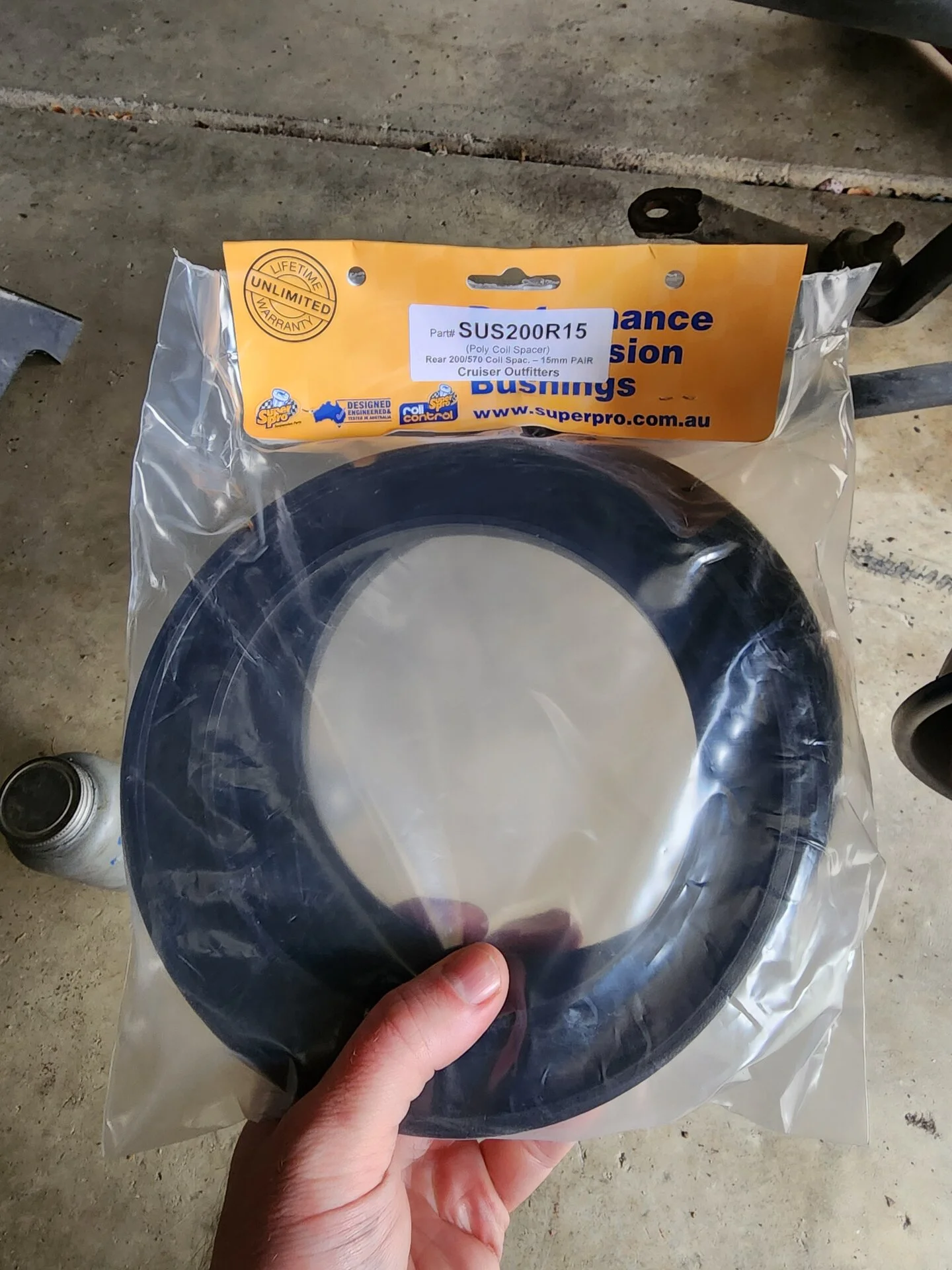

I ended up purchasing the spacers in the pic this morning. I'm not looking for alot of rear rake, just enough to make the rear look higher than the front, and not like it's sagging. Hopefully these will do the trick.

Well spacers in the rear are an easy install but they are 1:1 so 15mm spacer is gonna give you 15mm of lift 👍
The rears are easy, pull the coil, remove the internal jounce stop, and put the spacer on the jounce stop then reinstall it.

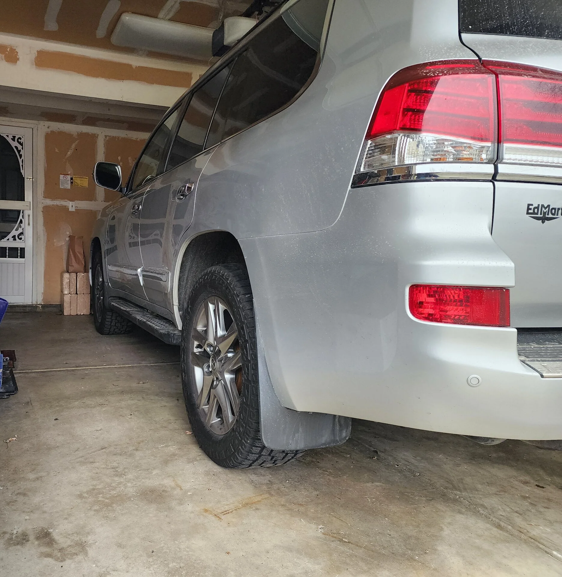

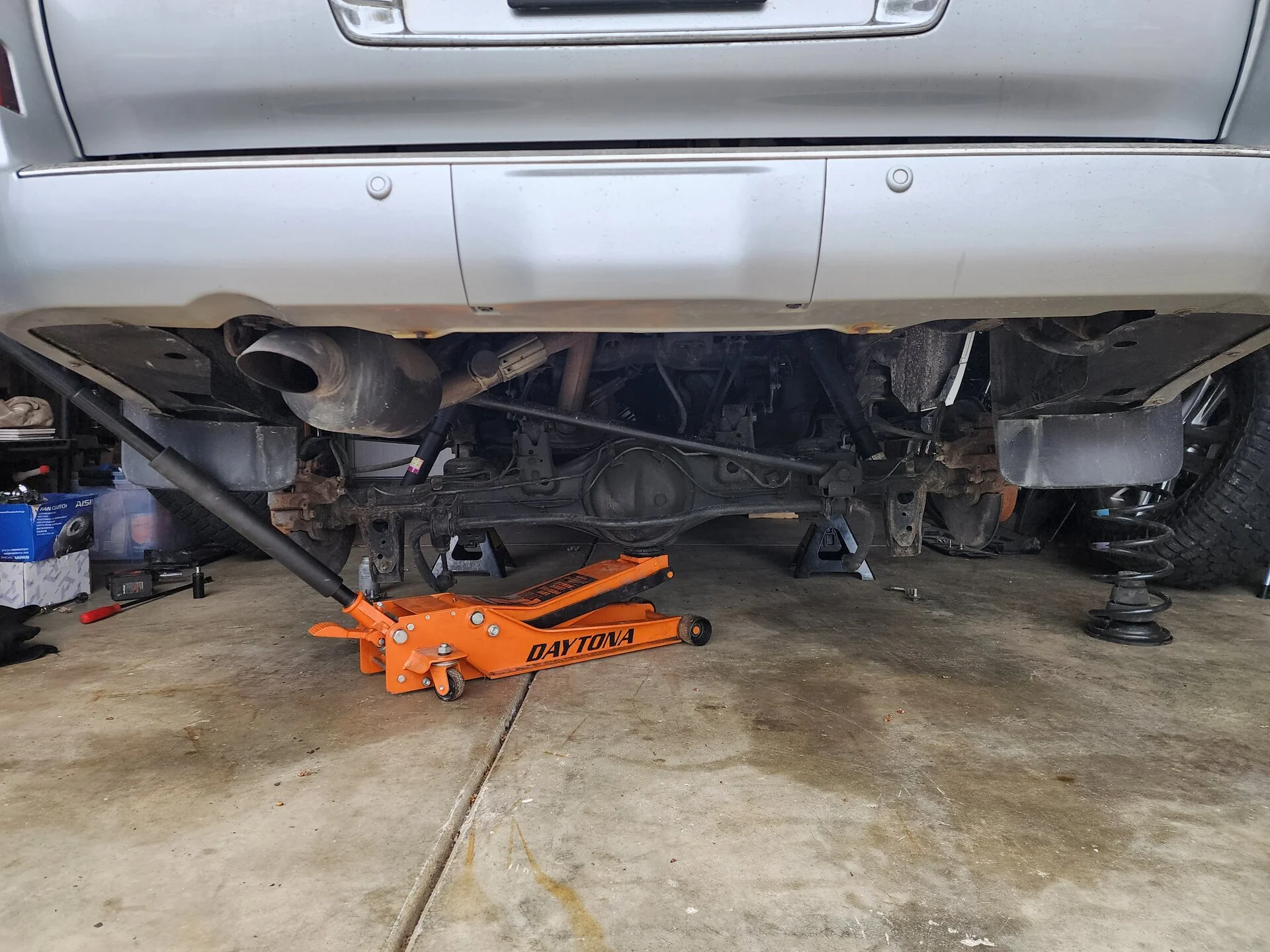

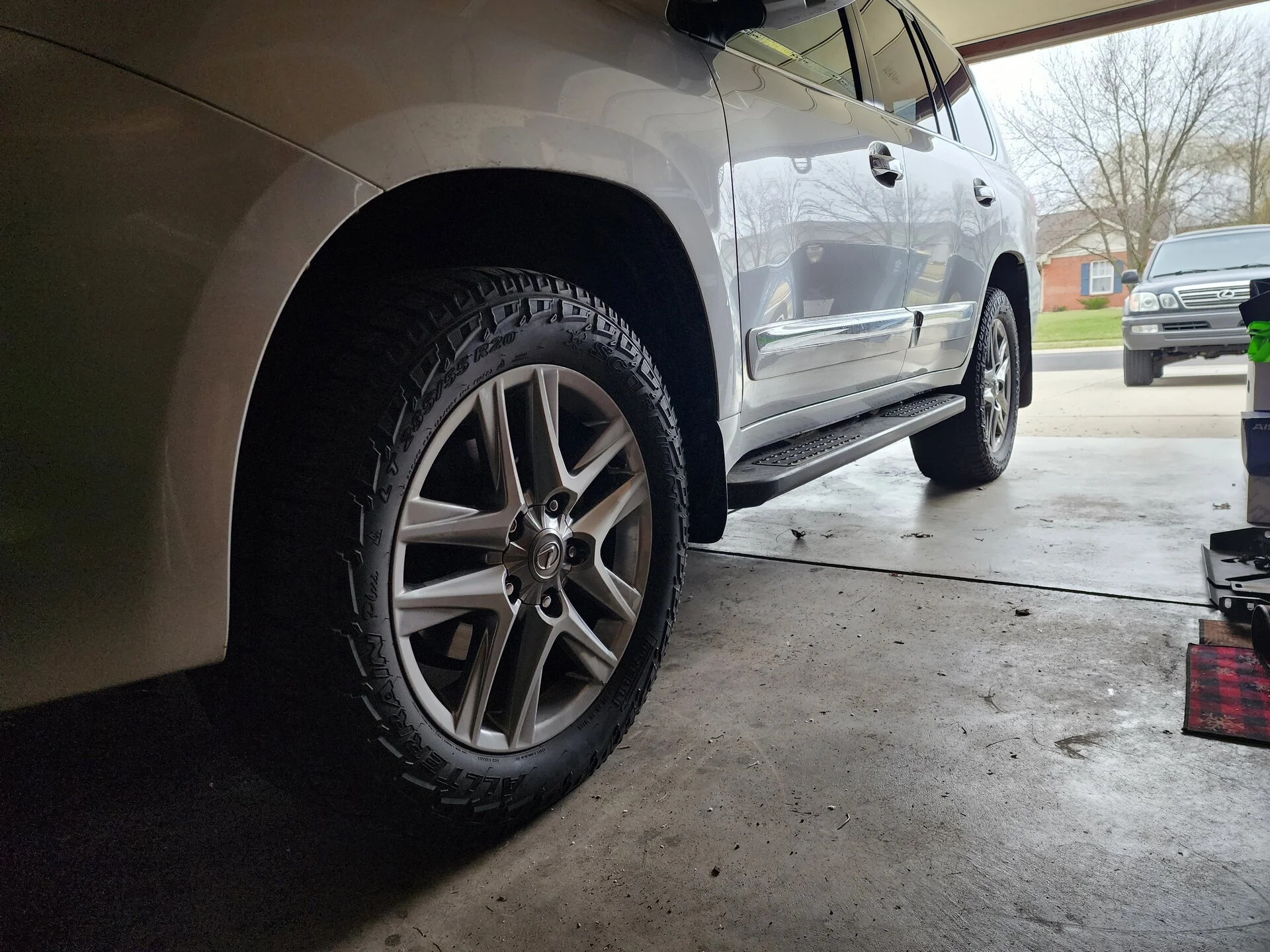

Just finished up the job, it went super smooth.
- 30 mins to remove both rear tires, the spare, disconnect the sway bar, remove lower shock bolts, and remove spring.
-4.5hrs on waiting for the mailman to deliver. It's funny how for the past two weeks the mail has been delivered before 11am everyday, except for today🤷‍♂️
- 1hour to install, and put everything back together.

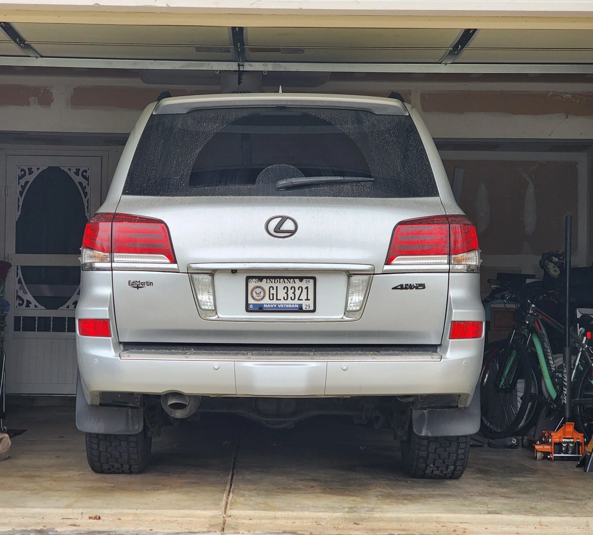

-Before and after measurements:
Before:
Driver side front :20-1/2"
Driver side rear : 20-1/4"
Pass side front : 21"
Pass side rear : 20-3/4"
After with spare tire installed :
Driver side front : 20-1/2"
Driver side rear : 21-5/16"
Pass side rear : 21-7/8"
-Final thoughts:
I'm alot happier with the spacers installed. The rear doesn't look like it's sagging now. However, as you can see, the driver side rear still has a slight lean to it. So I'm going to probably purchase either a 5mm, or 20mm spacer and installed it, and see if that helps correct the lean.

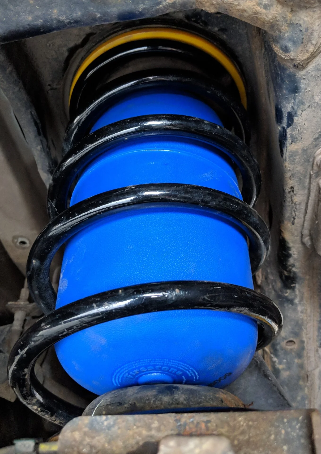

Eventually added airbags as I tow and a loaded bike carrier is heavy. The added benefit is to be able to tweak the air pressure to reduce the KDSS lean.
You used an OME 80 series spacer on your 200 series rear springs, am I understanding that correctly? If so l, did you have to mod the OME spacer, or did it fit right in?
Airbag wise how are those ride wise, and do you have a link to where you purchased them from? I think that would be a good investment more me to look into having. My parents live 3hrs north of me. The last 3 times I make a trip home, my Dad loaded up the back of the LX with firewood for us. At that time, the AHC suspension was still working. I'm thinking installing those air bags would help compensate ride & weight wise for what I lost from removing the AHC suspension.

Do you have a link to these progressive bump stops? Like I mentioned earlier, I'm thinking about adding rear air bags for when I'm hauling stuff, so those bump stops would probably accommodate the air bags as well.
I have these but Timbren also makes one that would work.
