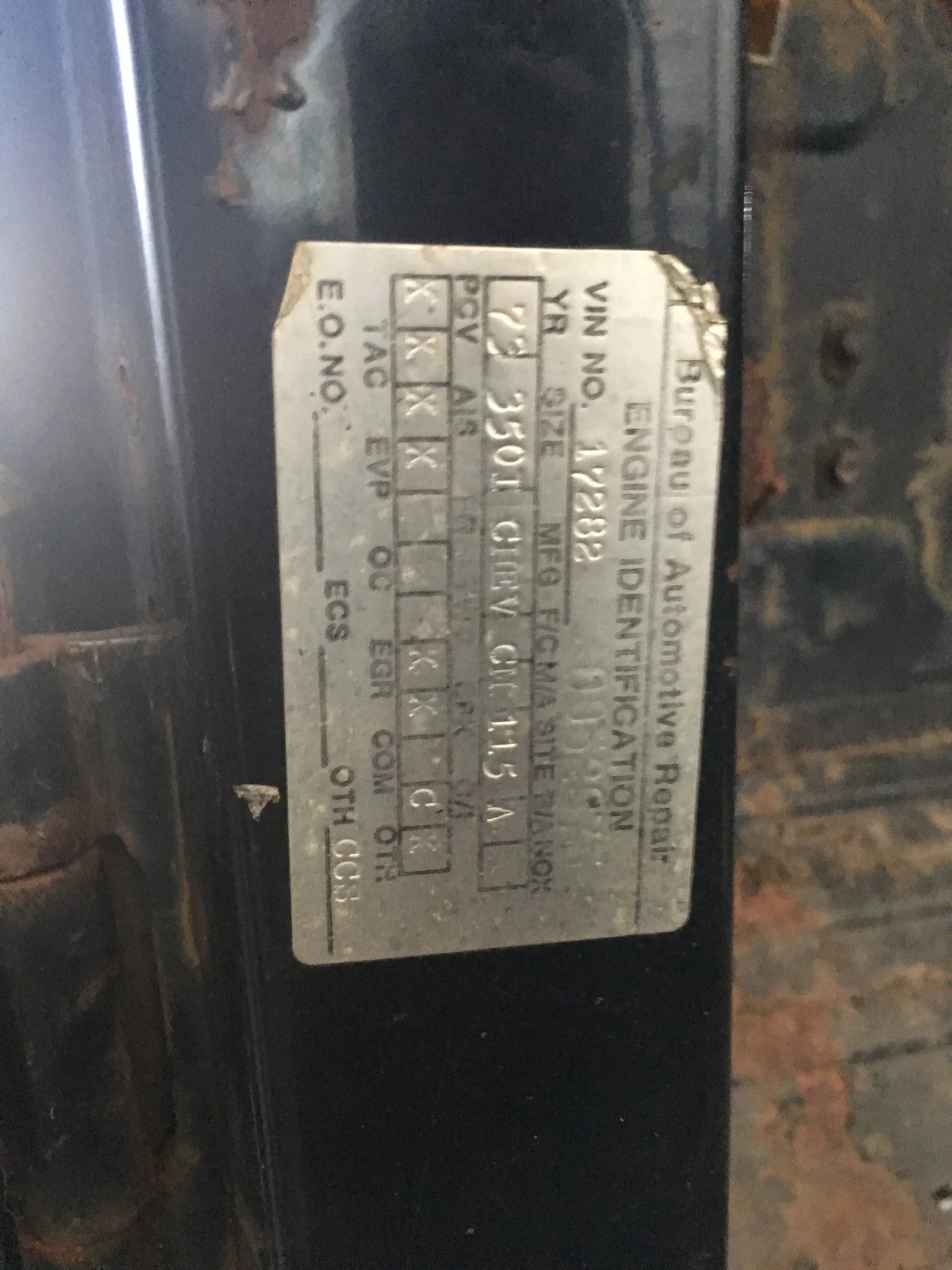

1971 tub has a oem like vin sticker and a riveted plate that says bureau of automotive repair and shows a vin number (on the diver door side)

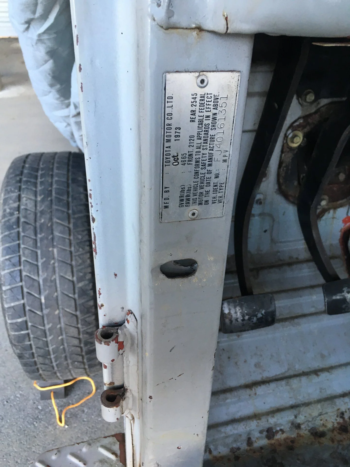

1974 has the vin plate riveted like most toyotas (on the diver door side)

74 oem plate
And the 71 replacement
Cant be swapped

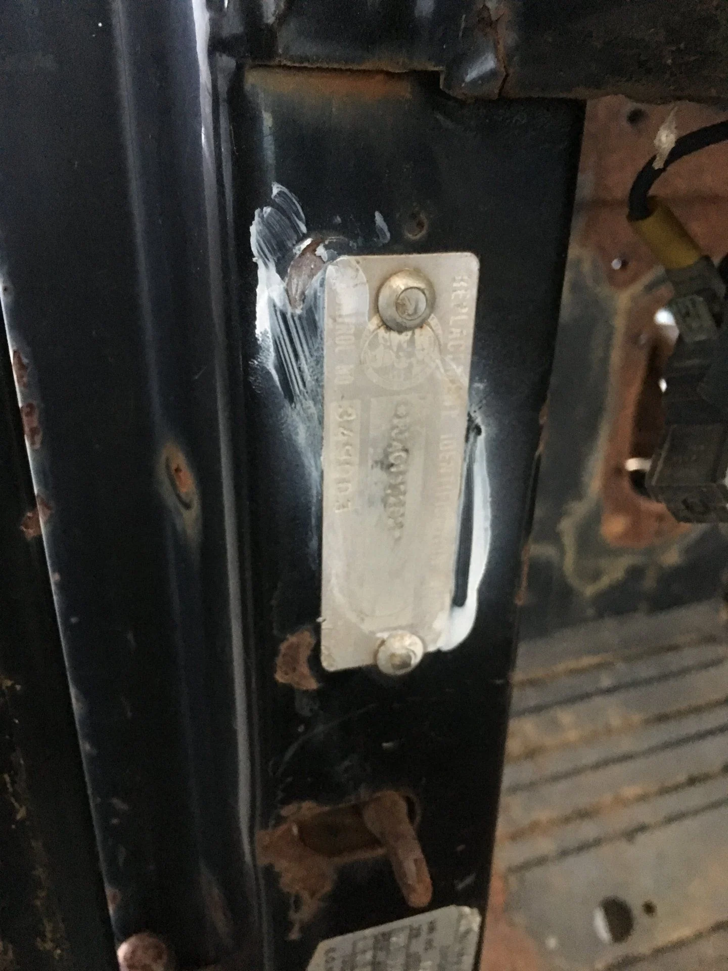

In Cali Vin always follows the frame. if you use another tub, vin plates will be removed and a blue tag will be installed (2nd picture) installed by California Highway Patrol.

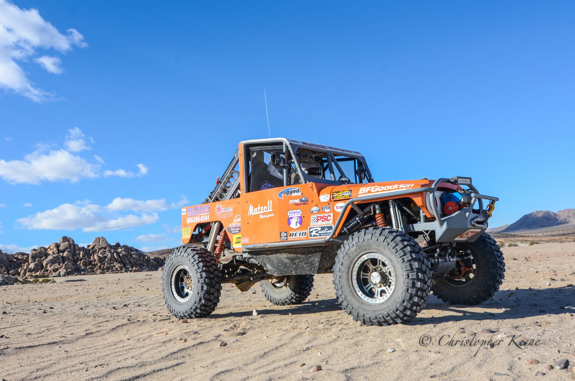

Here is a pic of my 1973 FJ40 titled, registered, insured, and tagged here in VA.
