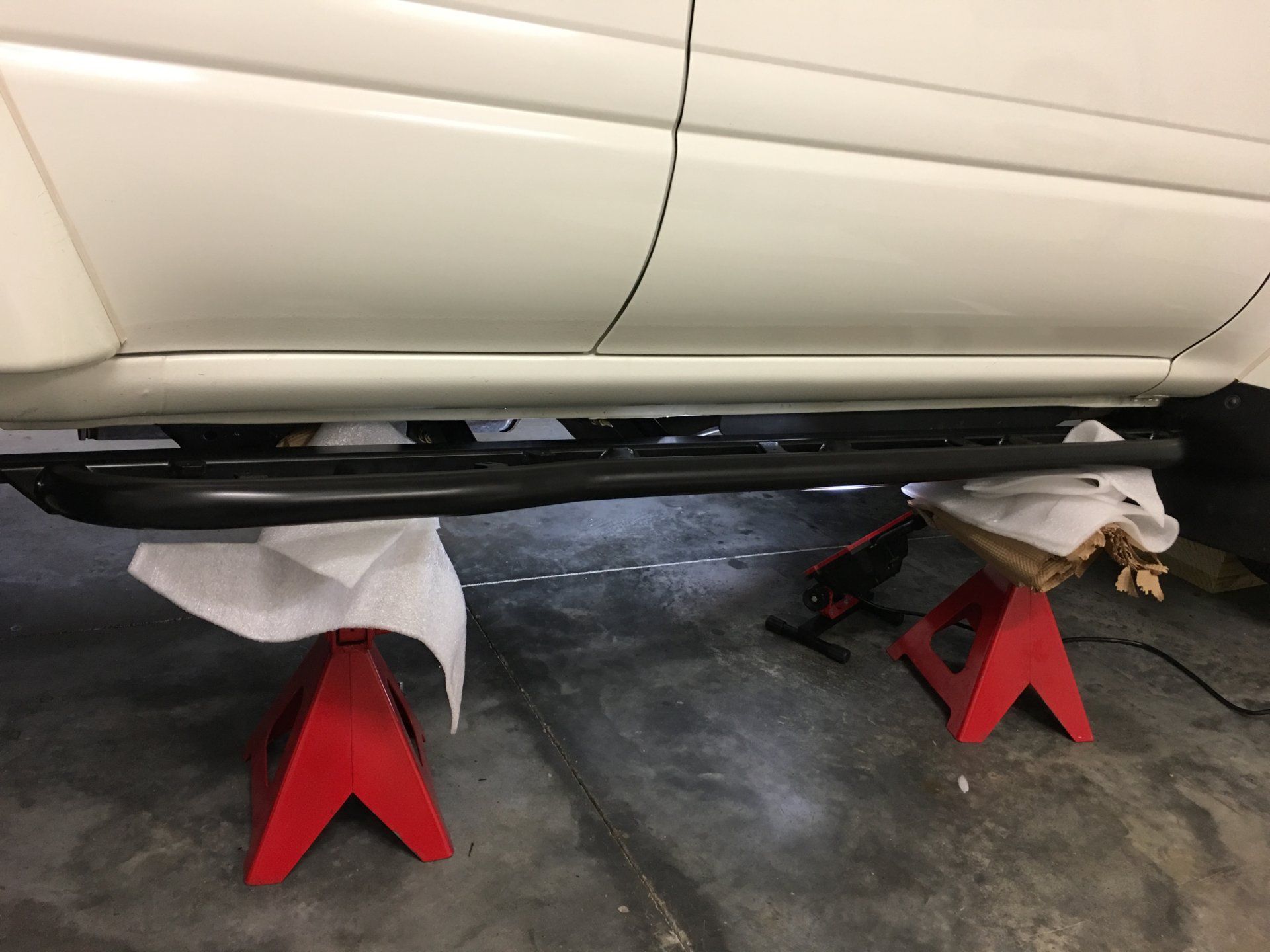

Greetings. 1995 FZJ80. Finally found some time for my White Knuckle Slider install.
Remarkably smooth so far. Decided to do the passenger side first, as working around the catalytic converters is a little tricky.
I’m really impressed with the precision of the design. They line up perfectly to the frame. Has worked out real well so far.
Be prepared for a bit of wrestling with these things. They’re heavy! Definitely jack the truck up a bit and make good use of jack stands. Also, all the packing material they ship these with helps as cushioning.

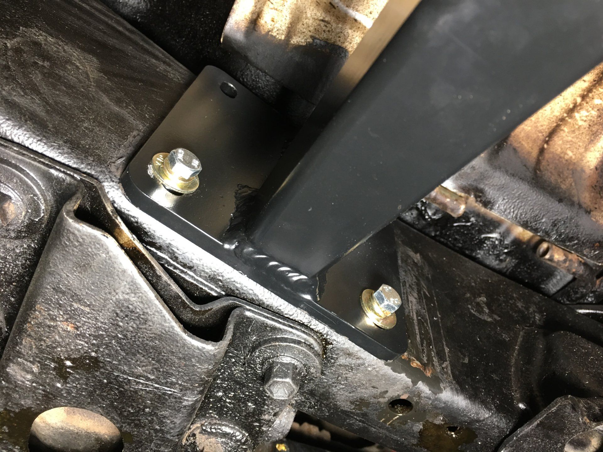

I took some time to clean out the four factory capture nuts near the catalytic converters. These are important for the passenger side install. Cleaning these out made everything go pretty smooth. One bolt to go...taking a short break to post.
I’ve read great things about these sliders. Very impressed so far!

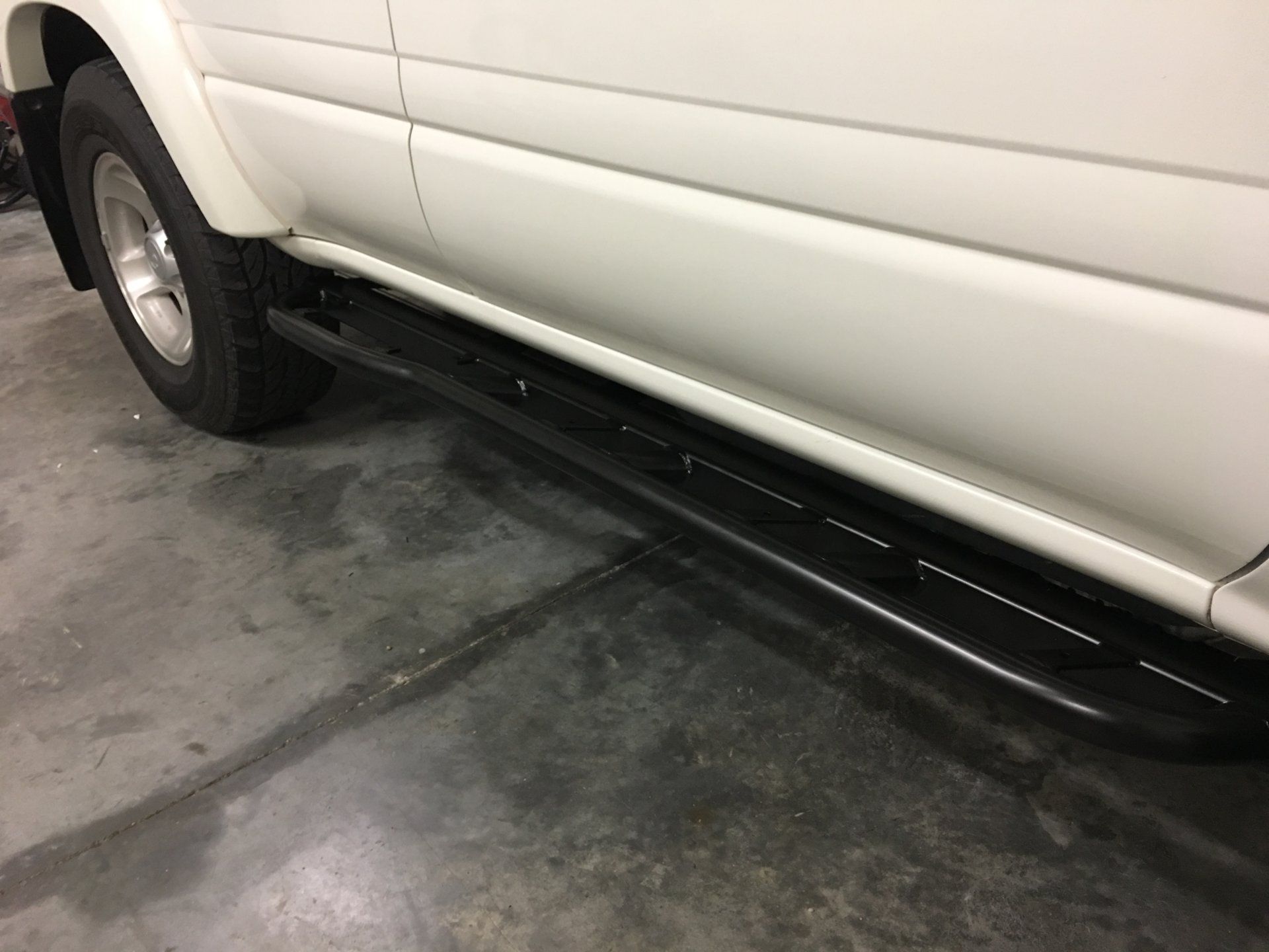

The finish looks great , did you order them powder coated or did you paint them ? I like that you got the full top diamond plate option.
Enjoy the brake line relocation. All the write-ups I read were discussing how the pass side was more difficult with the cats. That one went on in ~10 mins. Moving the brake line took forever for me.
Thanks! I ordered all the options - the stronger material, the powder coat and the diamond plate. I’ll post some photos once they’re all done.
When camping I put a good amount of gear up top, so these will probably be used more as steps for better roof access than as sliders, but it’s great knowing the protection is there. That’s why I opted for the diamond plate and slightly different tube angle - White Knuckle can accommodate that.

I’m also guessing it’s harder to line up the driver side, as there are no frame capture nuts like on the passenger side - which really made alignment easy.

I installed mine a couple weeks ago on my 94. The upper bolts by the CAT were a real PITA but the guys at White Knuckle warned me when I picked them up. The overall fit and finish on the product is fantastic though
