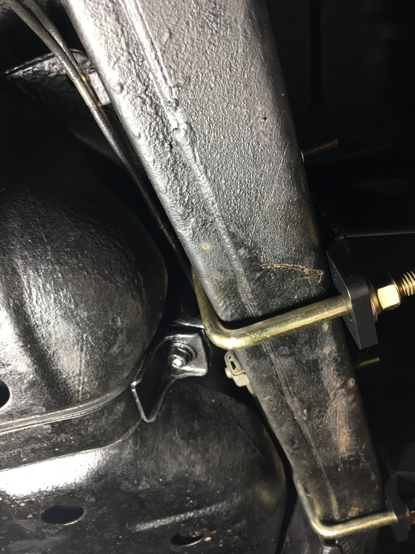

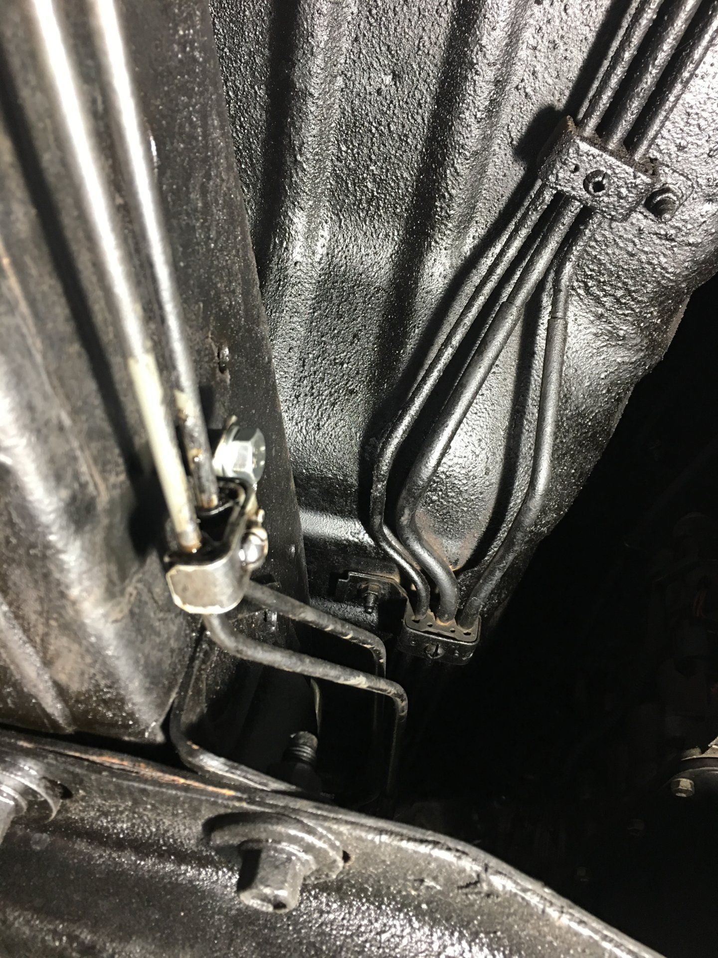

No lets see how the spacer install goes. Pull the lines down, then pull the top of the clip towards you and get the spacer behind, put the bolt in and then do your best to push it back up to the hole in the frame. This was easier to do with the front lines not tied down yet.
Gotta kid related event to head off to now. Will check back in and expect to see completed pics. Make sure to check the brake line clearances before you start bolting up the slider. The rear line pretty much determines where the slider needs to be placed so it doesn't rub.

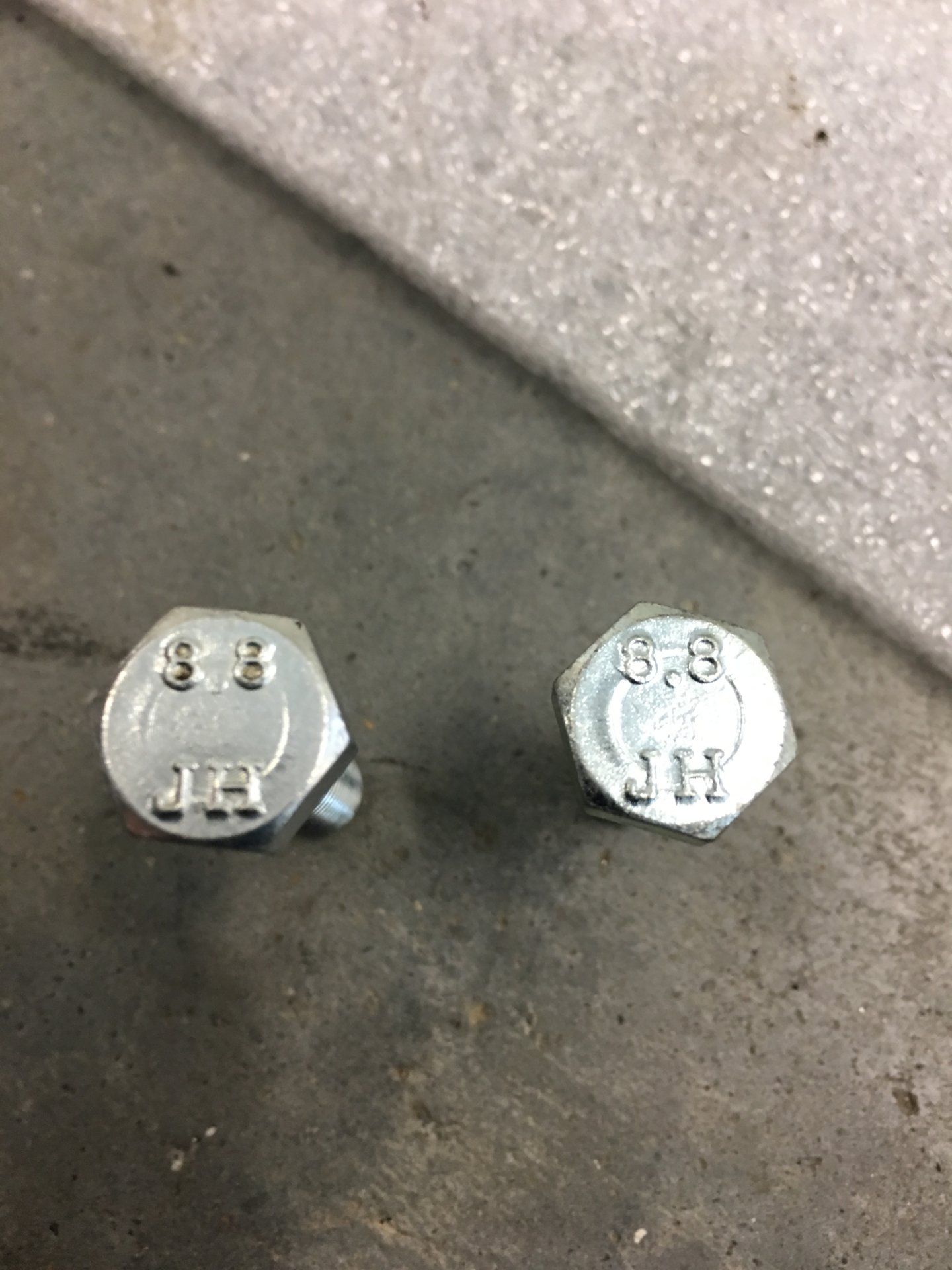

Required a quick trip to Ace to get an ever so slightly shorter bolt for that brake line bracket next to the fuel tank.
Extremely limited space to work in there. I wouldn’t bother trying to make the supplied bolt fit that bracket - just get one a few millimeters shorter and it drops right in...with the supplied spacer.
The supplied bolt is on the left...the replacement on the right...apologies for not noting the exact length...

Took a bit longer than planned fighting the brake line, but altogether I’m guessing it was about a three hour job for me...working slow.

Enjoy the brake line relocation. All the write-ups I read were discussing how the pass side was more difficult with the cats. That one went on in ~10 mins. Moving the brake line took forever for me.
