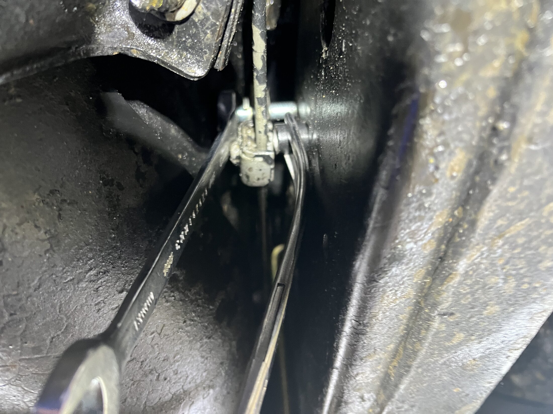

I have an offset spanner with a 12mm on one end and a 13mm on the other end. It was perfect for the brake line bolts. Made that piece of the job a non-event.

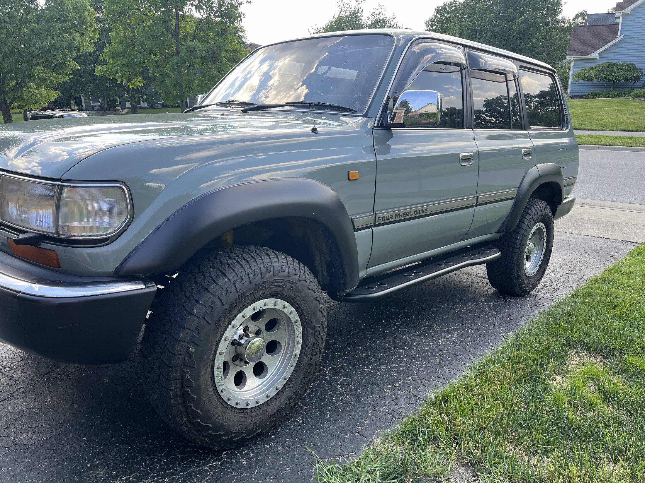

I got the WKOR sliders mounted up on my HDJ81. The drivers side (RHD) was fairly straightforward, an exhaust hanger gave me some trouble but other than that, no big issues. The passenger side was a bit more of an effort. The brake line mount right next to the fuel tank was a complete PITA. Copious amounts of bad language ensued. The space was tiny and the bolt, lock washer and spacer were very fiddly. I tried some hemostats, nope. After about 45 mins, I managed to get my fingers up in the space and got the bolt started. Finished it off with a ratcheting wrench and breathed a sigh. WKOR sliders are beefy and am interested to see if the mounting system holds up to a few light to heavy slams by rocks. Very pleased with the rock sliders construction.
No rattles or pops after a nice test drive. The truck definitely handles differently. The rock sliders must add at least 60-70lbs a piece.
