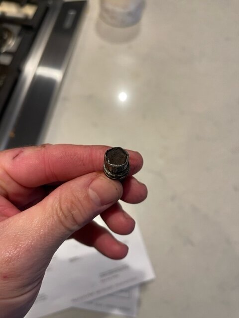

After lots of fiddling, PB Blaster, channel locks, cussing...... Finally got that bolt out. Think I should reuse it?? LOL...
:bounce::bounce2::bounce::bounce2::bounce::bounce2::clap::clap:
And there was much rejoicing.
Not much to add, but that baby scratch on your index finger doesn’t support your reported battle with this bolt.
.....my kinda guy right there, classic reply, love it !!!!!!!
