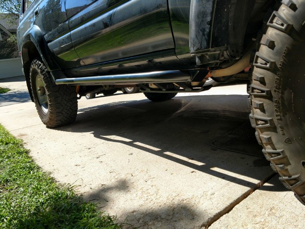

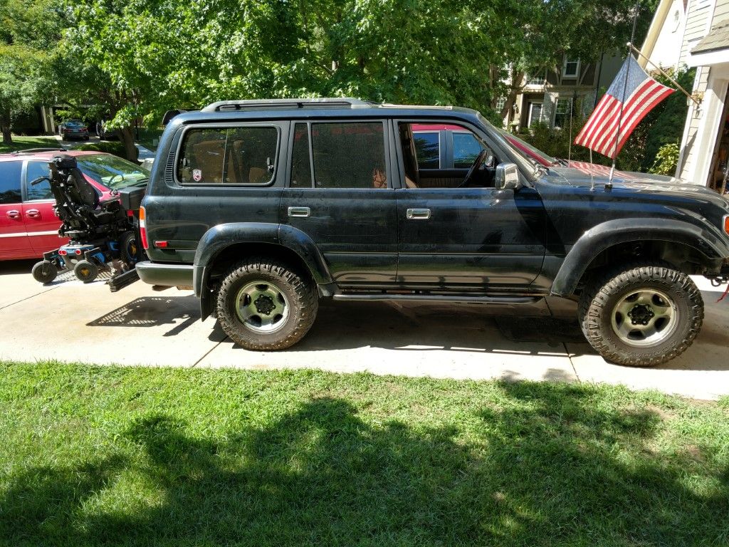

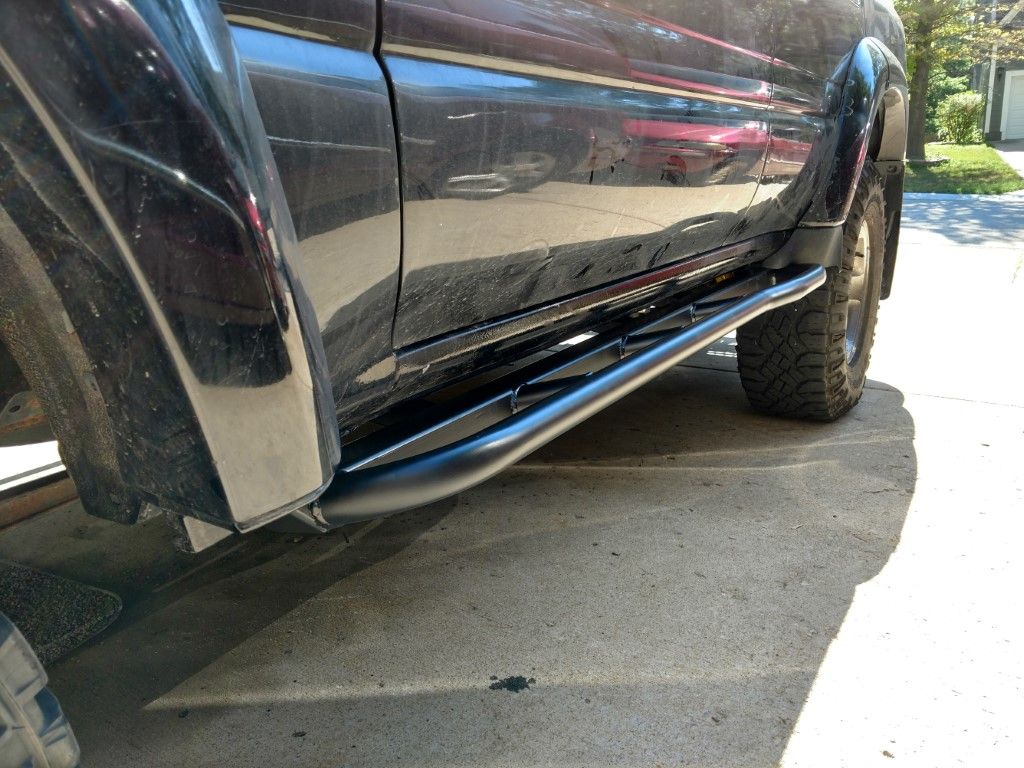

White Knuckle Off Road sliders installed over the weekend on my '92 HDJ81. I ended up buying the non-powdercoated version and painting with Rustoleum. Used two cans of black primer, and one can of truck bed liner on the tops of the sliders for some grip.

Nice shot. Are these the 10 or 20 degree sliders?
Hey there @toyofan
@Cass007 is exactly right. You can customize the angle. I decided for a larger angle with the diamond plate to bolt on top because I use the sliders for protection and for easier access to the roof.

Meaning these are 20 degrees?
These are the 10° sliders from WKOR. They are "flatter" than the typical 20° sliders.
One nice thing is I can easily get my hand between them and the body to wash the body. The 20° units fit much tighter.

Okay, yeah, this looks good. 20 seems too high and tight for a ladystep. What kind of wheeling do you do, and have you ever been thumped by something the 20's would have stopped? Thanks!
I don't wheel much. The one time I did right after I installed them, I set the truck down on them and they are solid. I got the heavy wall one because I also wanted them for side protection from other drivers.
They clear the curbs at the mall very well. They also prevent door dings from the beatches at the mall.
This is my DD (20K/yr) and I have it for protection and for a step. My son has CP and we needed something for steps for him to get in. The 20' are too steep for laying a foot on them.
If your S.O. has small feet, you can also get the grate for the top so her foot doesn't slide through. Kids are flexible and limber enough, it's not an issue.
I have not done anything to tip the truck onto these, but I know there are others here that have had that happen and these saved the truck from tipping over. I don't risk my DD and I'm old enough to know better.

Put on some white knuckle sliders today. Went with the DOM at 10 degrees with diamond plate to replace the runners. Perfect fit and these things are stout as heck- very happy with WKOR.
They’re heavy and awkward to move into position. I had 3 guys helping/drinking beer which I’d recommend. Lot of standing around for them but when you’re down there starting the u-bolts it’s helpful to know you’re for sure not getting your skull crushed.

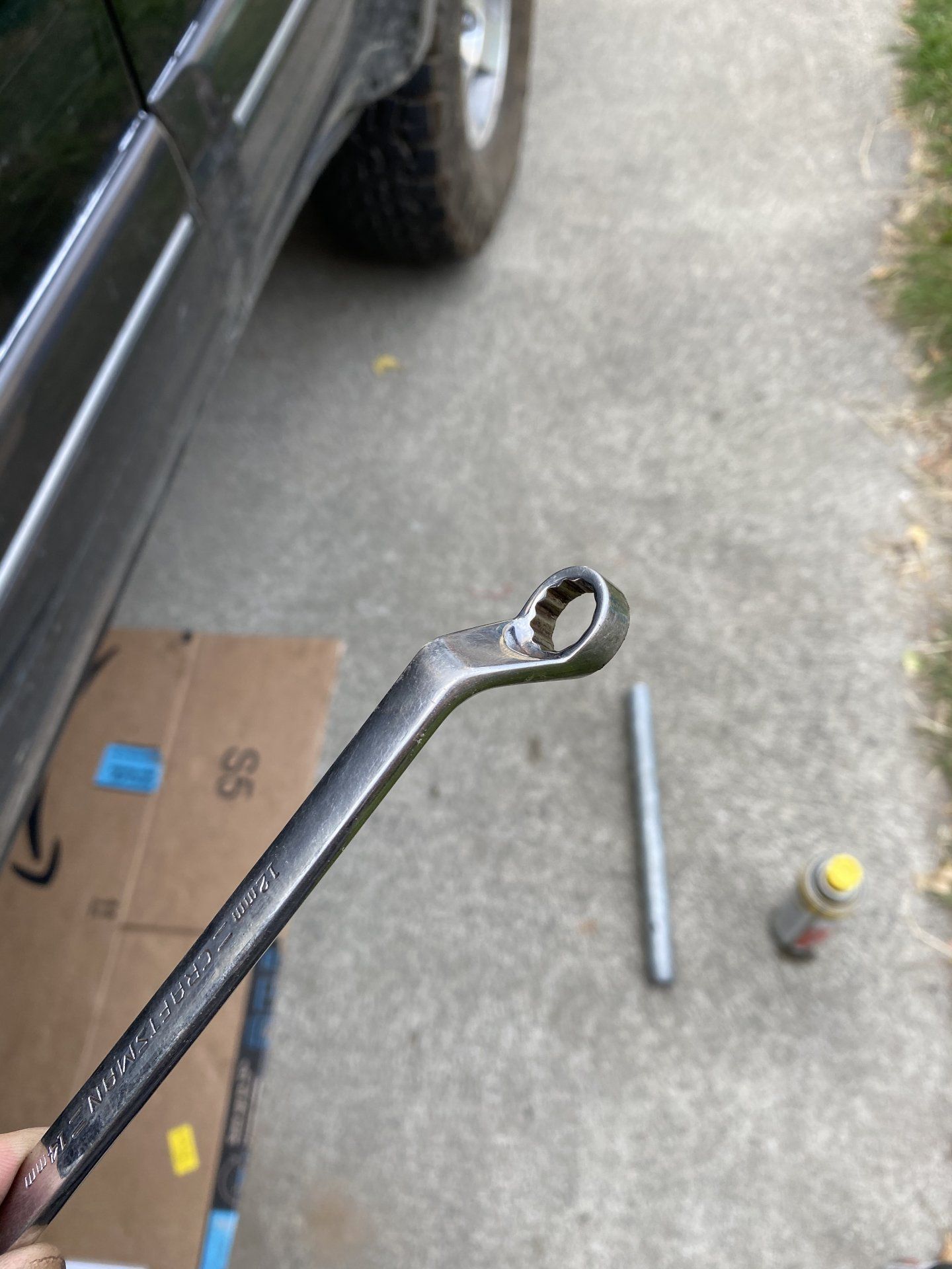

FYI, this wrench really helped with the rear bolt of the brake line relocation on the HDJ81. I’m assuming it’s nestled next to the fuel tank on the US 80’s as well.
for real. i struggled for too long with my regular box and open end wrenches before giving up. ordered from the usual scumbag a full set of Tekton 45deg offset box end wrenches and got that bolt out in seconds.

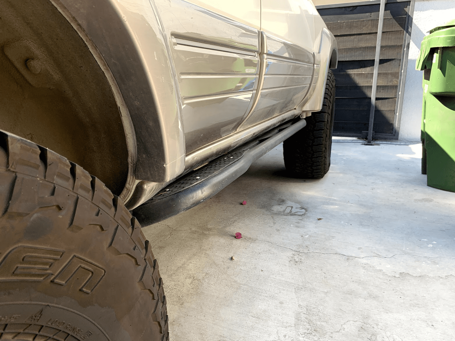

The 20 degree non-paneled def the best looking sliders I’ve seen for the 80 practicality be damned. Funny how life works.
