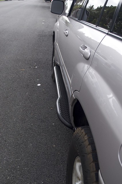

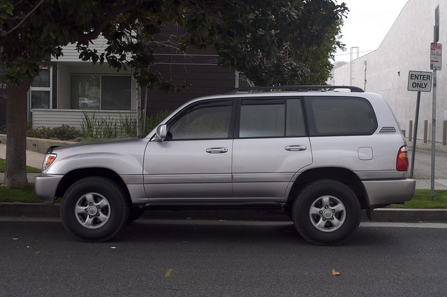

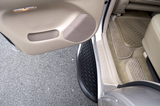

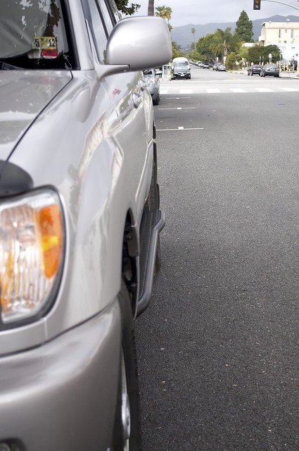

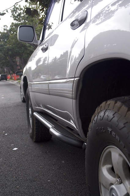

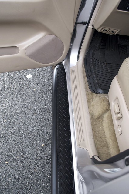

Got the gen 2 WKOR Sliders with diamond plated step installed. DOM tubing and powder-coated. I know some of you guys wanted to see what they'd look like on a 100.
Rugged elegance at its best! Nice choice on the diamond plate!
