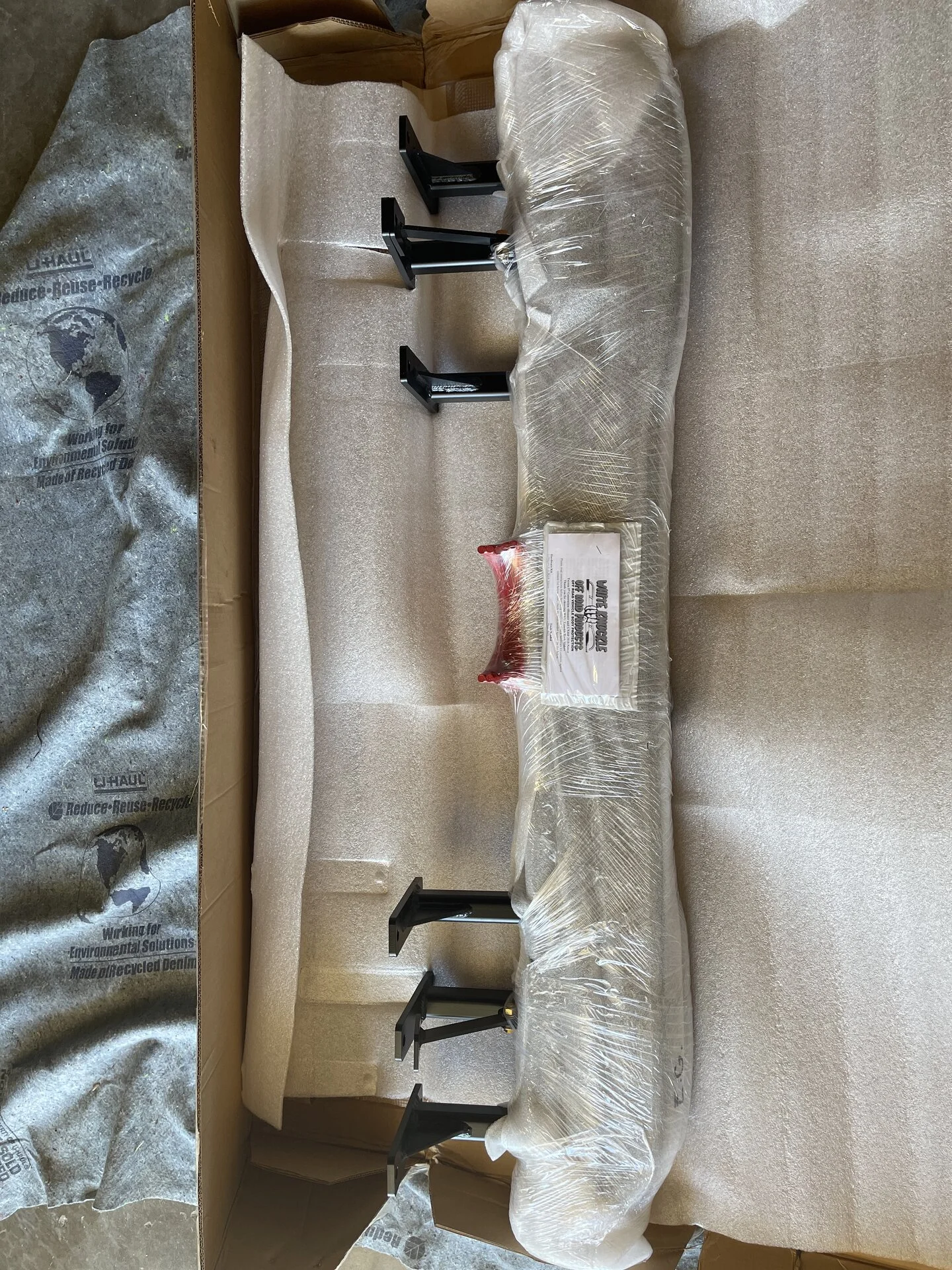

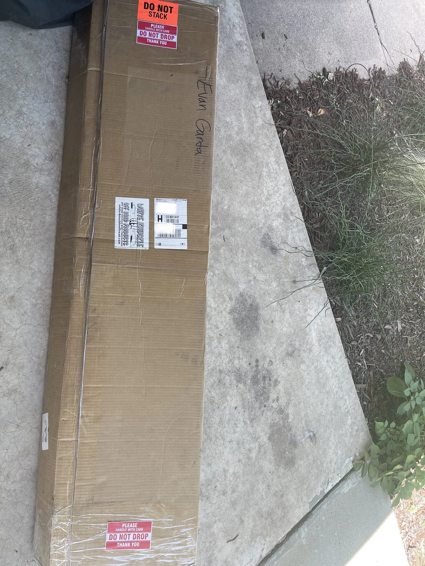

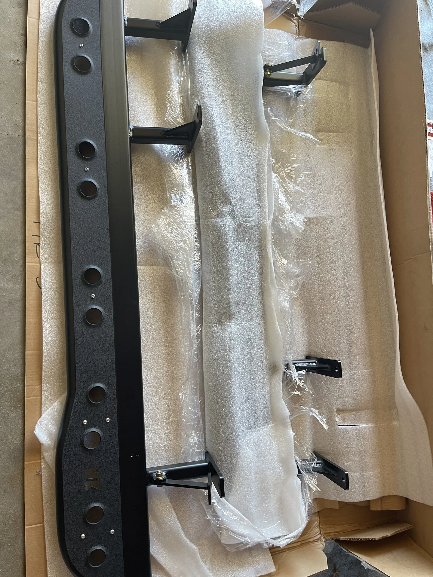

My @white-knuckleoffroad sliders arrived today! Total turnaround time was about 4 weeks for completely custom fabrication. Very impressed with the shipping, powder coat, and overall quality build of these. I can’t speak more highly of the customer service (Chyree was great!) be it via phone or email- I always received a timely response and had my calls answered.
I went with the 11* version with full top plates to help minimize rock chips and provide a minimal step for my wife.
Instructions seem…sparse. Will follow up after install.

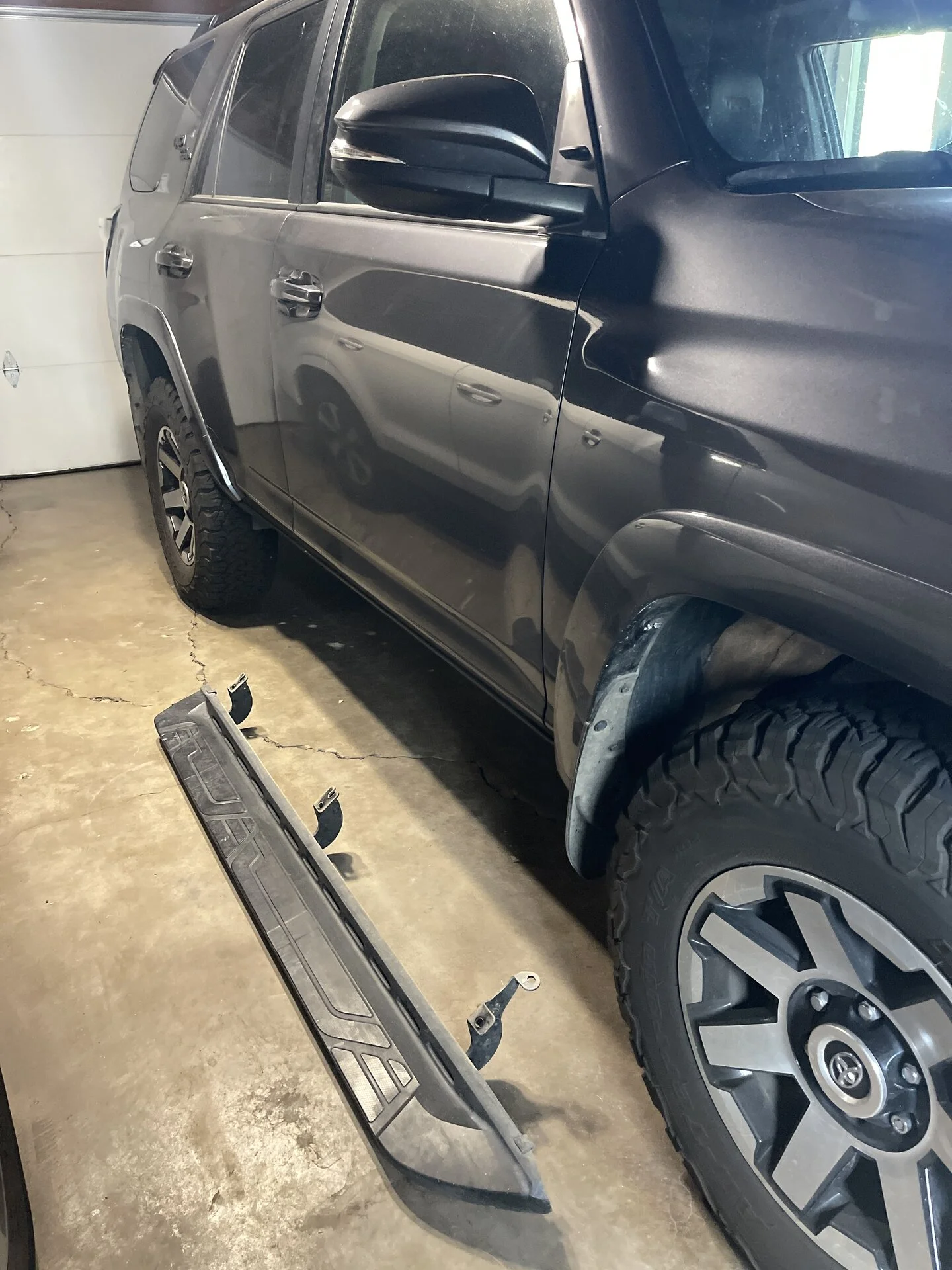

Factory Trail Running Boards removed in about 8mins. For sale - local pickup in Denver. Name your price.

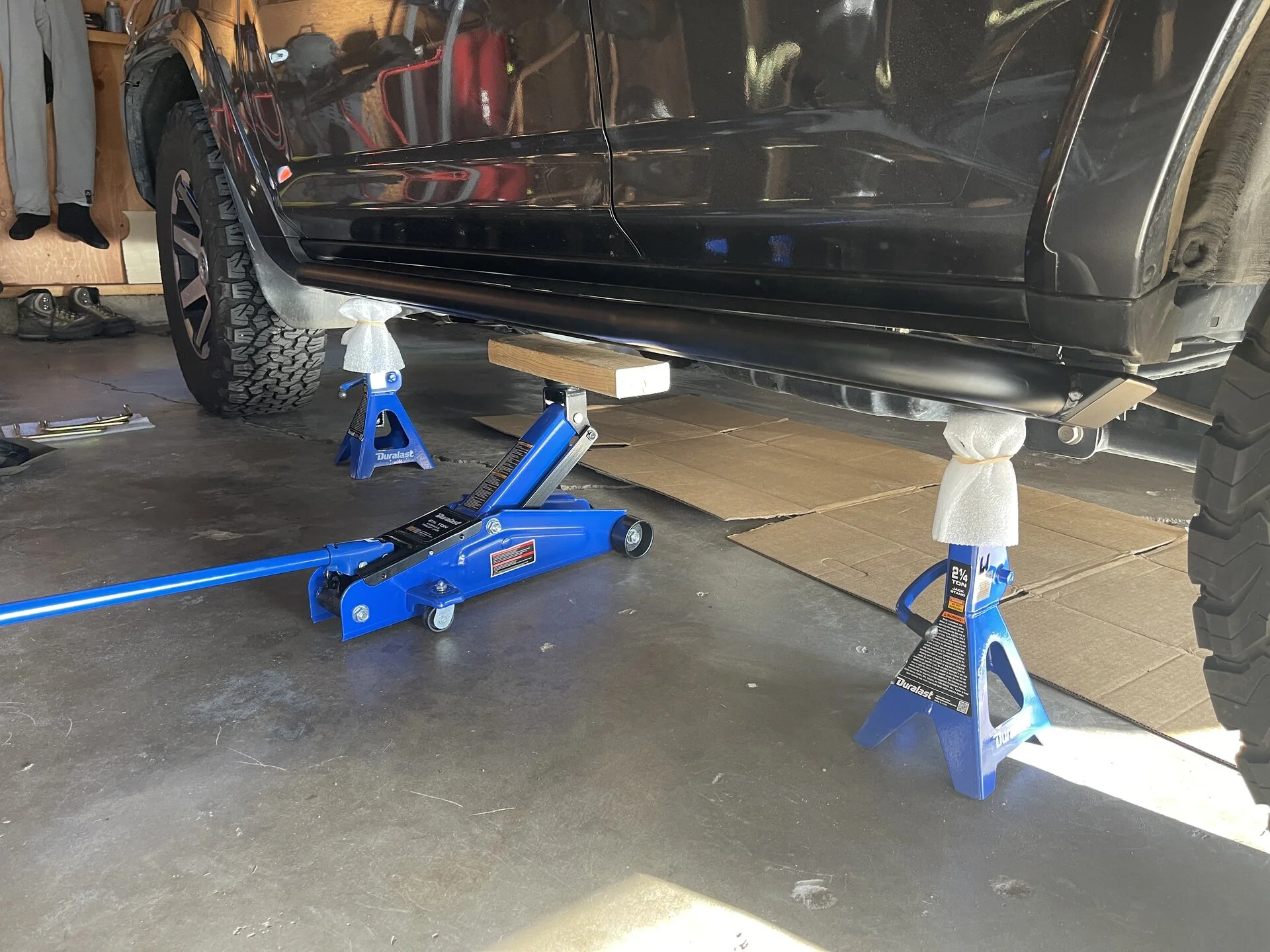

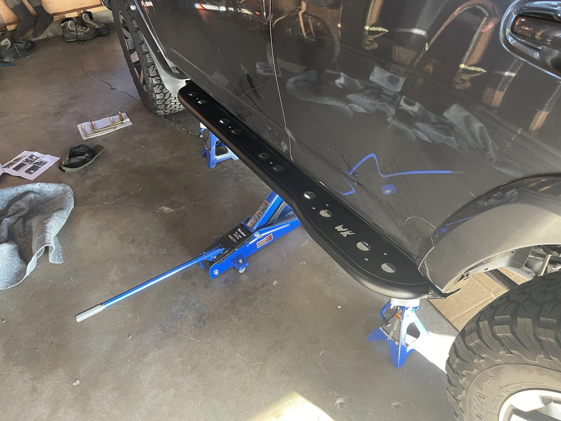

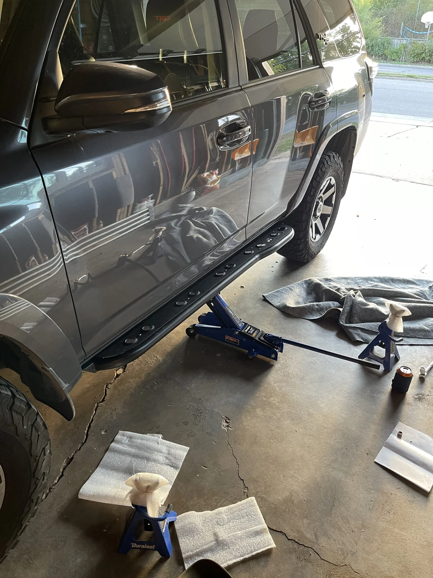

All in all, a fairly straightforward 4-beer install: 3 beers driver side (1.5hr) and 1 beer for passenger side (30mins) with a big learning curve. The U-bolts can be a little tricky to thread in the front but once you figure it out it’s smooth sailing.
Can’t speak more highly of these sliders and my overall experience with @white-knuckleoffroad.

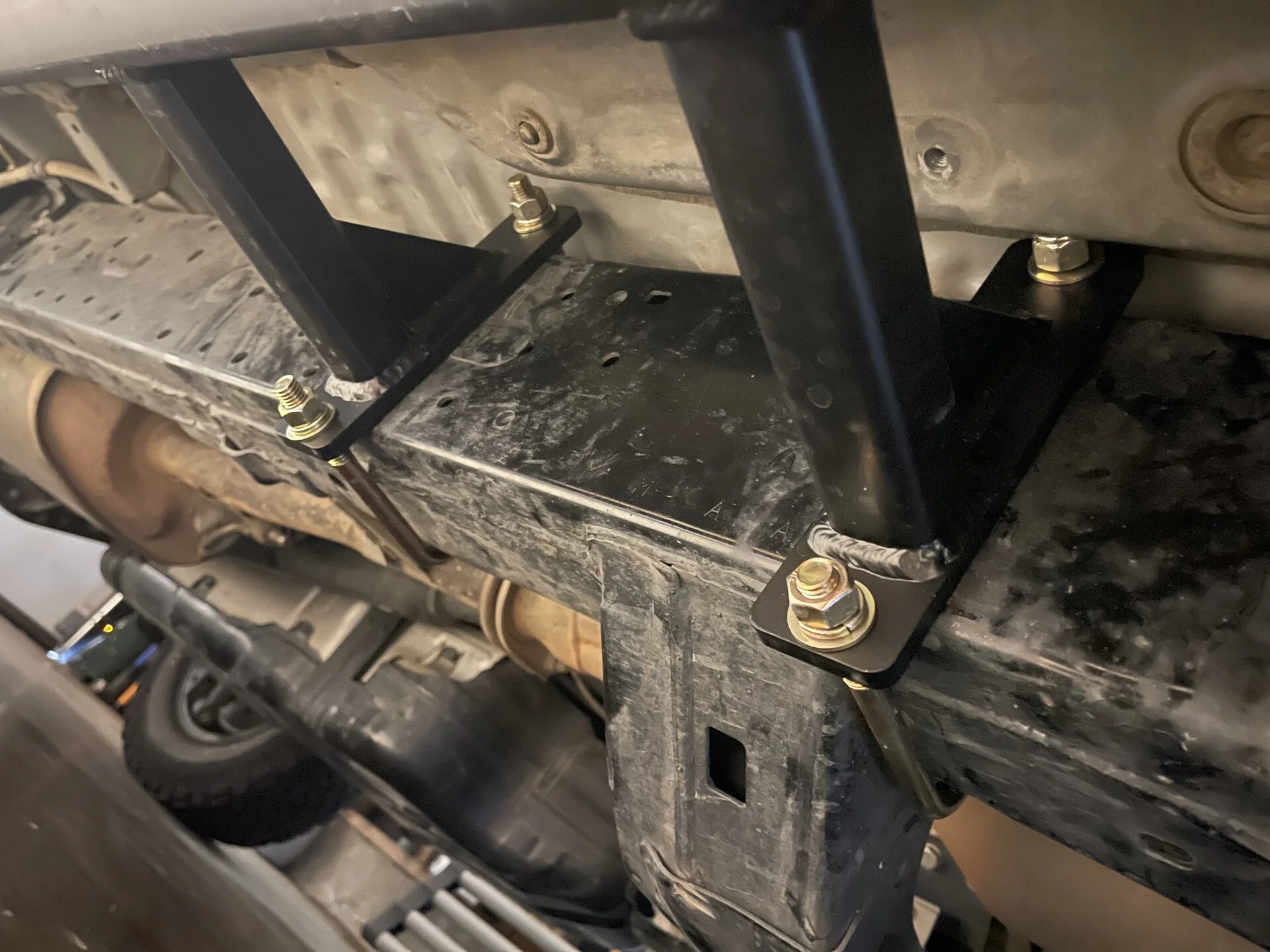

Without being an engineer, it seems as though each leg of the U-bolt would effectively provide the same support as 2 bolts being bolted directly to the frame though I’m not sure if shear strength comes into play.
Front and middle passenger (frame width tapers outwards towards the front hence less exposed threads):

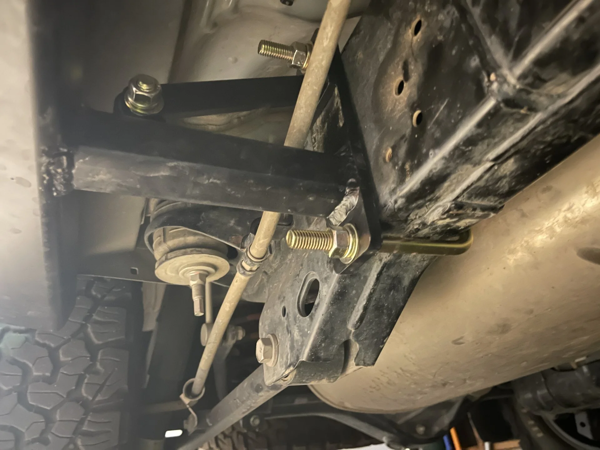

Rear passenger with an angled support arm:
You guys may be right. I'm not an engineer either but I personally would just stick with the simple and proven bulletproof method.
Thanks for the pictures. I learned something new today.

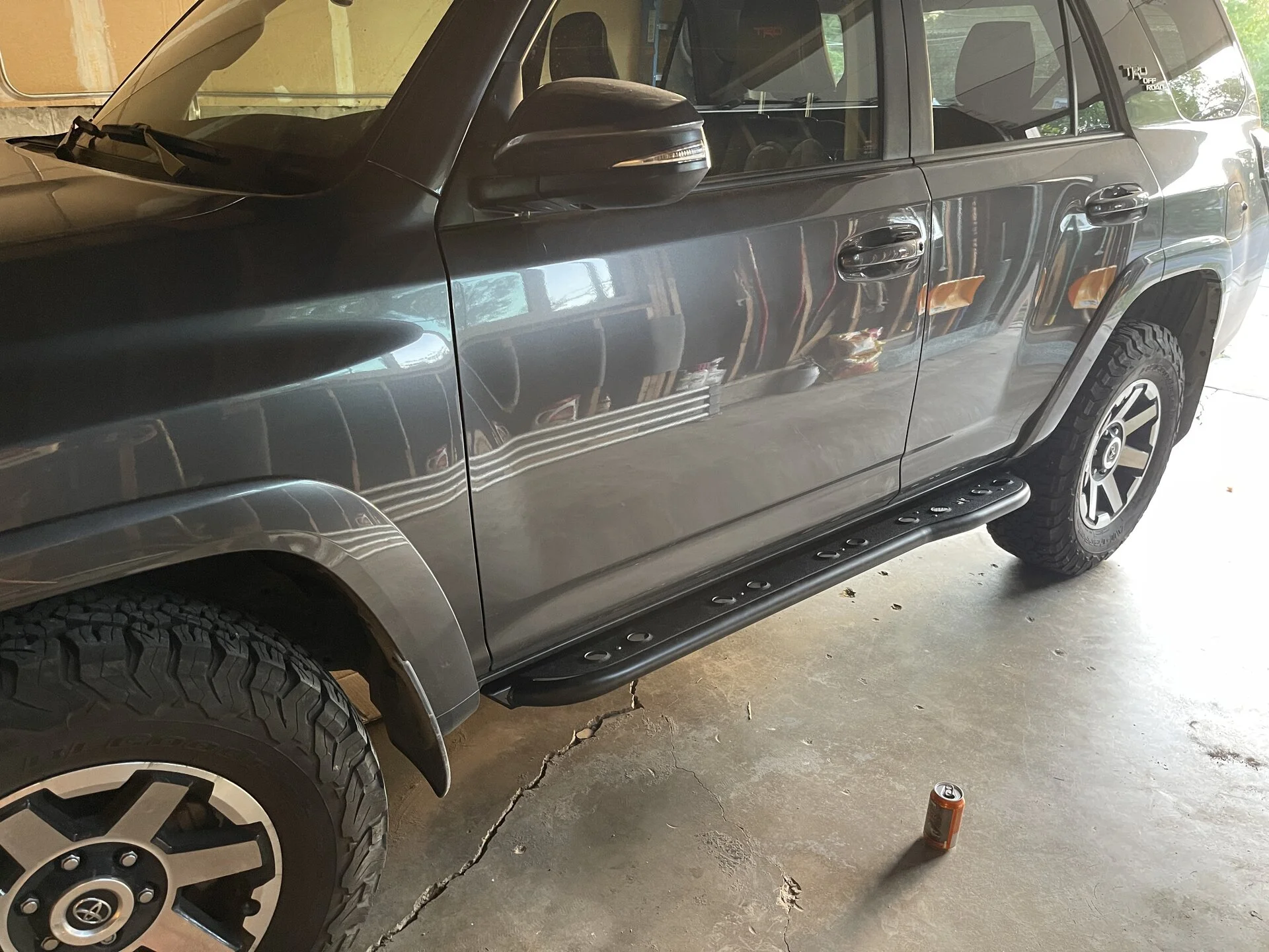

Mounting wise, I was a bit skeptical at first but I have bashed my Cruiser sliders a bit and used my Hi Lift on them to raise the vehicle. So far no issues on a 6800 pound vehicle.
