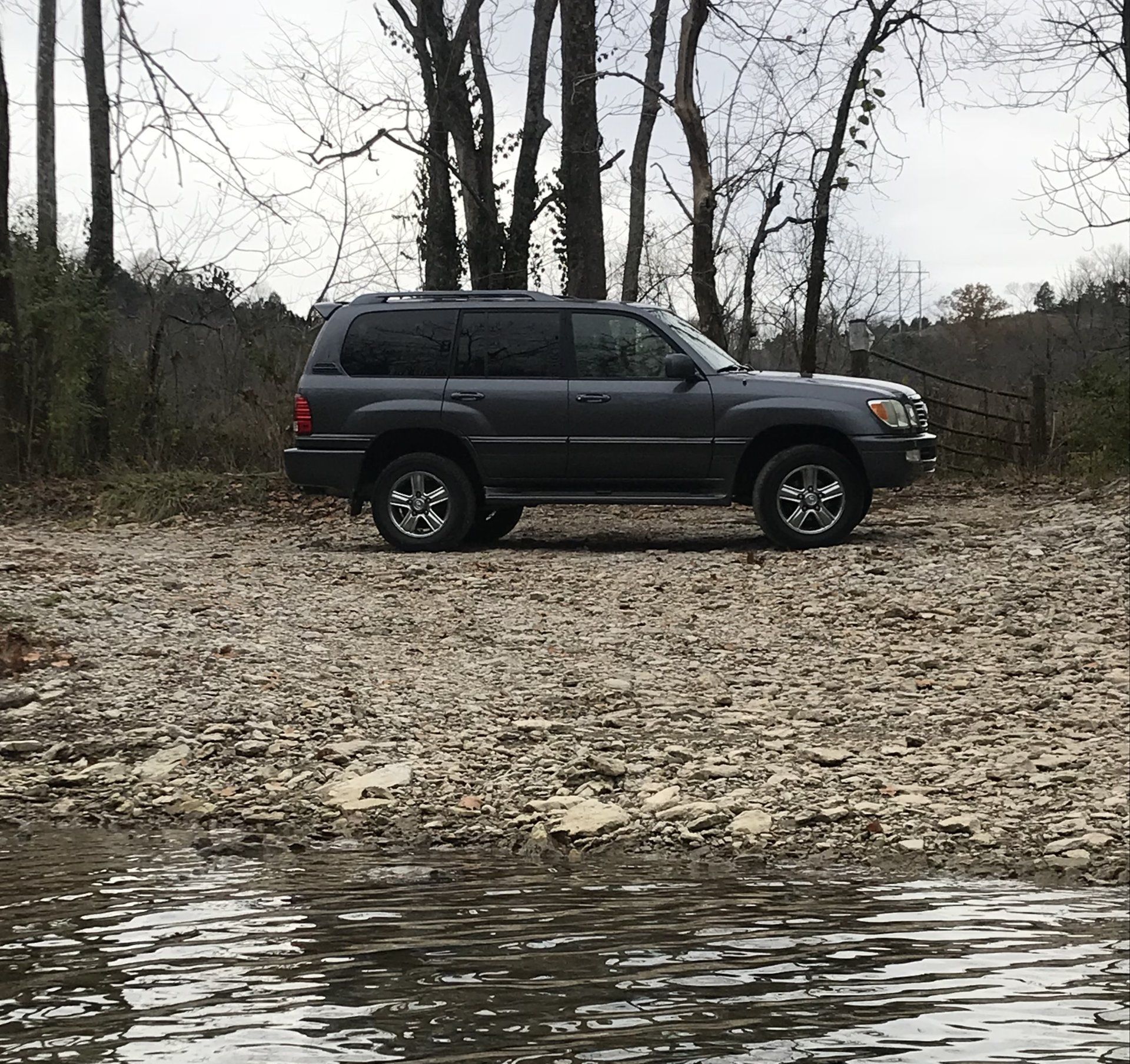

Thanks for the replys so far some great looking rigs and sound advice. I will be using factory wheels. This is how it looks right now.
