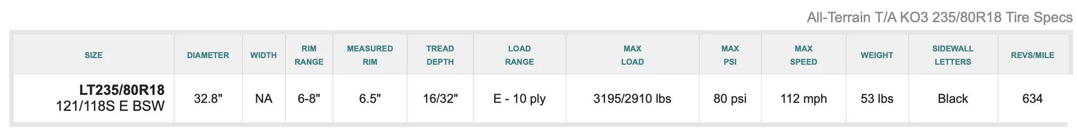

235/80R18
The KO3 still in E load, 32.8" no width listed, but can't imagine it's wider than 10"

BFG K03

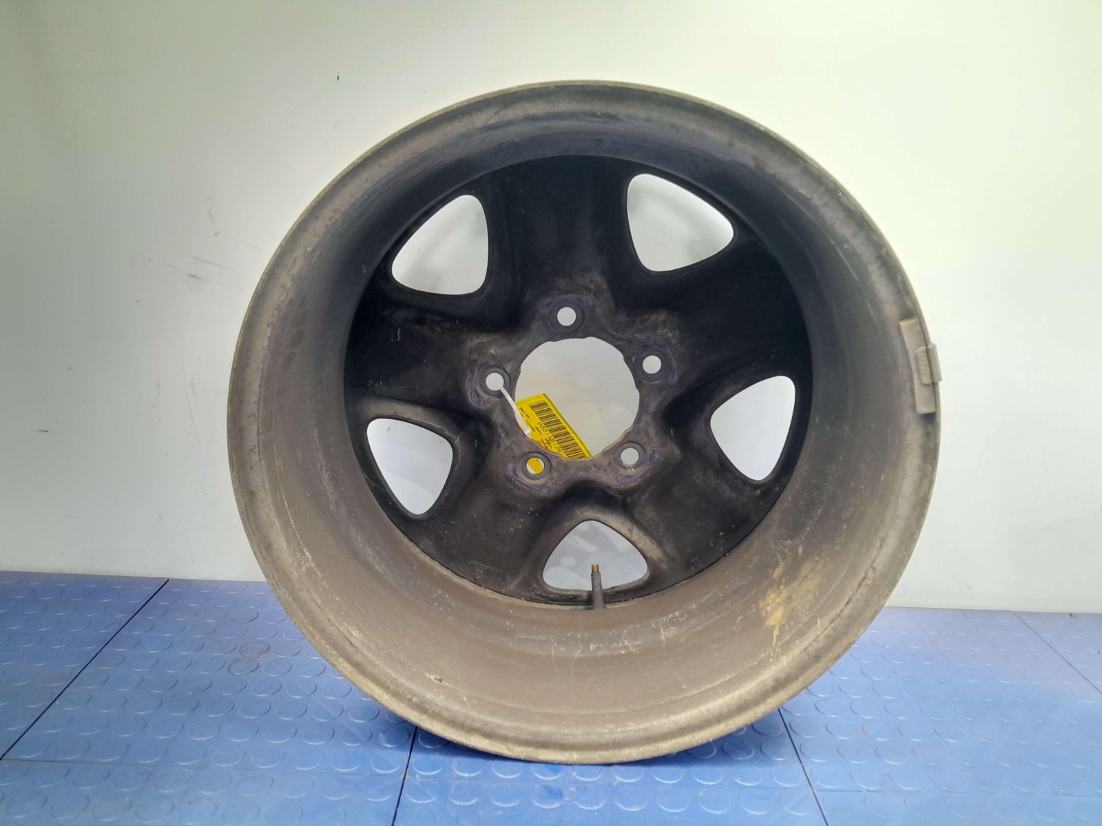

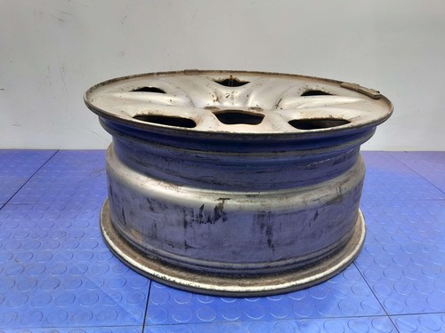

And then just looking at 18x8 Tundra steel wheels. The barrel is quite flat (vs cone shaped) and therefore could easily be narrowed to 18x6. Would also make a great skinny spare. Gain 2" of ground clearance in the stock location!
07-21 Toyota Tundra 18x8 Steel Wheel - 5 Holes Painted Silver OEM 426010C041 - Picture 2 of 3
