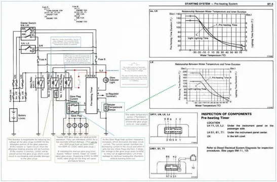

I have a Pre Heat Timer 28521-68040. Which I believe is a Super Glow, can anyone confirm this? If it is super glow am I correct in thinking that the right glow plugs are 19850-68050 (51)? This is all going to be running on a 2H.
Thanks
Joe G
Thanks
Joe G
Hi Joe,
If your Timer looks like this,
Then YES it's a super glow timer, preheating for 2H engines used in HJ60 and HJ75
And YES you have the right 6V glow plugs.
Rudi
The 12V in your pic means 12V system.
Your glow plugs are 6V due to the timer, current sensor and resistor combination.
I've send you an email with this pic in its original format. This forum downsizes this pic so it's almost unreadable.
If somebody is interested.... you can download it here: -► https://docs.google.com/file/d/0BwGk8zcL34N4TGVzVnlBMU9yQ1E/edit?usp=sharing
