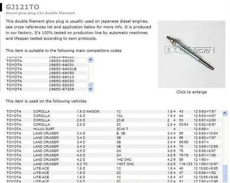

I feel the need to add a bit more about the plugs I suggested in my last post...................
Those GJ121TO are said to be "12V plugs" (rather than 8.5V or 10.5V for example) because the Italian manufacturer (E-TECNO 1) reckons they are the replacement for a whole range of OEM plugs (and not just those 8.5V and 10.5V plugs). So putting "the battery voltage" on the plug seems to be the sensible thing to do (and I understand that).
Apparently when you connect them straight to your 12V battery they get to the correct temperature for cranking (900 oC or whatever) in just 4 to 7 seconds.
And Authorities in Europe are apparently forcing car manufacturers to provide "after-glow" in order to restrict "diesel engine start-up pollution". So these plugs are designed to withstand being left connected to your battery for up to 180 seconds to safely provide this afterglow. (And the word safely still apparently applies with 14V busbar voltages which are achievable with your alternator running).
This type of thinking by a manufacturer helps explain to me why we get so much "cross-referencing confusion" in their catalogues.
The way I see it, to run those plugs in one of our 12V #B or #H -powered cruisers you'd have to:

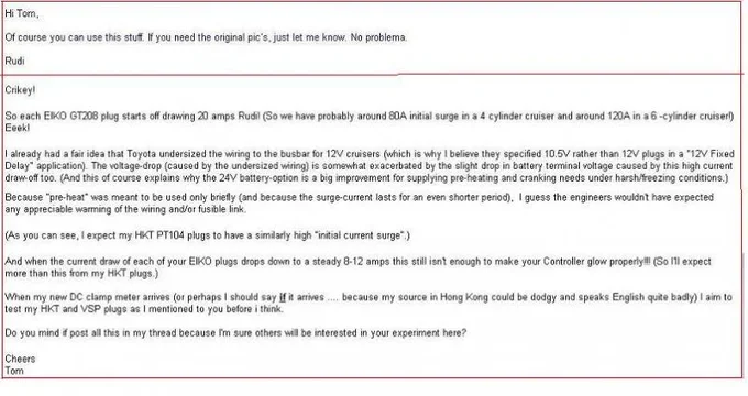

I needn't have worried. My new "DC clamp meter" arrived from Shanghai without a hitch. (Instructions are in Chinese but who needs them anyway?)
So here's a video I've just made of the performance of my HKT PT104 glow plugs in my 1979 12 volt BJ40 landcruiser:
YouTube - HKT-brand PT104 8.5Volt glow plugs
You will see that the initial current surge is over 100 amperes :eek: and it drops down to around 33 amperes in around 30 seconds.
And you will also see that the busbar voltage eventually rises to a voltage that perfectly matches my glow plug voltage-spec (as the Controller and plugs begin to glow brightly and as their resistances increase).
:beer:
PS. :hhmm: This makes me wonder why your EIKO GT208 plugs won't glow your controller Rudi. (Because 33A is considerable less than 4 x 10A .... But then I know the accuracy of your meter was more questionable than mine.)
