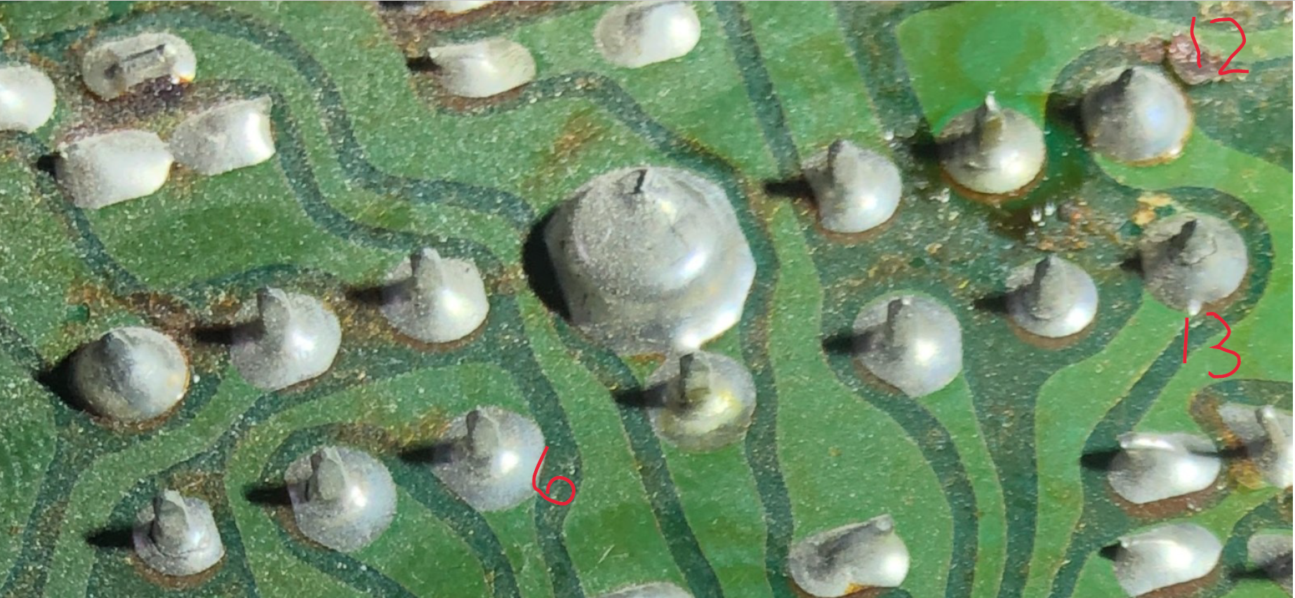

Emissions ECU pics:
Red arrows for possible cold joints - but they look fine. Reflow to be sure.
Reflowed potential areas and looking solid. Checked with continuity/meter.
Video with same results - dead end....
Did you reflow pin 13 of the connector? That is the VSS input to the computer. It should not impact your idle but it is a bad solder joint. The fuel cut solenoid is on pin 12 above it that looks pretty solid.

I’ll reflow 13 when I have the box out again . It’s super easy to work on these archaic computers….just fussy to figure out why.

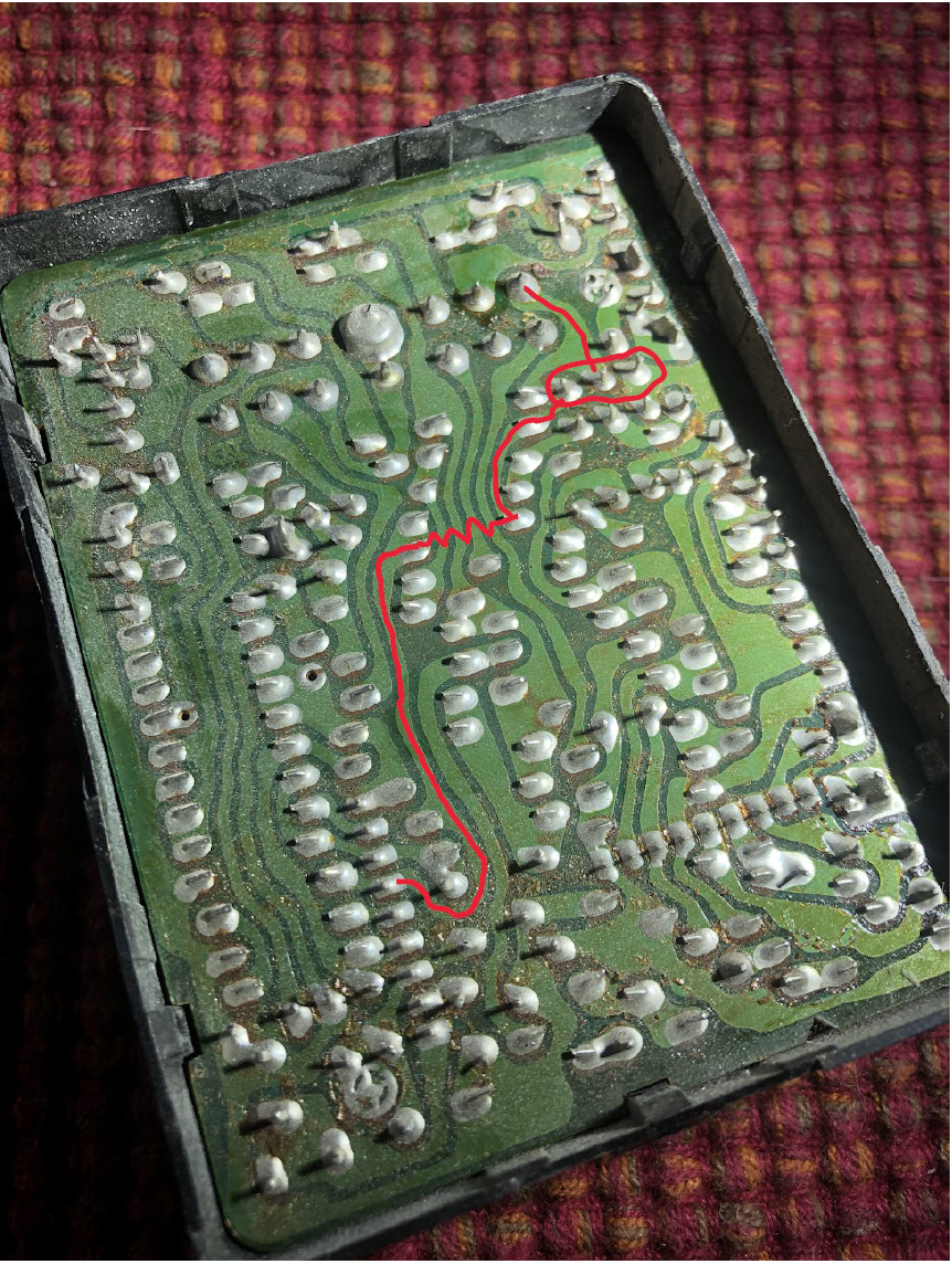

The transistor that controls the FCS is circled, it is turned on/off depending on the status of pin 6 of the 2582 IC. That all looks pretty solid.

Testing FCS function of 81+ emissions computer.
