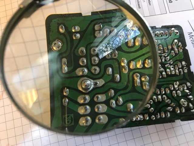

Sometime back I had random stalling without any warning. The rig would run fine then stall with excessive cranking. My rig is an 82 completely stock and smogged. What I did find was wiggling the wires at the connection where they enter the emissions computer. You probably know this little box is located on the inside drivers side firewall. I could never duplicate the stalling but manipulating the wires would result in firing up again.
Like you I keep my 40 well maintained and tuned so I leaned towards an electrical issue.
I pulled the emission computer and carefully opened the box exposing the circuit board. I found at least three cold solder joints (opposite side of connector ). I resoldered all suspicious cold joints and my problem had been solved for years now. Get under there and remove the box and check it out. Others have reported similar. Cold solder joints are intermittent at best but once you re-solder them the problem resolves. I had a similar issue with my 2000 1500 Silverado. I chased a parasitic drain for months until I isolated it to the ABS module/valving under the driver along the frame rail. I found cold solder joints and fix them. Gone is the draining and saved close to $700.

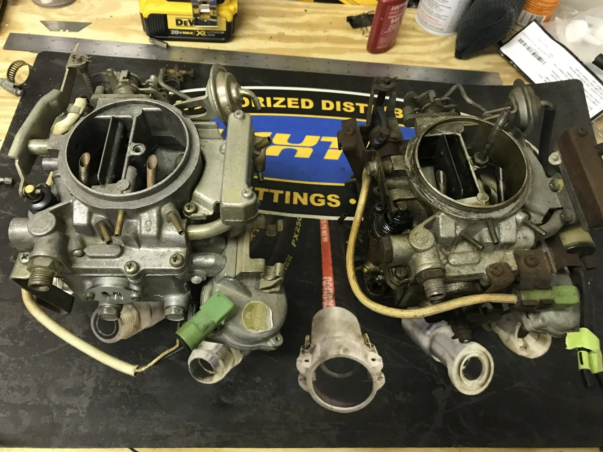

Check the fuel cut idle solenoid. You should hear a noticeable click when turning on your ignition.
@OPMACHINE ill do that soon…not sure if I ever heard a click before just with normal start up. Is there a way to check with multimeter as well. I’ll check to make sure 12v is getting to it as well.
You should hear the click when you turn the ignition On before engine start.
Make sure you are getting 12V at the fuel cut idle solenoid. On my 1979 it is the green plug on the carburetor. (White+/black-). The solenoid is grounded thru the emission control module under dash. A common failure is the solder on the back of the board. The solder points fail and the ECM and does not ground the fuel cut solenoid.
The fix is to reflow the solder on the ECM board or just ground the fuel solenoid at the carb.
I've seen the solenoid plunger broken off inside the carb; solenoid had voltage, clicked with key, passage never opened... you'll find it; whatever it is. Likey a vacuum leak, provided the idle passage is opening.

The 81+ emission computer is ultra reliable. I have never found one failed completely. That one shown above with broken solder joints is not an 81+. I have seen those with broken solder connections on the connector on the 79/80 boxes. It is easy enough to look at but I don't think that is your problem.
Thanks all for the amazing suggestions! Ill get into it today to see. For the life of me…if I were to replace that Solenoid, how the hell do you unscrew it from such a hidden/tight space on the back (if it is the back) of that carb!? I assume with the entire air filter housing off, you may have more room for a wrench etc. I see now they use square plugs, but looks like you can retro fit the original plug with some minor work.
