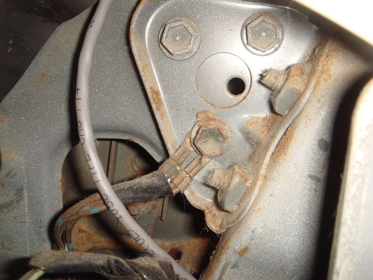

I don't know about the 62, but on the 60 you need to put your head on the drivers floor and look up with a flashlight to see the group of wires in a ring terminal bolted to the A pillar. On the 60, the passenger side is much easier to see and access. Same deal. Try looking for it on the passenger side first. Then when you see it and know what you're looking for, take a peek at the driver's side.
On the 60, they look like this. The 62 may be similar. Just guessing about that though.
Driver's side A pillar (FJ60)
Passenger side A pillar (FJ60)

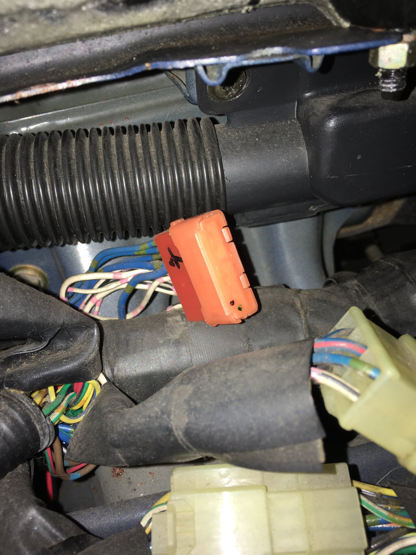

The one behind the dash is behind the gauge cluster. It’s like a 6-8 pin terminal that is capped and taped to the main harness. It looks like an orphaned connector since nothing is plugged into it, but it’s actually a ground junction for a bunch of wires.

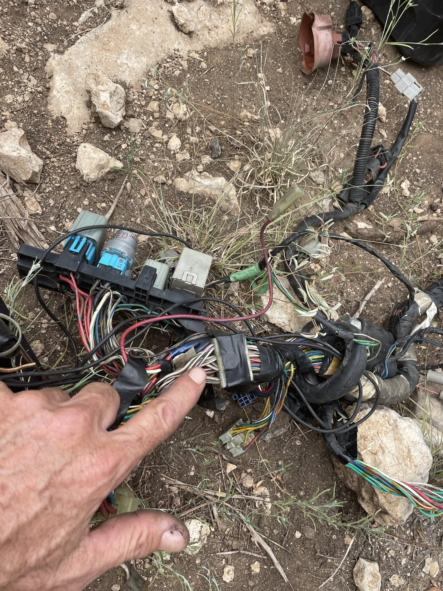

Found a pic when I took my dash apart. :)

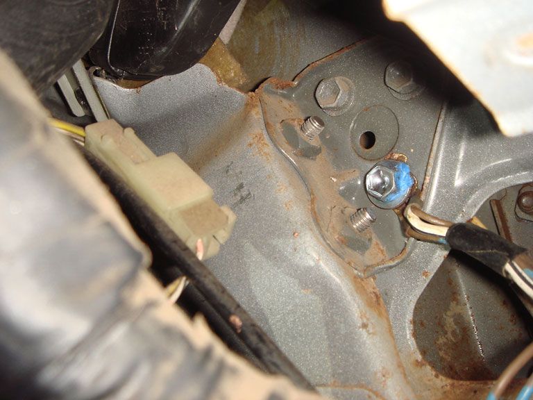

Cruiser Trash shared this on another thread. I'm adding it here as this is where Google lands you when search for these grounds.
Please be aware that this image is from a 1982 Fj60, and is no promise for later models. Be aware that for the triangualr brackets, you are not looking up at them from the bottom so much as out as they are parallel to the outside skin of the truck. The triangle bracket appears to stiffen the connection at the bottom of the a pillar.
CruiserTrash:
Start from the backside of the choke knob as a reference. No look towards the front of the truck a few inches. Now look as far as you can towards the outside skin of the sheet metal. That’s the backside of the upper door hinge - boom there’s your ground.

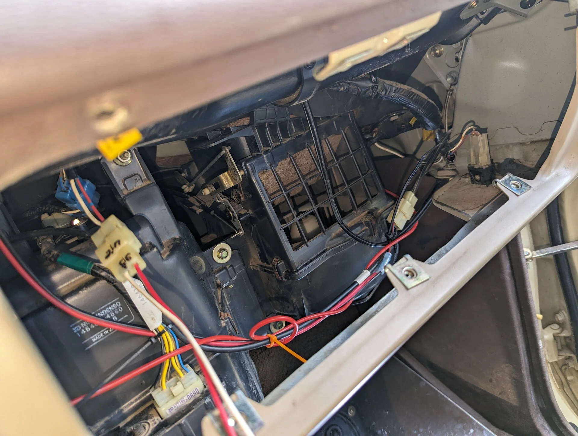

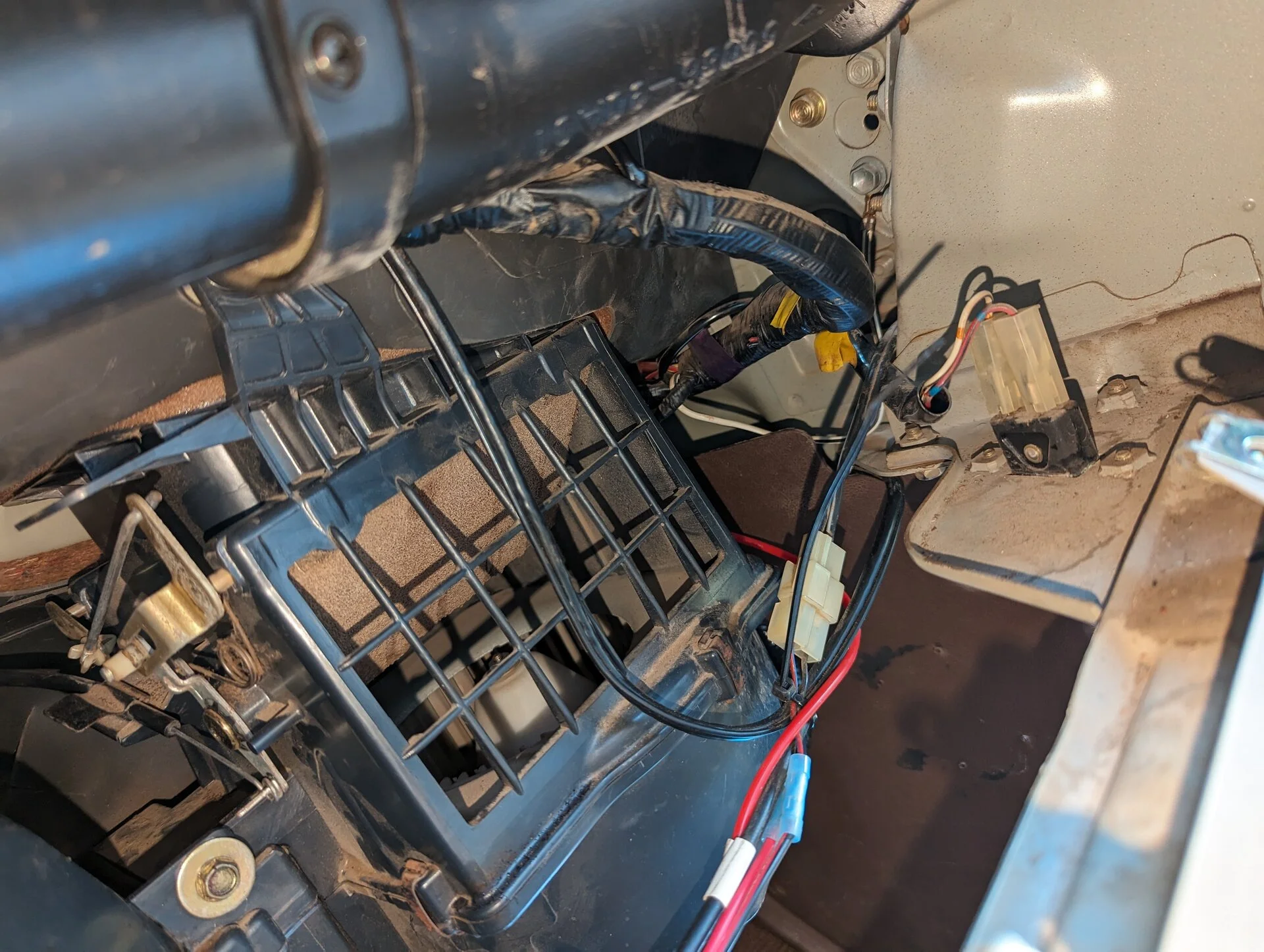

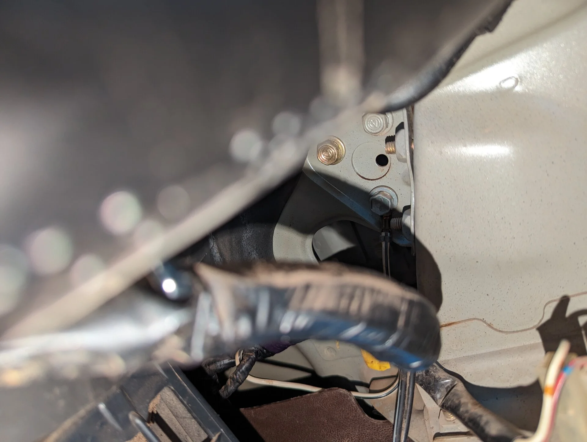

Here is my pic of the passenger side, I've removed the glove box and am looking through the hole where it was. Each pic I zoom out to give more context.
Note the bracket stays in the same top right of center in each pic, I just zoom out and pan slightly left.
The closest pic the brackets's bottom bolt is in shadow of a cable

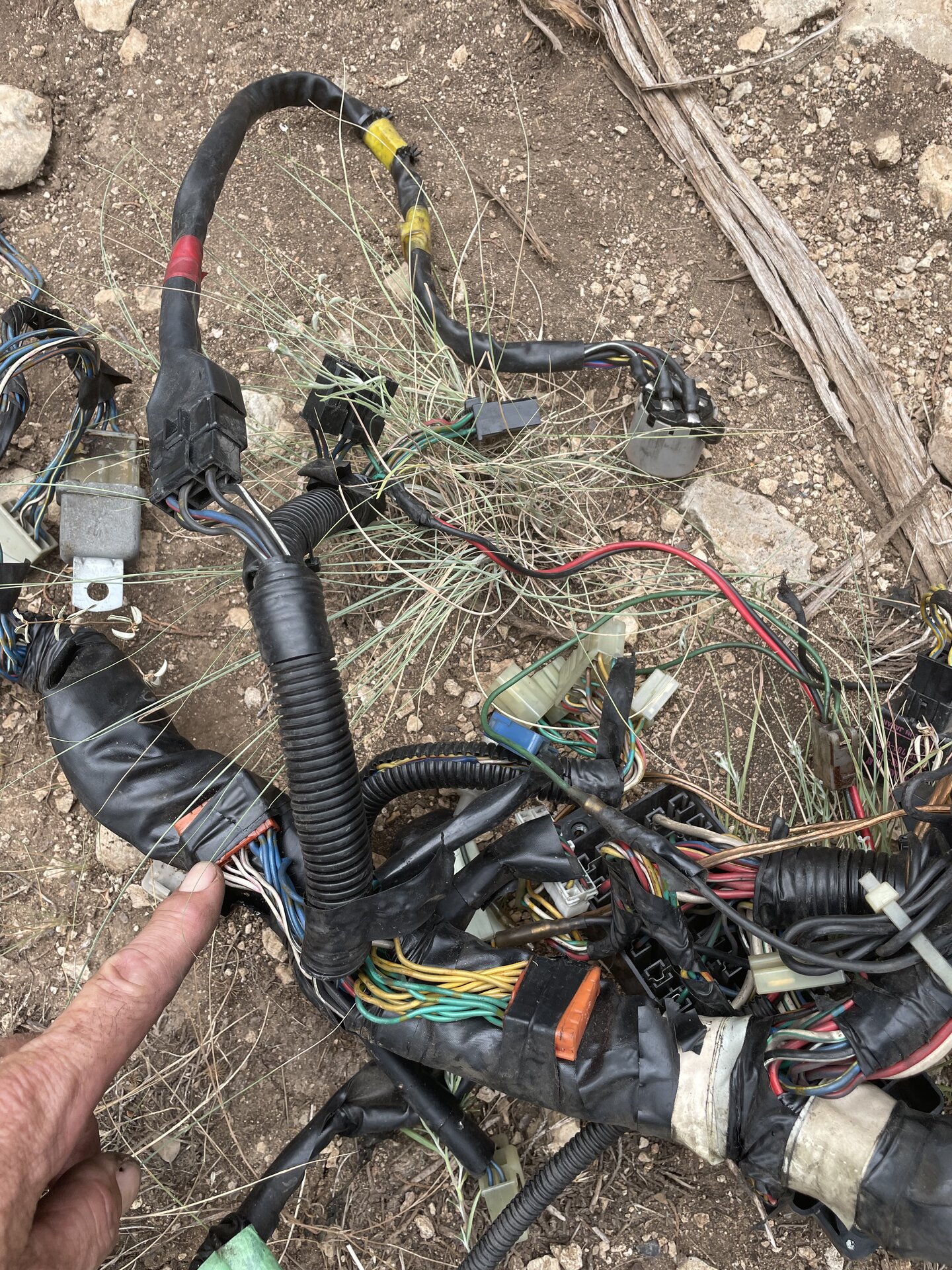

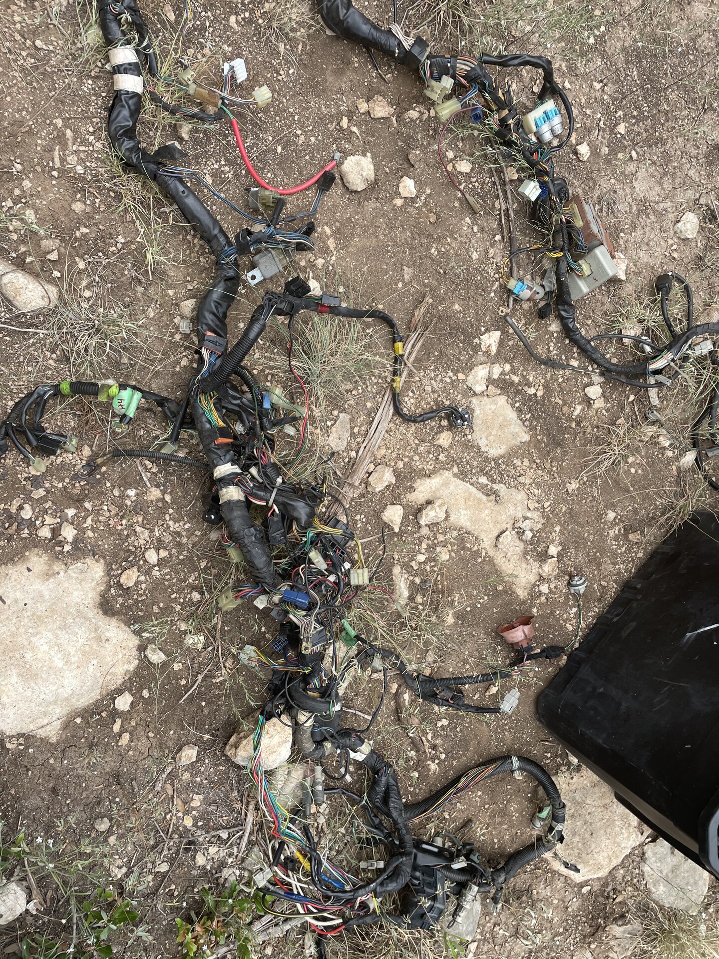

As this is where Google lands you looking for fj60 grounds, it's worth mentioning that earlier fj60 don't have the two grounding blocks mentioned at the top of this thread, each ground is spliced individually in the wiring harness. Not sure when the change occurs, but my 82 model built in 12/81 looks differently and does not have them.
The main obvious difference is
More of the plastic corrogated conduit and less of the smooth foam backed wrap.

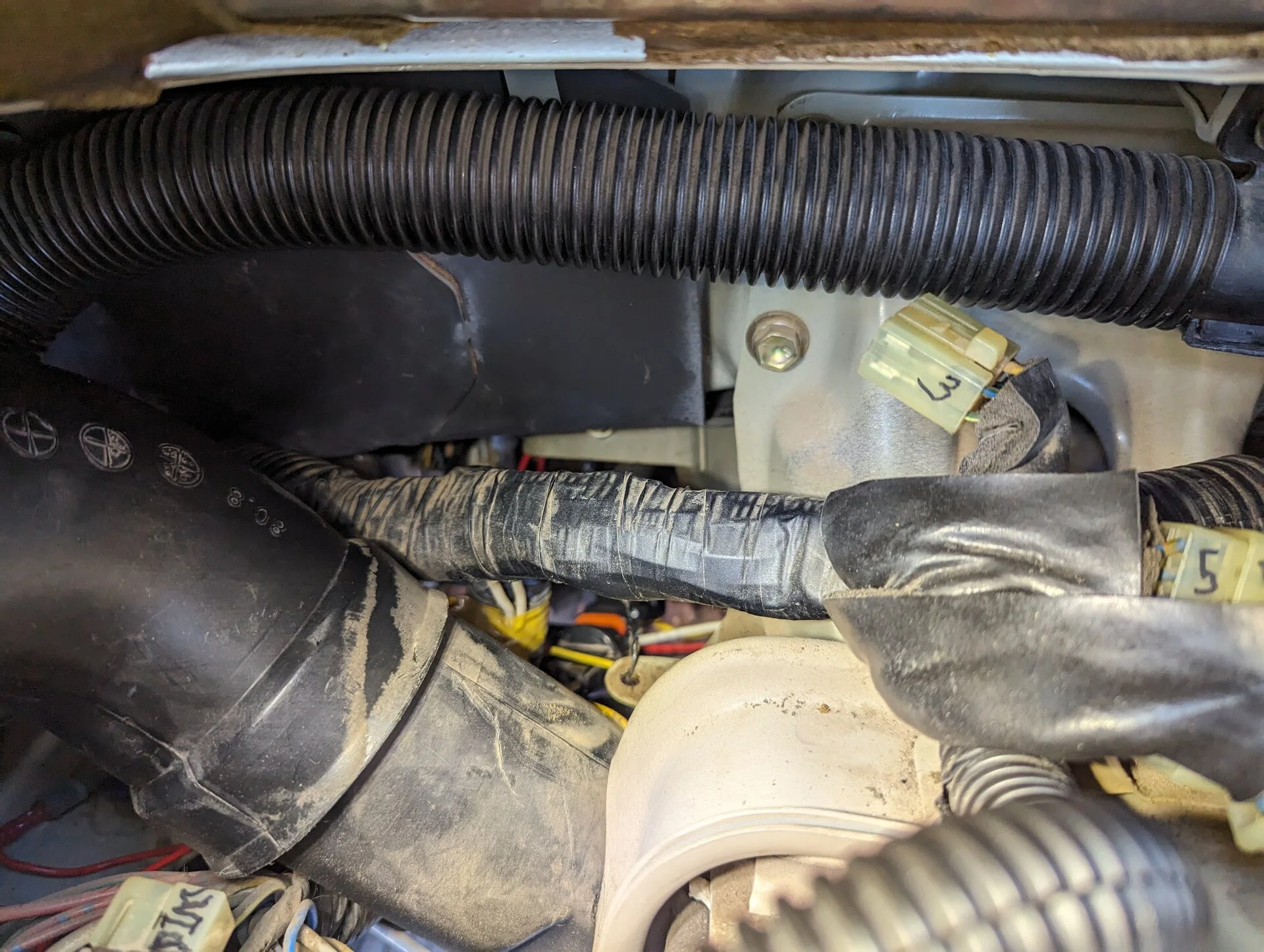

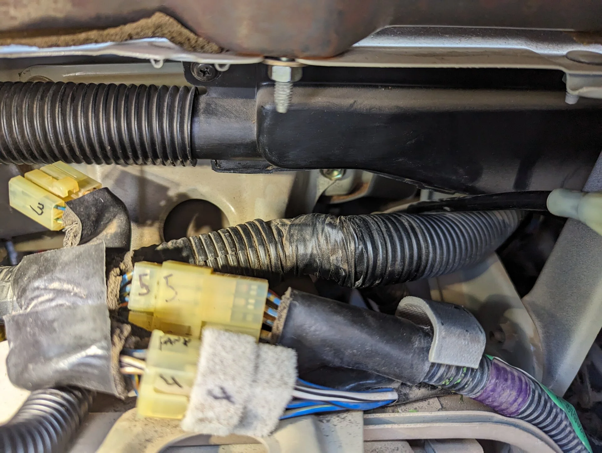

Herer Are pics of behind the instrument cluster.
Center and right side
Left side
Hoping to save someone all the time I wasted trying to find them.
