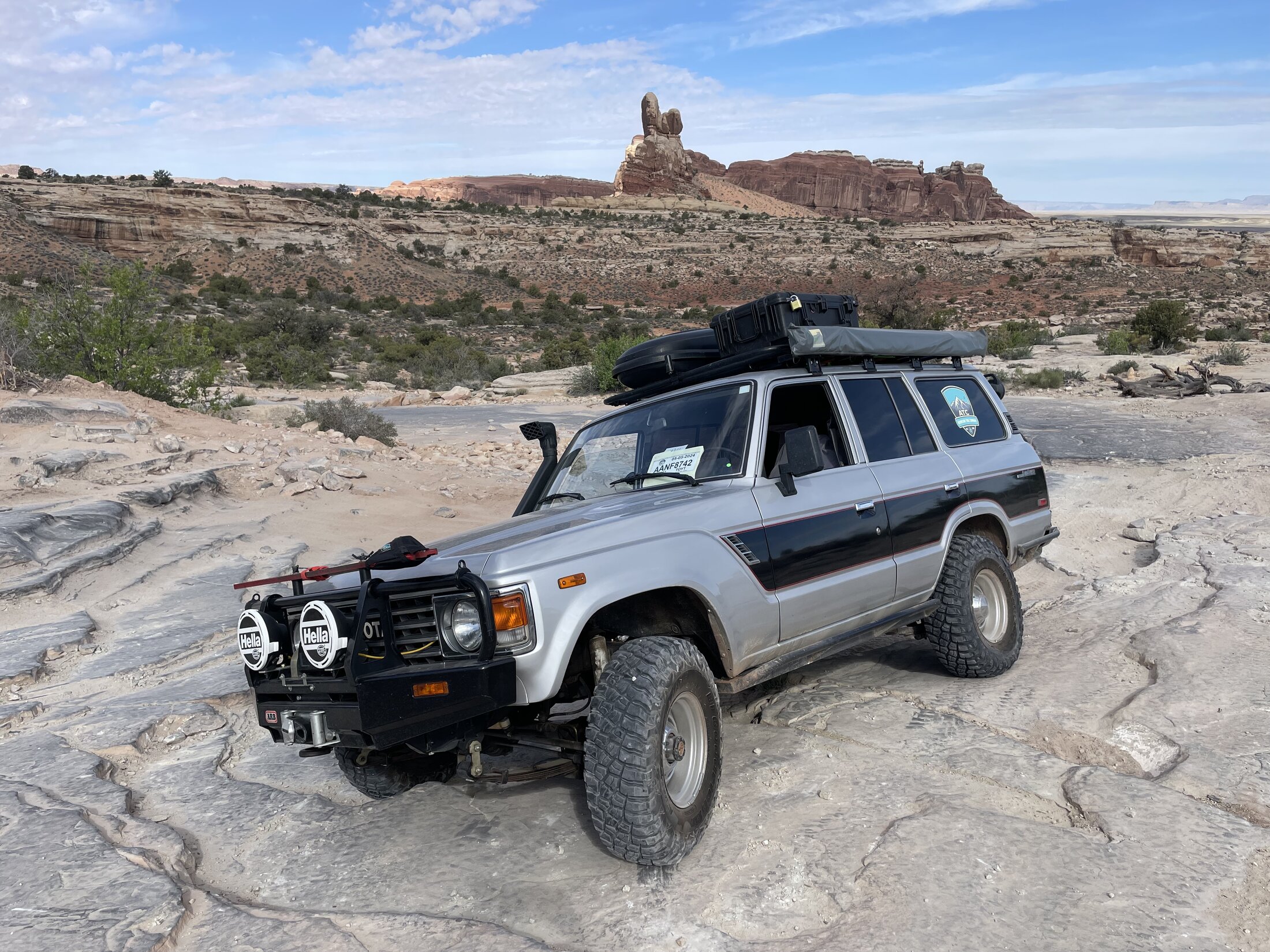

Steelies still working it......
Looks awesome! I'm about to do something similar with my build. Do you know what the offset or back spacing is on your steelies? Are you running a 2" lift? as mine is currently stock height and want to avoid the $$$ of new tyres and a lift!
Cheers
Brodie
Sorry for the delayed reply.
They are 15x8 rims on the OEM 40 series wheel centers with the riveted clips. Those wheels were 15x5.5 and the new wheels were setup/built with the same backspace......unfortunately its been 20 years since I had them made and I don't remember the backspace. LMK if you would like for me to measure.
The lift is an old 3inch BDS lift and shocks. I have a new OME heavy/heavy lift and shocks ready to go on soon.
Goodluck on your build.

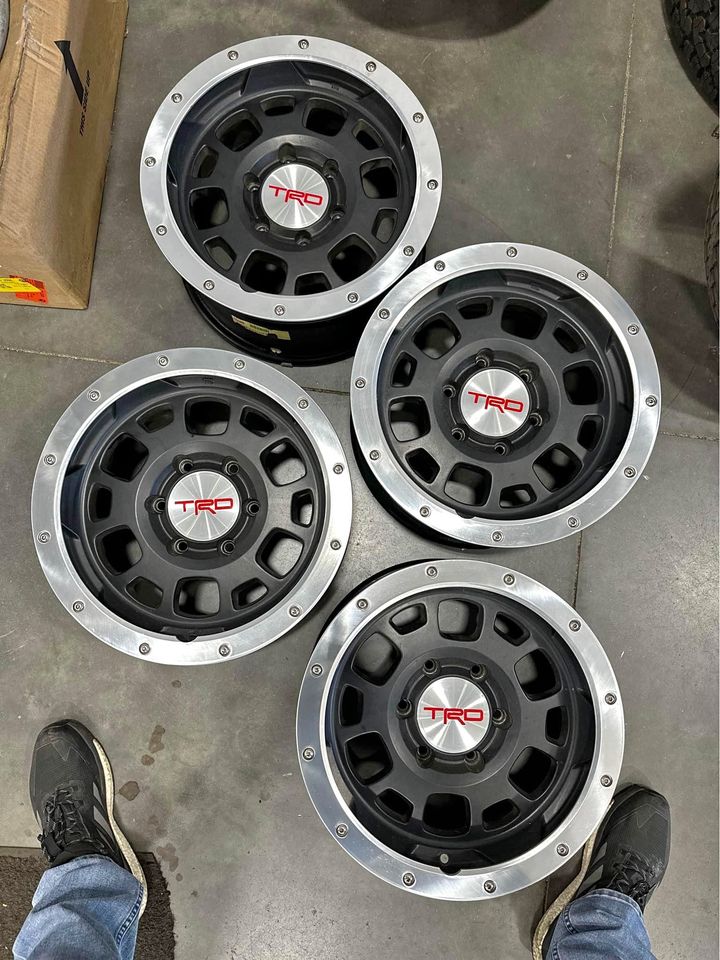

Not chrome. Satin sheen.

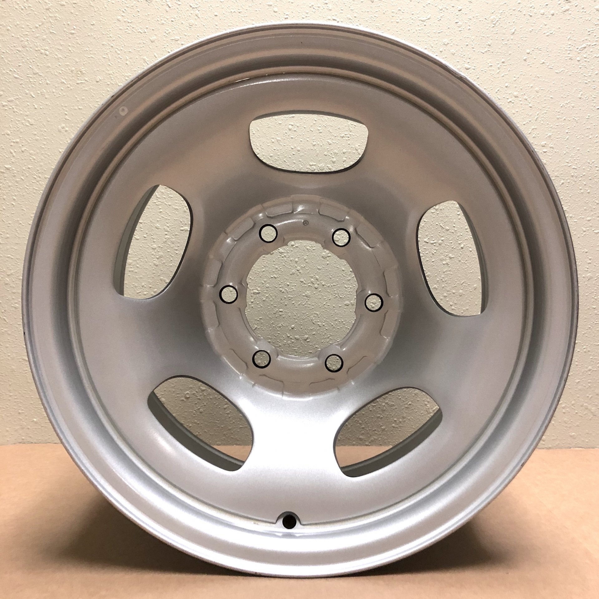

Does anyone know the paint code on the 42601-60262-03? Ordered a set from Toyotapartsdeal and they shipped them loose in 2 boxes! They are offering a good refund if I just keep them. Want to get paint mixed up and put in a can for touchup.
Thanks guys!
Mine arrived (from another vendor) in similar condition/ chipping paint chipping or rubbing off on the outer edge. *The metal lip is not damaged.
Watching for ideas of a good touch up paint…
The “right” way is to get them bead blasted and powder coated. Touch up paint on that edge is risky as when they install tires it could rip it off if it isn’t bonded to the wheel
The benefit of this is you can then use any color you want. Even send them to be chromed and theyll look like OEM wheels if thats what you are into
