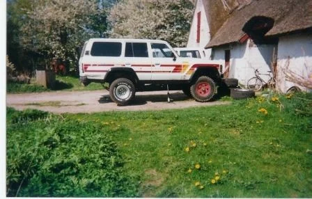

They work but with backspacing. I used 15mm.
Otherwise they eat the rubber boots on the steering knuckles.
I have them! And just for show had them polished to a mirror shine! grinpimp: No pics of that though...

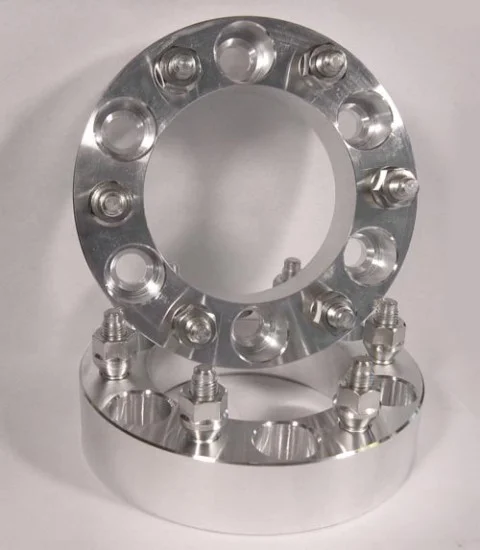

It is exactly the rims I have, 10" x 15". No clue as to what the "backside 4" means, but there is no options in the backspacing, so you have to use spacers like I did. I used some cheap ones and longer wheel bolts, not the best way to do it IMO. Below is a pic of a better solution.
I hope it helps, otherwise ask again! :)
Thanks for the clarification on the rims. I don't know what that backside 4 nonsense is either. Where can I get spacers like that?
A lot of the vendors announcing here sells them, I would suggest checking them. Click the IH8MUD.com - Support our Advertsing Vendors and start supporting! :D
