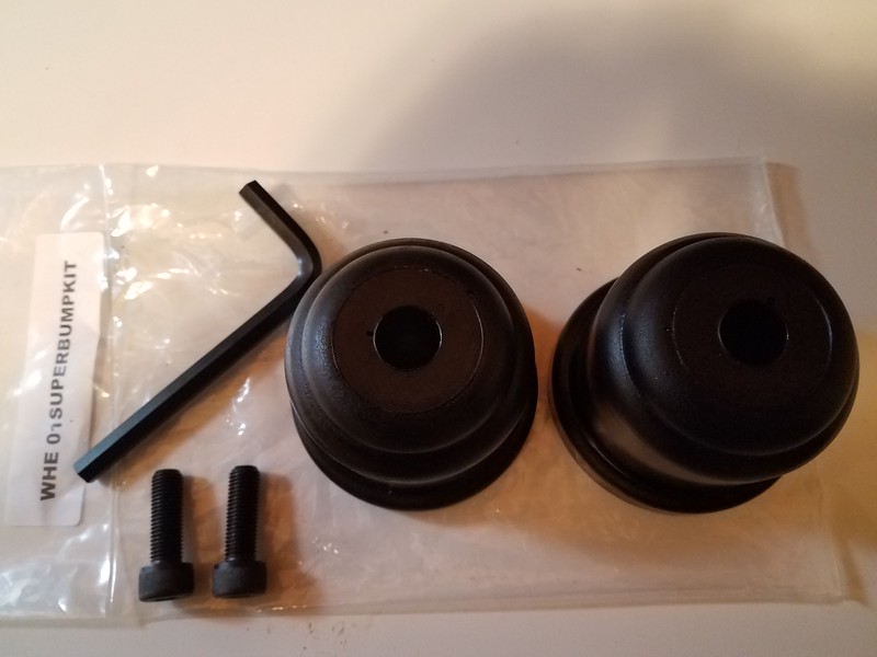

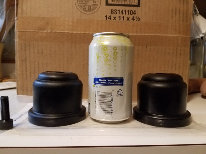

I received my order from Wheeler's and pictures really don't do these things justice. Great mounting hardware along with a nice allen wrench to install, plus a small bag of mixed candy with a sticker.
These are big!
I plan on hopefully installing this weekend. I was surprised how big these are and should be a good improvement. Keep you all posted.
About that allen wrench.....I had to cut about 1.5 inches off of it to clear the suspension.

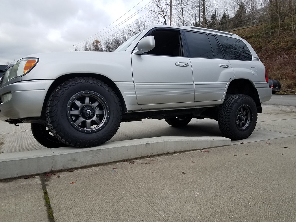

I was worried about the clearance against the Foam Cell Pros under compression, but it looks like when they squish out, the fat part of the shock bottom will be above it. I could only find a ramp tonight that would just barely start contact. Curbs are fun, though!
Here's a few pics.
Installing:
Clearance at full droop (wheel off ground). It is NOT touching the shock, it's just the angle of the photo...
At ride height.
At half compression, with picture of wheel for reference. These are 295/75/16's. I'll find a place during lunch tomorrow to really cross them up. I was at the loading ramp behind the local grocery store... :rolleyes:
You can see there's a few more inches to stuff still.
And no, those are NOT gold hub caps, it must be your monitor. Or the flash. Or your old-man eyes. I would never accidentally get those fugly things off eBay. And not notice for several weeks. No way. Not me...

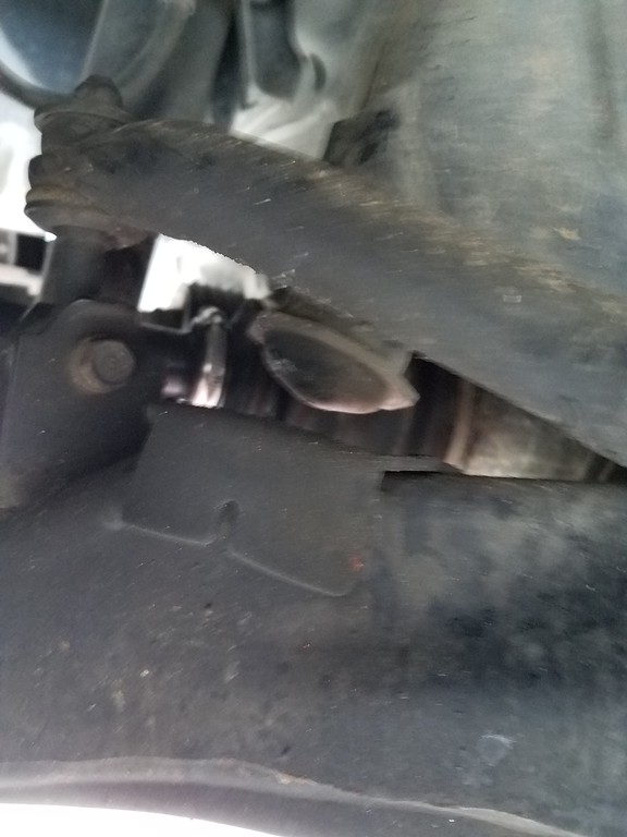

I installed mine tonight. Not sure what to think as I have not driven it much. For reference 2006 lx470 AHC. With the superbumps installed they just contact the lower control arms. When I lower the suspension the stops let the front drop about a quarter inch. Obviously with the stock bump stops it would drop at least an inch. My thoughts are that these will limit articulation on a stock height rig. I'm going to put some miles on it and see how it goes. I really don't ever lower it that much so the pros will have to outweigh this issue. Keep you posted.
My install was the same with the suspension at full droop. I cut about an 1 1/2 inch section of the 5/16 allen wrench and put it in a quarter inch drive 5/16 socket and used a 1/4 drive ratchet to crank them down. Kinda a PIA on the first one second was better.

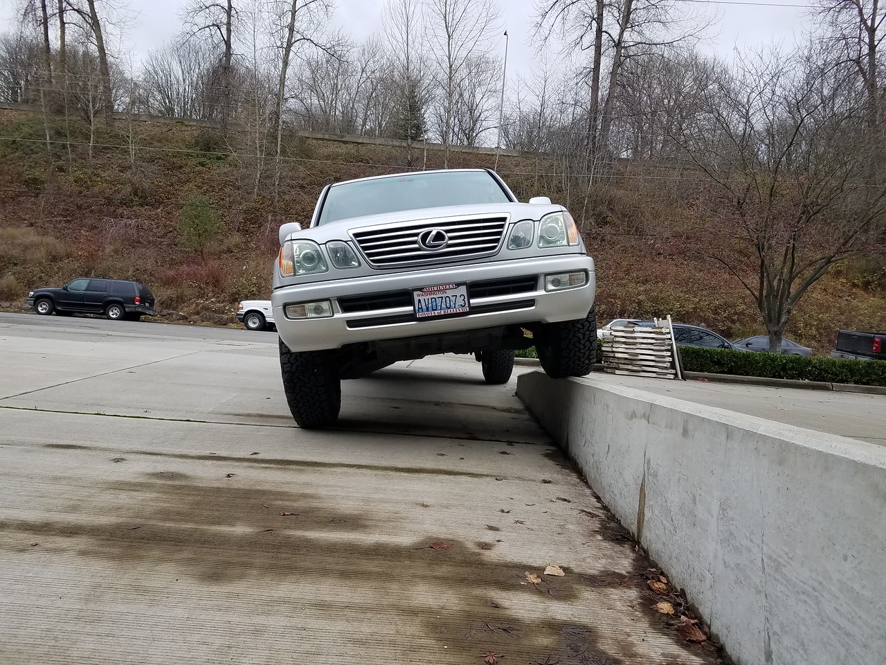

Got a chance to check compression today.
front wheelers bump stop
Rear factory stop
Probably not the best test of the travel limitation but as you can see the factory bump is about an inch from contact. It seems that superbump does limit travel. My ride quality is stiffer with less body roll . There are things I like about having them on but, I will likely pull them off. I don't think they are a good fit with a sock AHC .
