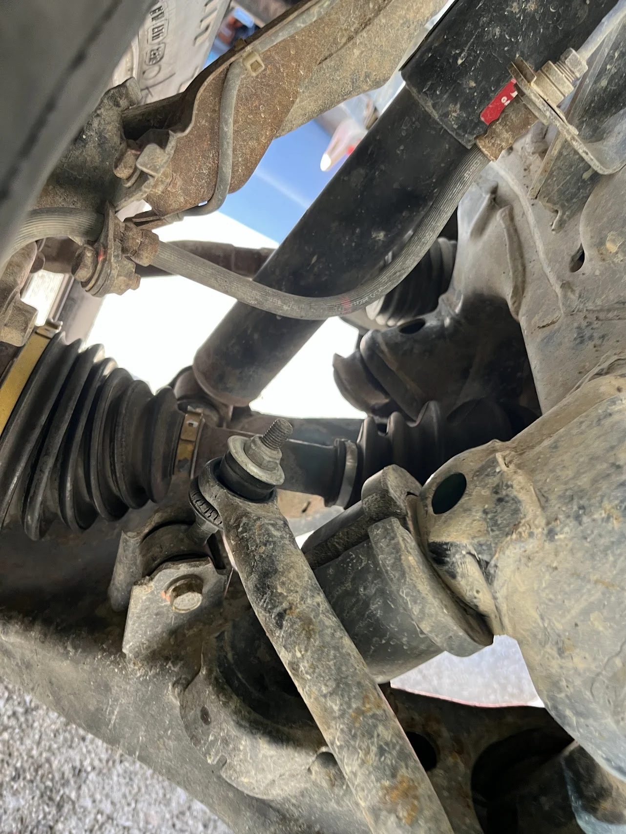

Wheeler Offroad "Superbumps" installed.
One trick I have used when installing these bumpstops (this was my third set!) is to super glue the bolt into the mount first. That way you can just twist the mount on, like the OEM mounts!
Otherwise you have to fiddle with the Allen key with 1/4 turn at a time!
Very similar. I wrapped the upper part of the bolt with some tape so it would stay put while spinning the mount into place to be tightened up.

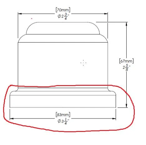

To those who have cut these to be a little shorter, are you glad that you did? Is there a noticable difference? Also what tool did you use to do this?
I cut off mine with a hacksaw. I wish I hadn't though. My truck is stock height and there is really no need to cut them off - they don't affect the upward travel at all. I got a second pair to install on the front position and this time around I didn't cut any part and still found no issues during the install or afterwards
Thanks Classy.
I did not, and would not, cut them.
That’s what I’m thinking. Mine are making minimal contact with the arm and I just don’t think it’s hurting anything.

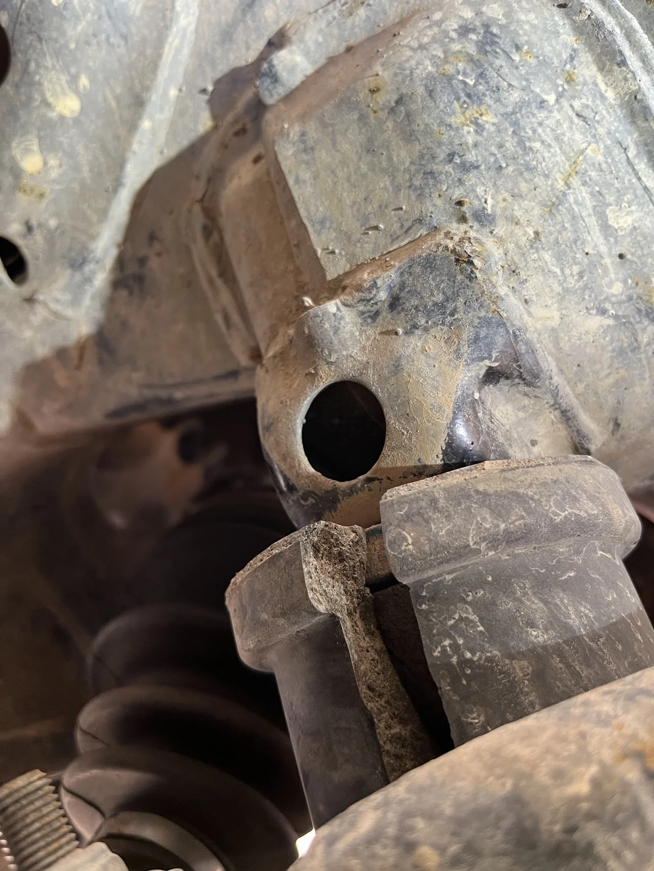

I installed Wheelers Bump Stops in October 2022 in the rearward bump stop position. The front position OEM bump stop was retained.
Today while doing some other work on the truck I noticed that the driver's side had split in two.
That's after 2 years and ~7k miles of use with maybe 1k miles in the dirt (likely less)
Disappointing.
I'm trying the Perry Parts alternative now.
Disappointing.
Well Wheelers said that since my bump stops were more than a year old they would not replace them. Even though they only had <~1k miles in the dirt.
Needless to say I can't recommend Wheelers in the future! I'm going with perry parts going forward.
