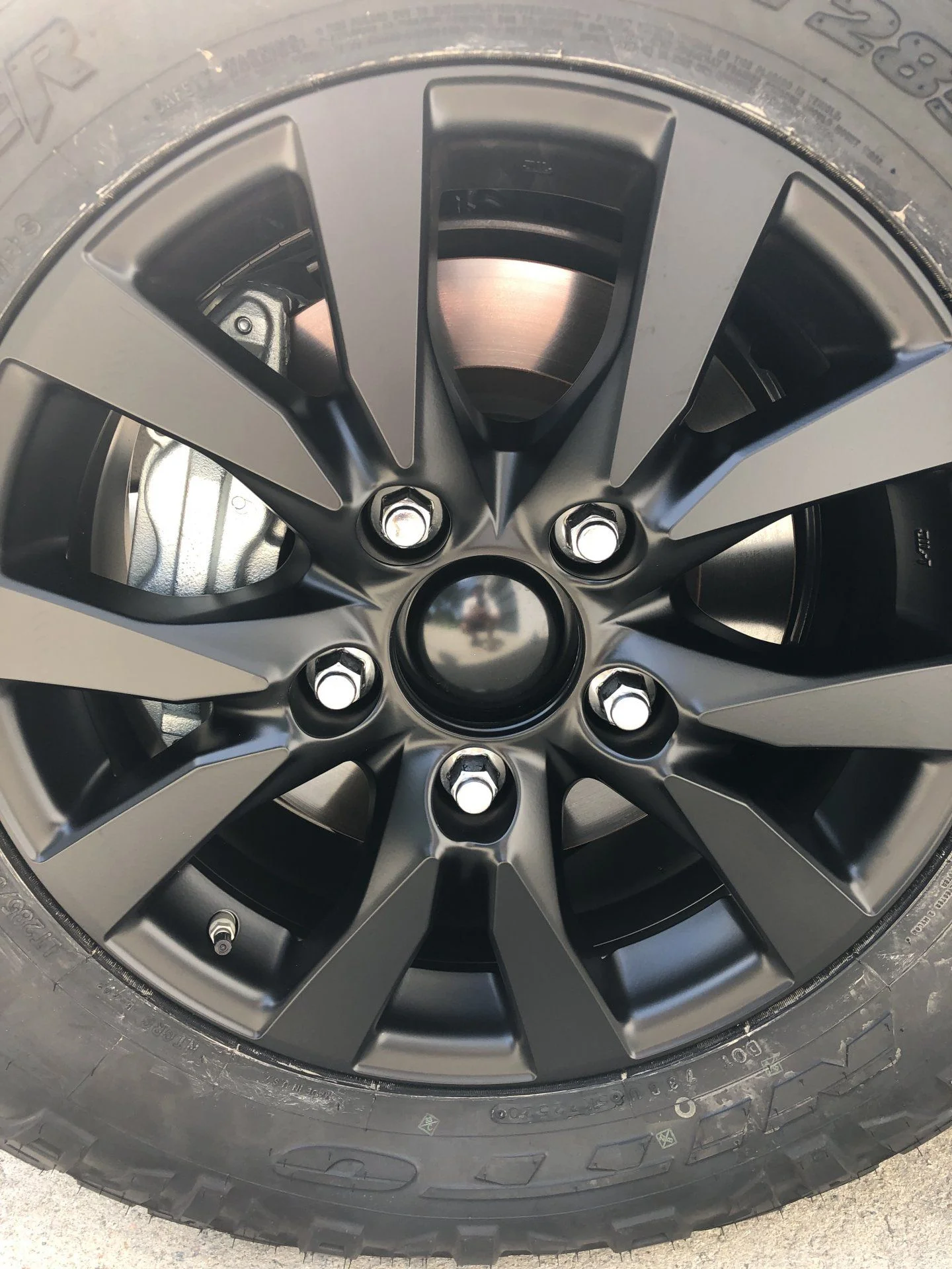

thanks for all of the advice folks! I ended up keeping the factory wheels but had them powder coated matte black ($600) and mounted a set of Nitto Ridge Grapplers in 285x65x18. Let me know how you think it looks!
They look excellent Black, I'm not seeing much advantage of the rock warriors myself.

@chslc200 looks great! Now please do something interesting with the center caps to match.
