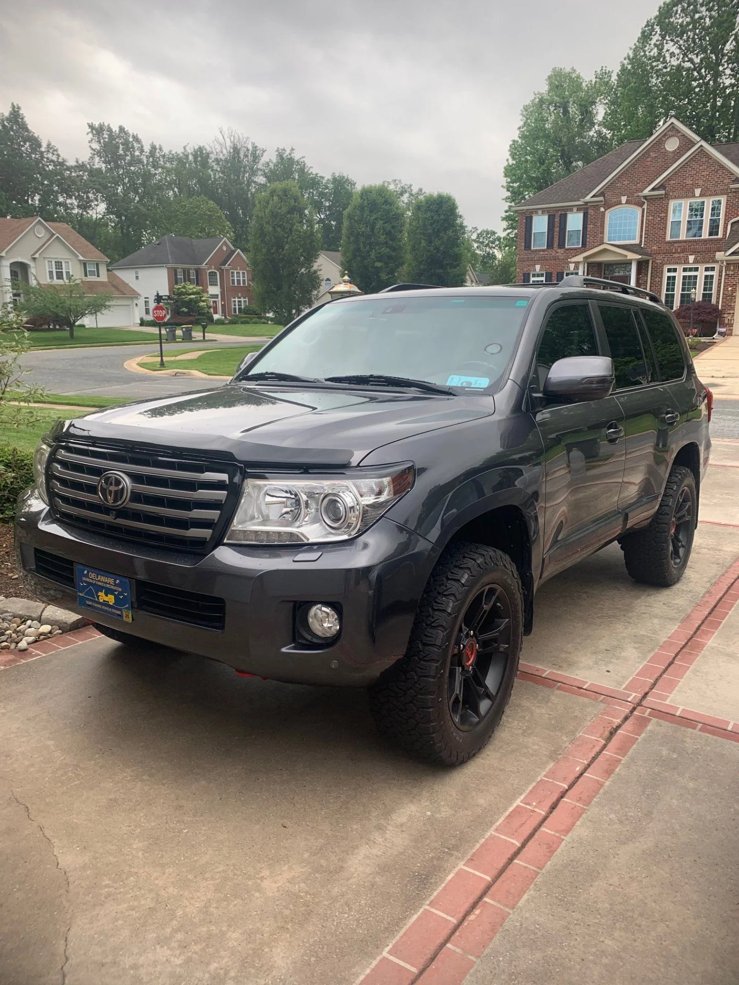

Beyond that you mention 19" rims but 285/65/18 which is a common upgrade size.. 18s or 19s? I'm very happy with my 285/70/17 setup, slightly bigger than the tire size you mentioned. Probably the only thing I'd change is raised white lettering but it wasn't an option on this tire. Note this includes the above strut spacer, and pretty worn street-oriented AT tires, but it gets the size across.

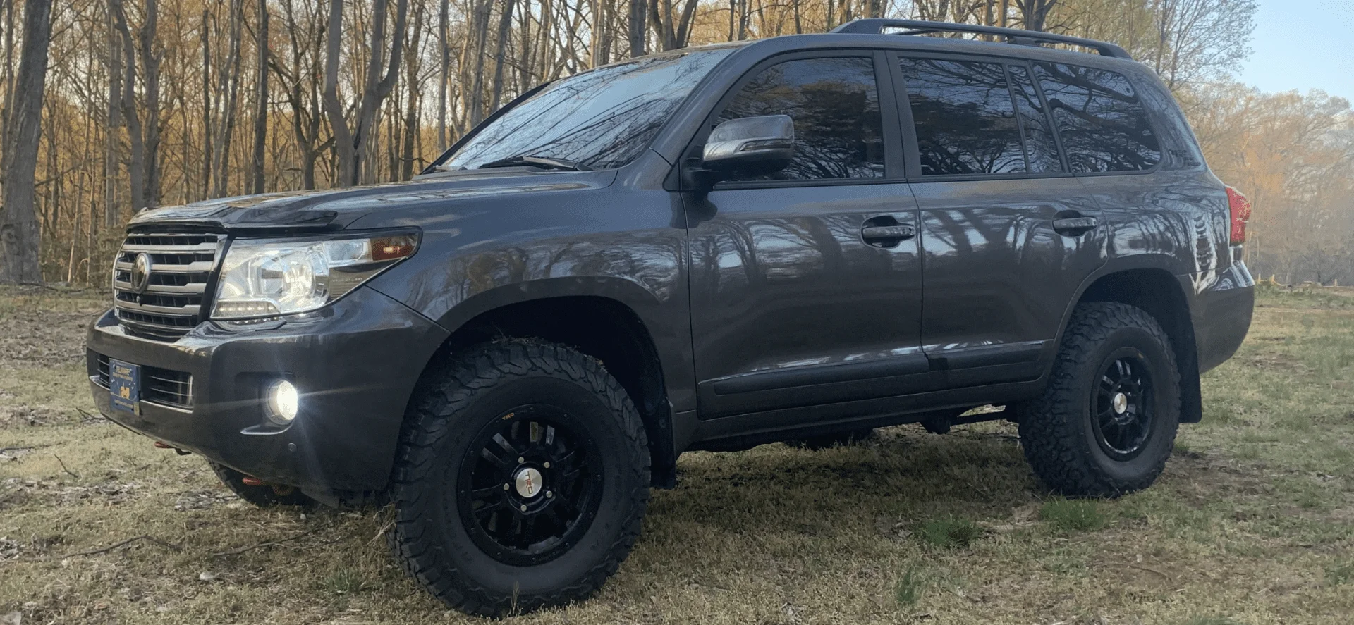

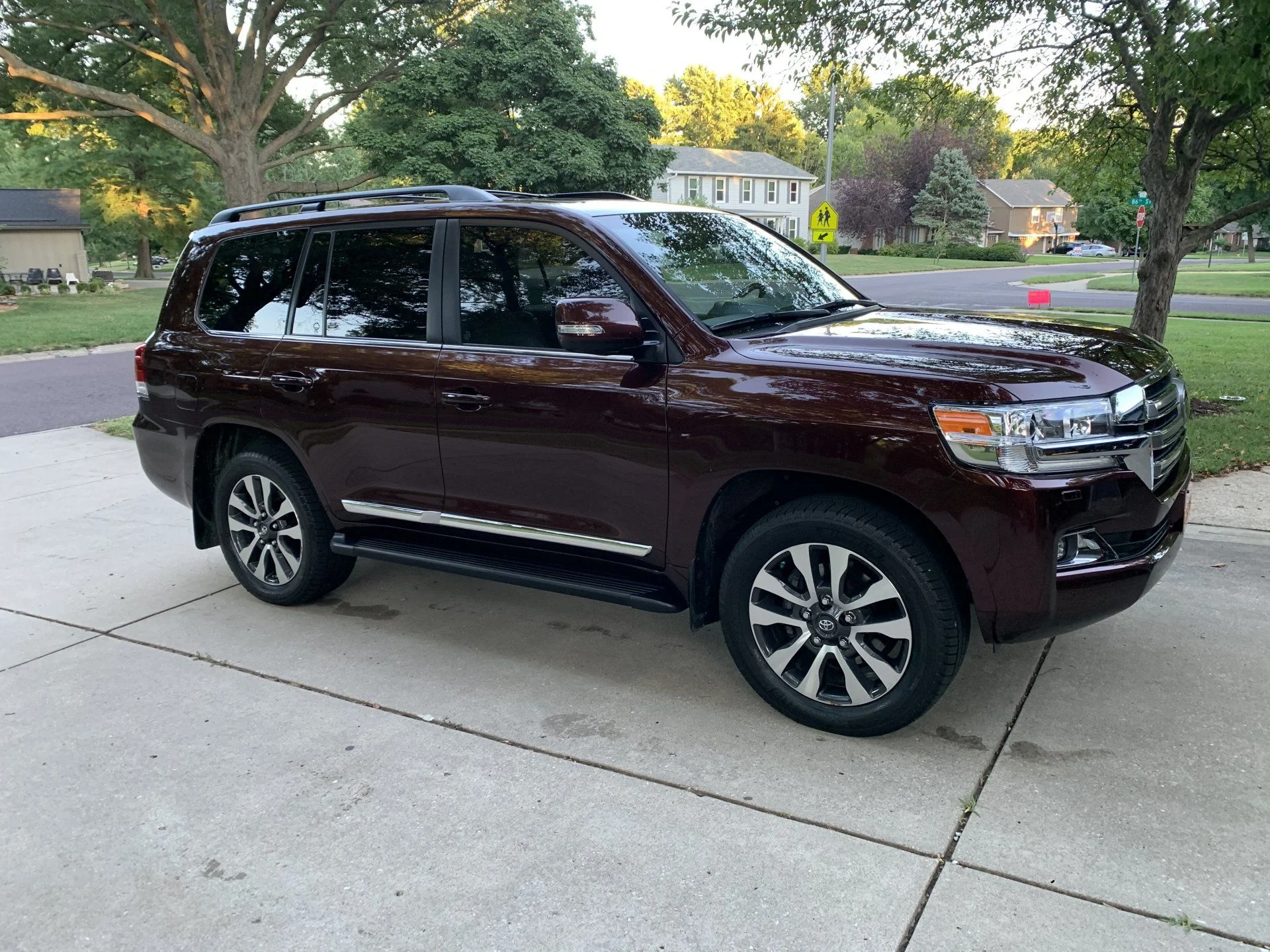

Here’s what the stock LC looks like now.
I figured since you were considering 19" wheels why not look at some 20's. I picked up a set of (5) to cover my spare too. I really like the way the fill out the fender and give this truck the right amount of offset. I run a 285/55R20 BFG but I could have probably gone 285/60R20 to give me a little more side wall. I wanted the TRD PRO wheel that come on the Tundra and now HE but couldn't justify the price at the time. I didn't want to run spacers to give it the aggressive look I was going for.
Thanks! Your LC looks great!
additionally, what is the offset of your rims?
Thanks! Great look! These are 285x70x70’s?
Yes they are. Main reason I went with BFG is because they were take offs with zero miles. Tundra owner decided he wanted bigger! This size you can rest assure won’t ever rub even with a stock suspension.

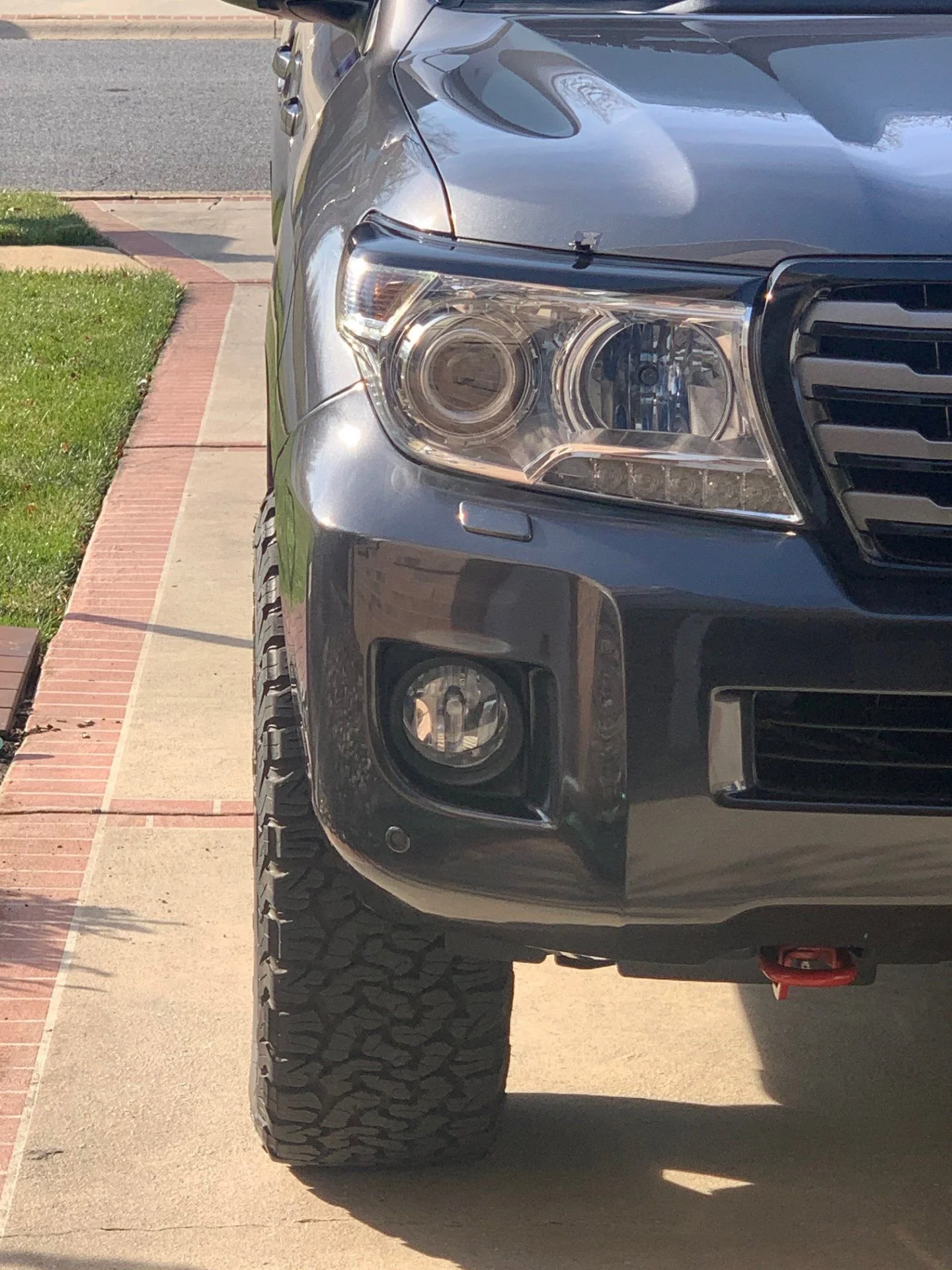

I got VERY light rub on one side at full lock, reverse, with some articulation. So light that with 10k on the tires it stopped. But, my toyos are taller than KO2s, many people running those don’t rub as they are usually on the smaller diameter side for a given tire “size” in general. Also note that if you go 285/70/17 KO2s they are available in a C and E load. C would be lighter and more compliant and as a result give better ride qualities, but some people opt for the more robust e-load. Frankly the vast difference between LT-E and the stock P-metrics on factory suspension is a large part of why I went with the tires I did, so don’t assume the difference won’t be noticeable.

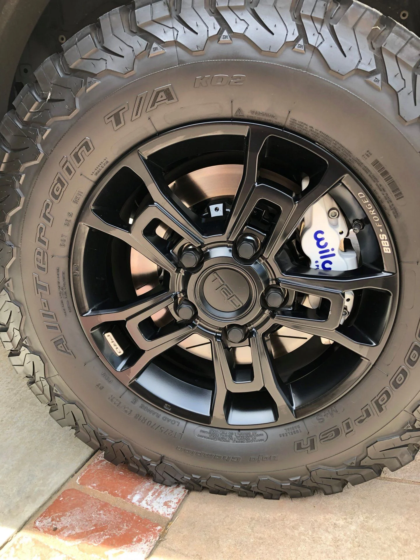

Just remembered one very important detail if you go with 17s. Your new truck has large front brakes and they won’t fit into most 17s. To further complicate it, your 2020 had the updated brakes from 2016 on so what fit on a 2008 might not work for yours. The model many of us run are the forged TRD “Rock Warrior” designed to fit tundras which have similar bigger brakes to yours.
If you go with other 17s make sure they will clear your 2016+ brakes. I seem to remember some of icon’s models clearing but I’m not sure on that.

Thanks! I was concerned about the brakes fitting. They are snug with the factory 18’s.
