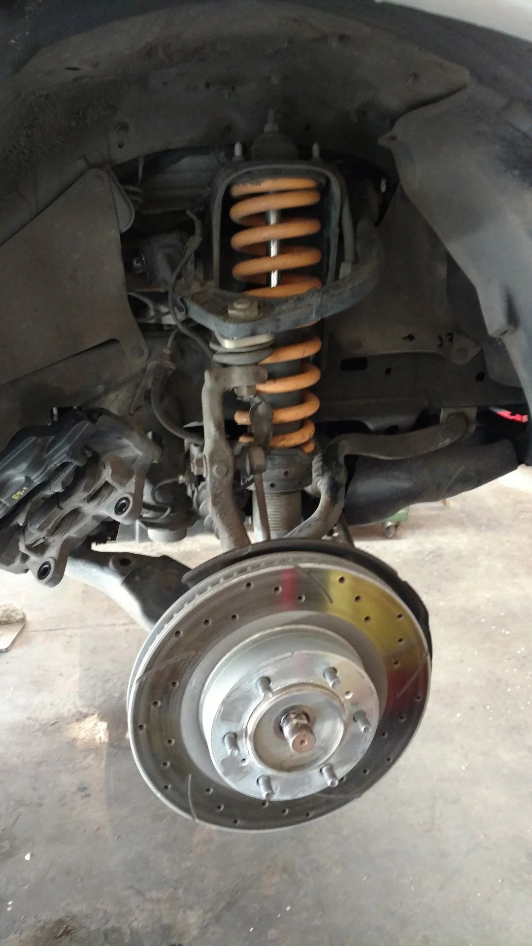

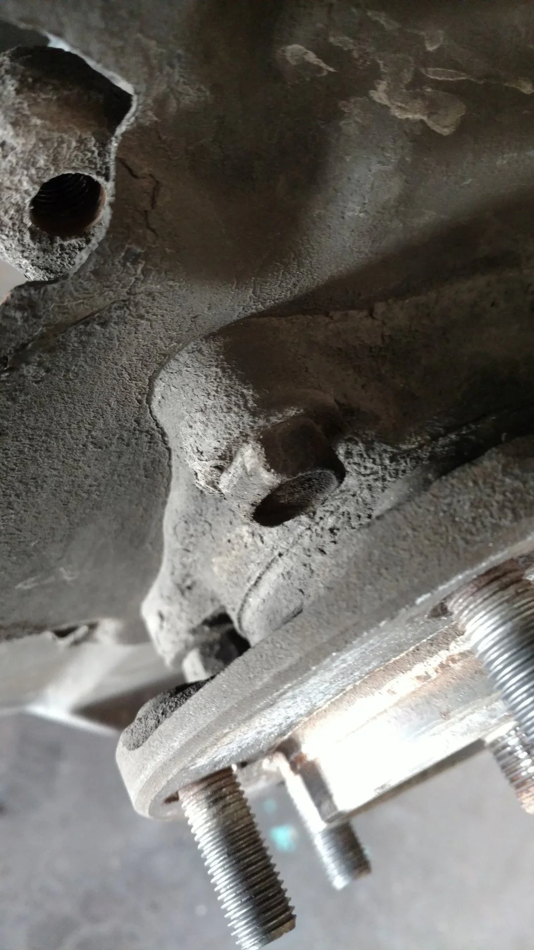

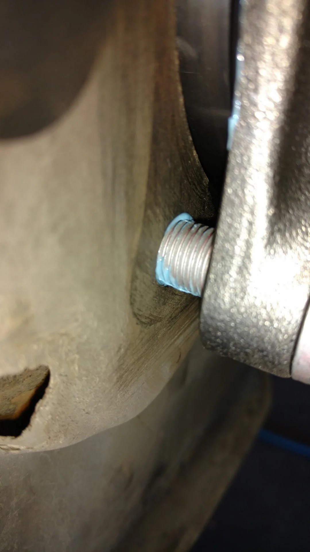

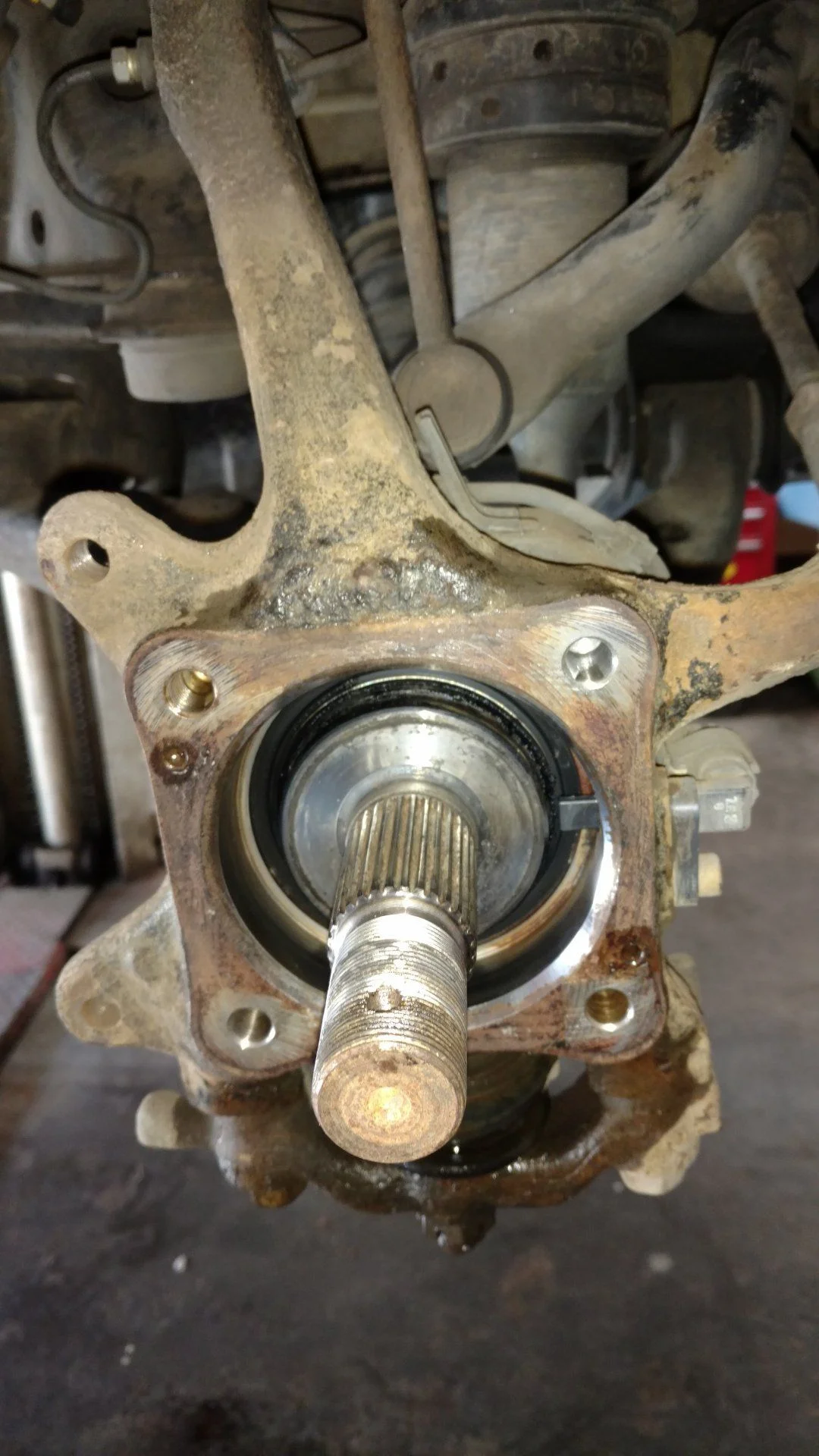

So today while I was up at the in-laws I took advantage of the shop and lift and put the GX on it and swapped out my wheel bearings. This job is much easier than I expected, it took me just over an hour and a half, from pulling into the shop to backing back out. So about 40min a side, and that was with taking pictures and forgetting on dust shield lol. I sourced my wheel bearings from Jersey Hubs, he is a guy over on t4r.org selling completely assembled bearings and flanges. I paid $390 for two complete units, shipped to my door with new cotter pins and axle nuts as well as new dust seal. So what is the procedure for this? Well basically you will pull your front wheels, then pull the calipers, next remove the rotors. Now you are down to the flange. There are 4 bolts that hold the hub assembly into the spindle. They are 17mm and need to be loosened. Once they are all lose and back out a way gently tap on the flange with a hammer to break the hub assembly free from the spindle. Once it is free and you can pull it out finish undoing the 4 bolts and remove the old hub. Thoroughly clean out the inside of any rust or other contaminates. Then take your new assemblies and put some blue locktite onto the 4 bolts, make sure you don't forget to reinstall the dust shield (I did and I had to pulling everything all apart again) and then install the hubs. Evenly tightening them in a criscross pattern until it is all snug and tight. I didn't look up the tq specs but I was able to loosen them with an open ended 17mm wrench so that's how tight it got them. Each side is the same. I recommend having the vehicle completely in the air for this as you may have to rotate the axles to align the new hubs correctly. - I did Thai without removing the axles, there is no need to pull the axles to do this job -if you are doing dust seals then you will have to undo the spindle from the lower a arm/control arm and pull the axle. I will do seals next time I do axles.
