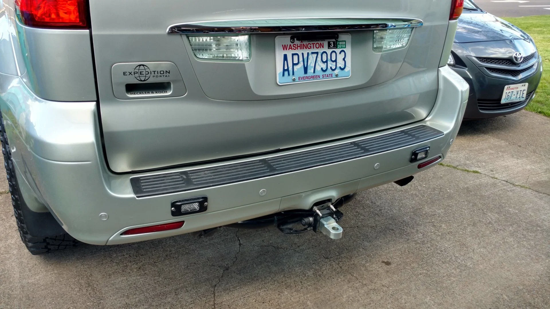

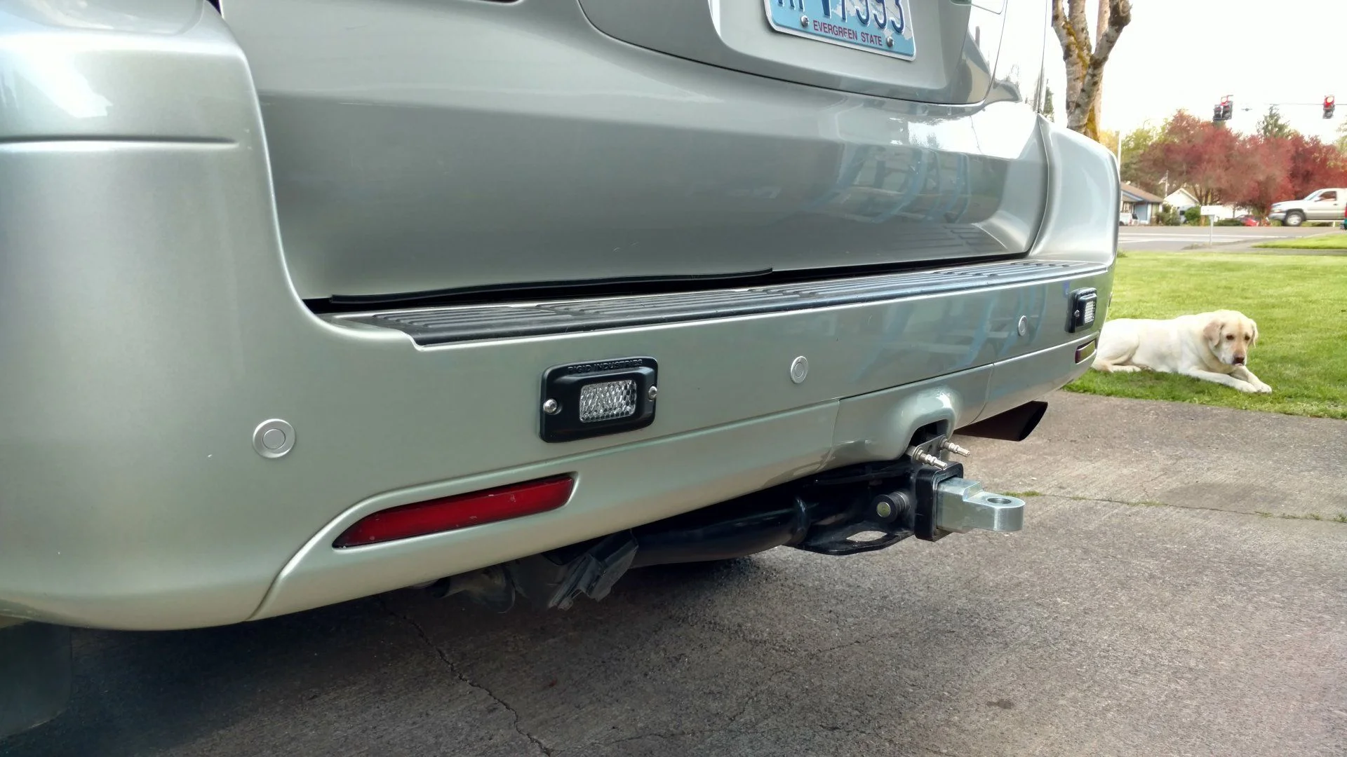

So today I installed some backup sensors in the rear bumper. I ordered them a couple months ago off Amazon and just hadn't had a nice enough string of days to get them installed. I also wired in a switch on the ground so I could cut power to them if towing a trailer. I wish they were a little louder but for $20, I can't complain at all. The installation was pretty simple, and straight forward. I'm really happy with the outcome and this will be a mod that will serve me well from here on out especially with the limo tinted windows.
^May I ask why you need backup sensors when you have a camera?
Last night driving home my traction control freaked out on me and almost caused me to crash several time, it would randomly without warning grab an individual front brake and pull the vehicle hard one way or the other requiring me to pretty aggressively fight the pull, it almost pulled me into a couple vehicles on the fwy at around 70mph. This morning it did it again and so I just had it towed back home. I had suspected it may be the lower control arm bushings that were bad. So I cut the old LCAs out and put in all new stuff (had it sitting on a shelf in the garage) it cost me a day of work but it feels so much better now. I'll be a little nervous about driving it for the next few days not gonna lie. I felt bad for the people I almost hit. I would be very pissed if I was them.
A; I have no backup camera, B; cause I like drilling holes :censor: , and C; cause why wallet was too heavy. -1 of those is a lie, and 1 is taken way out of context...
Ahh, I forgot Lexus built peasant spec GX's that didn't have a back-up camera. o_O I sent you a PM about your reverse lights.

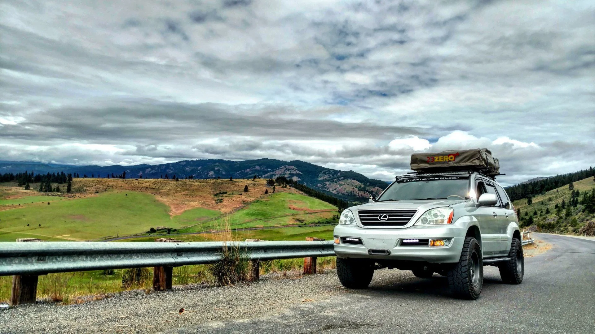

Took this picture on my way home from the Northwest Overland Rally, had a blast up there, will definitely be going back next year. I had more pictures but they got corrupted on my phoneView attachment 1481710
Which brackets did you use for the overhead light bar?

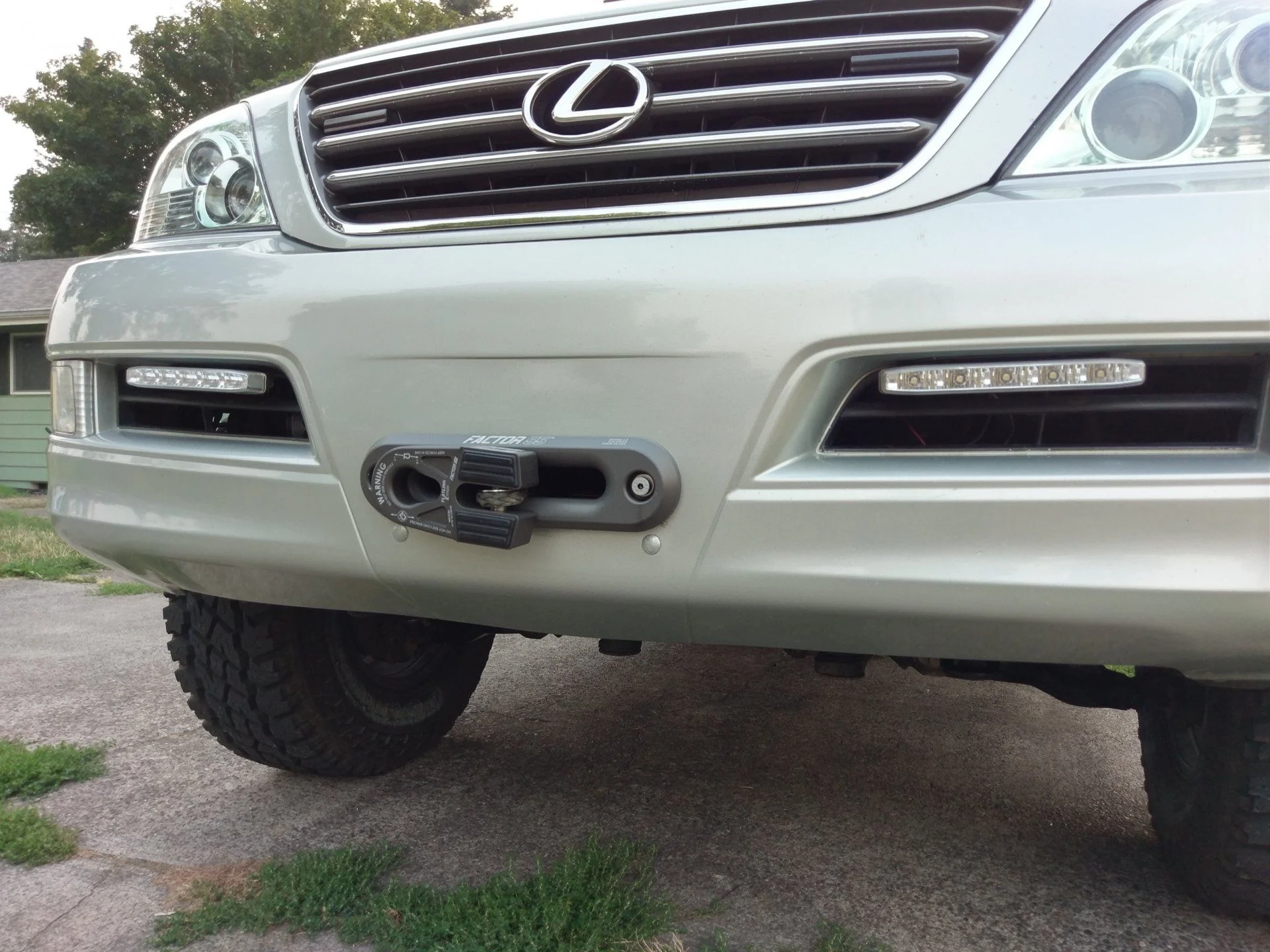

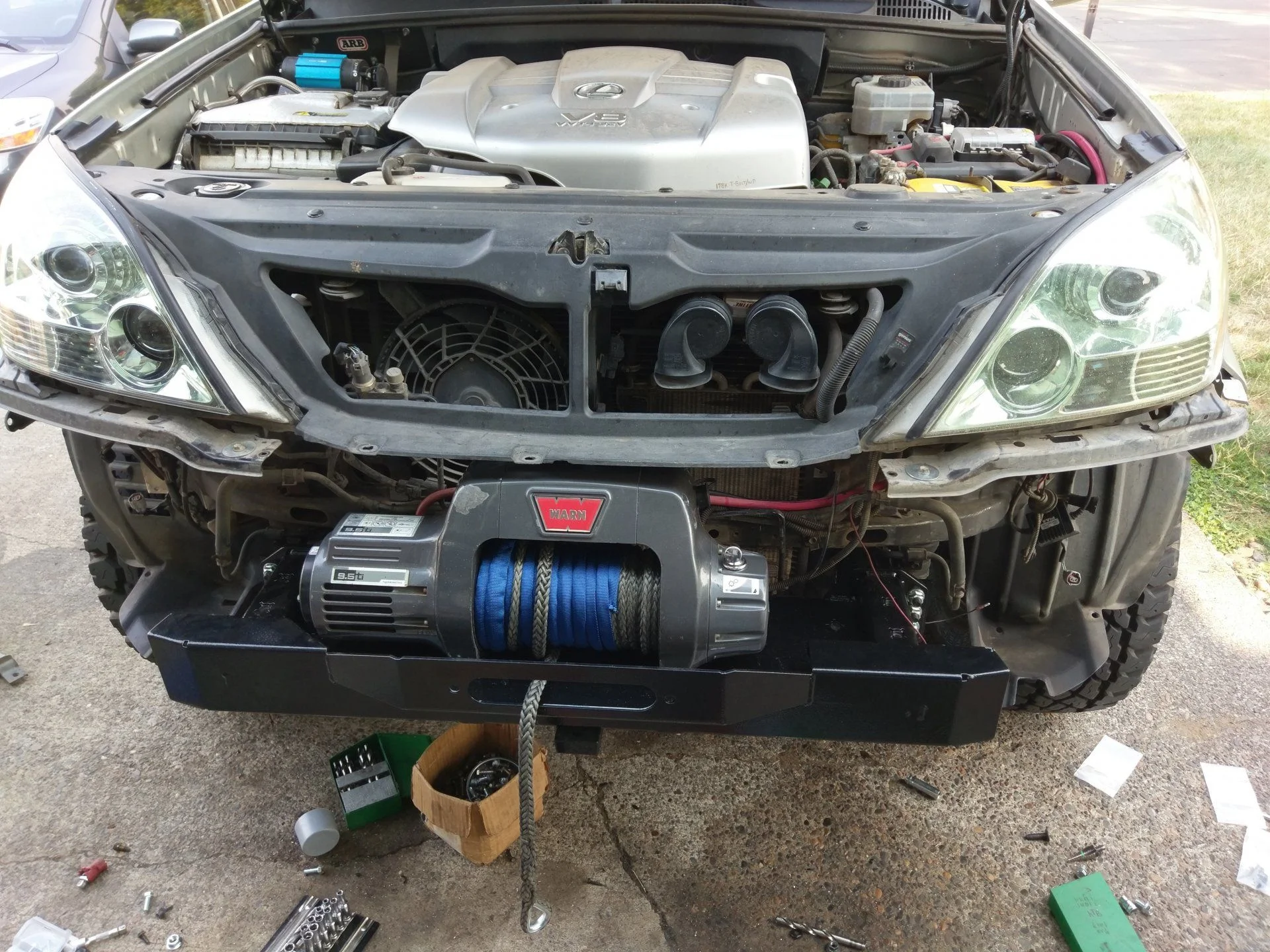

Well I finally got around to installing my winch. Southern Style Offroad makes an awesome hidden winch mount called the incognito winch mount, and it's fantastic! And the best part is my warn 9.5ti fits and clears the bumper. There was so much room I almost thought about forgoing the winch and making a hidden compartment and smuggling drugs but... I had this winch just going to waste in my garage...
