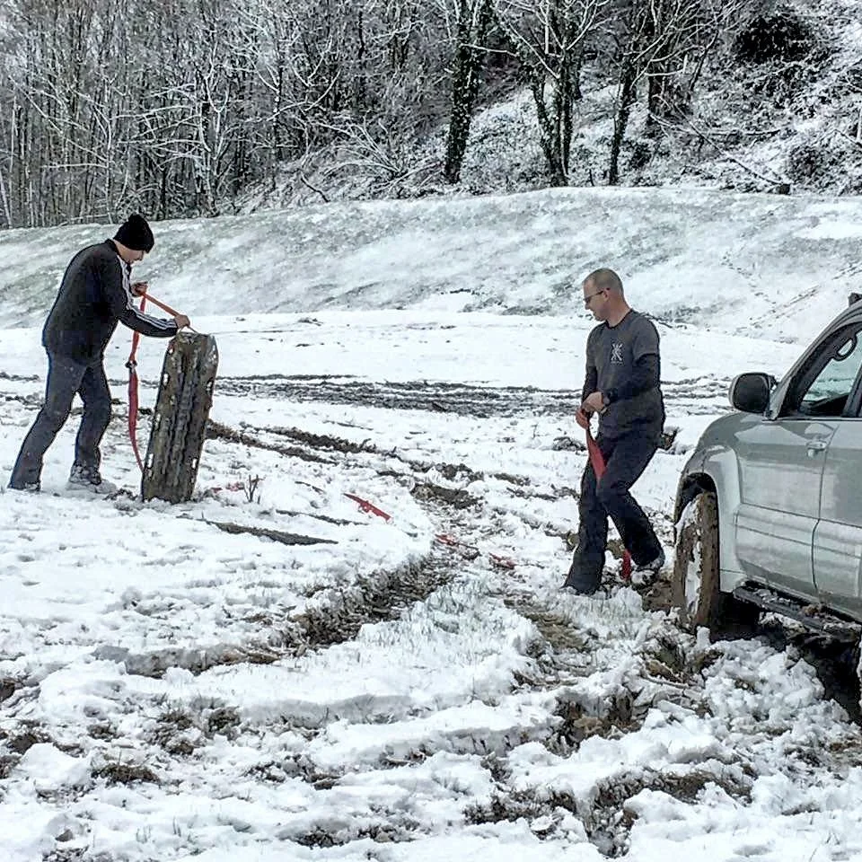

So I have had a set of maxtrax now for about 6weeks and yesterday I got to use them for the first time. I was in a new housing development that come to find out was halted because of the natural spring that the developer can not control. Anyhow after spending the morning sledding with my kids and some friends we go to leave, and I decided to pull through instead of backing up. I new where thought I had a good idea where the spring was because of the small pond it has created... Nope I moved ahead about 20' and promptly sunk the Lexus to the frame. It was my first attempt or personal use of the maxtraxs and they did amazing! Well worth their cost, considering the tow bill would have been close to the same. Intact I was so impressed when I got home I bought another set a onI'll have 4boards now.

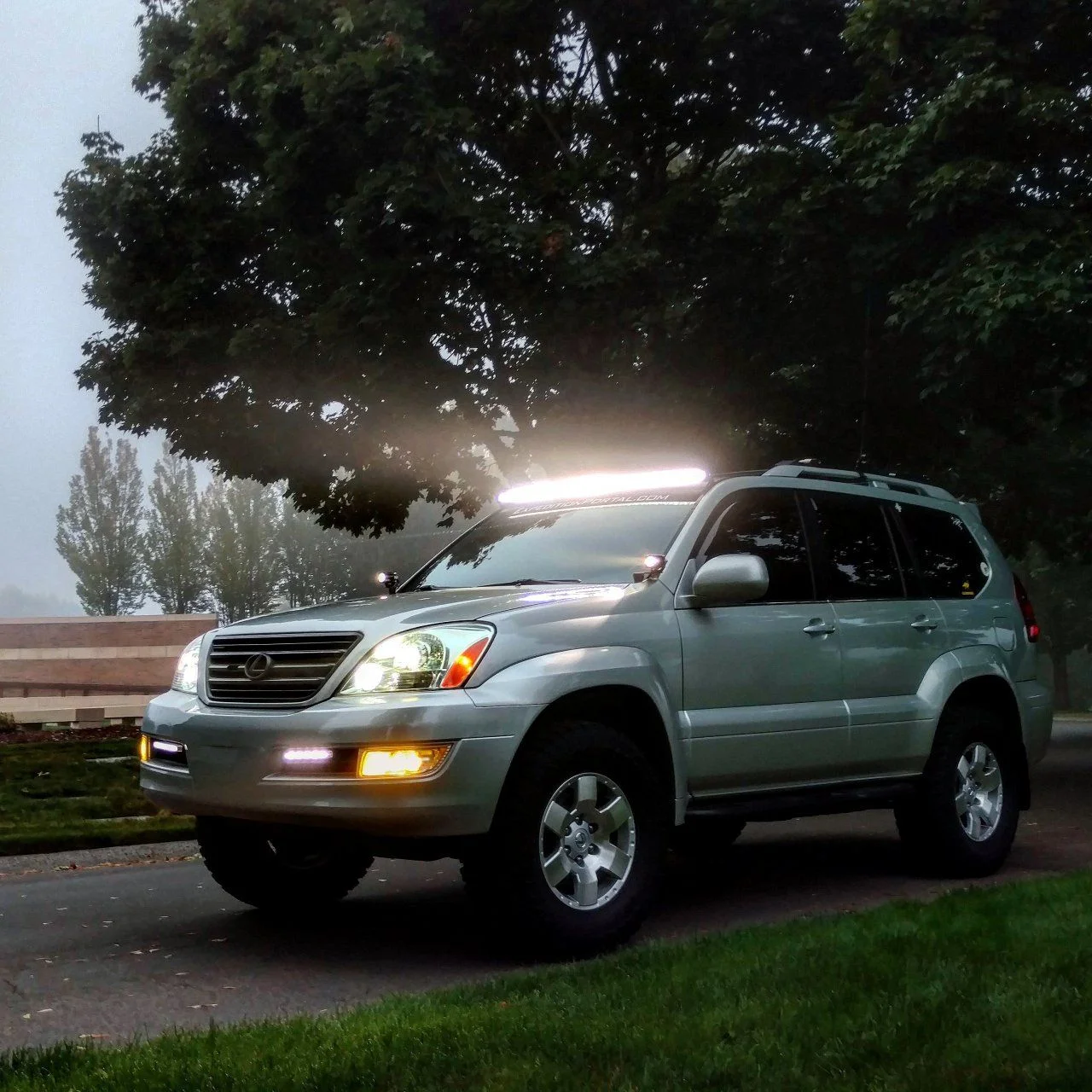

i also have swapped out the dual row light bar for a single row bar, i like it a lot better, as its a lot less noticeable, sleeker looking and more inline with where i want this build to go.

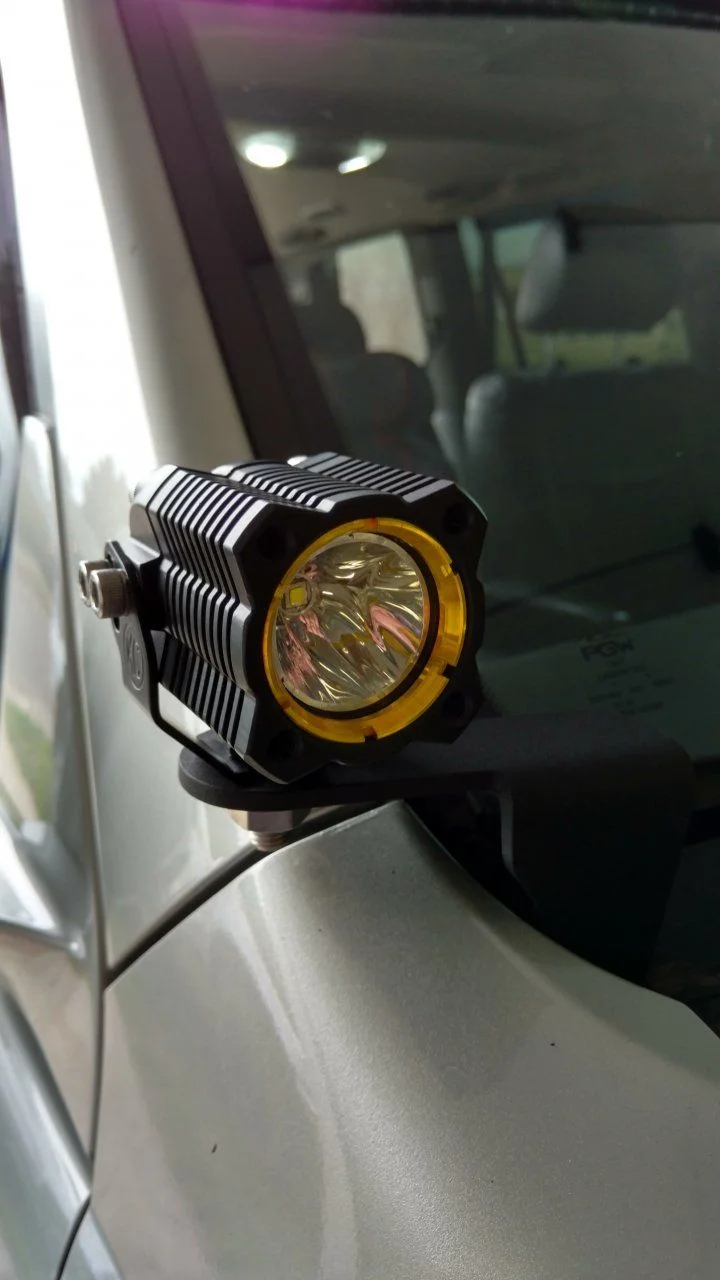

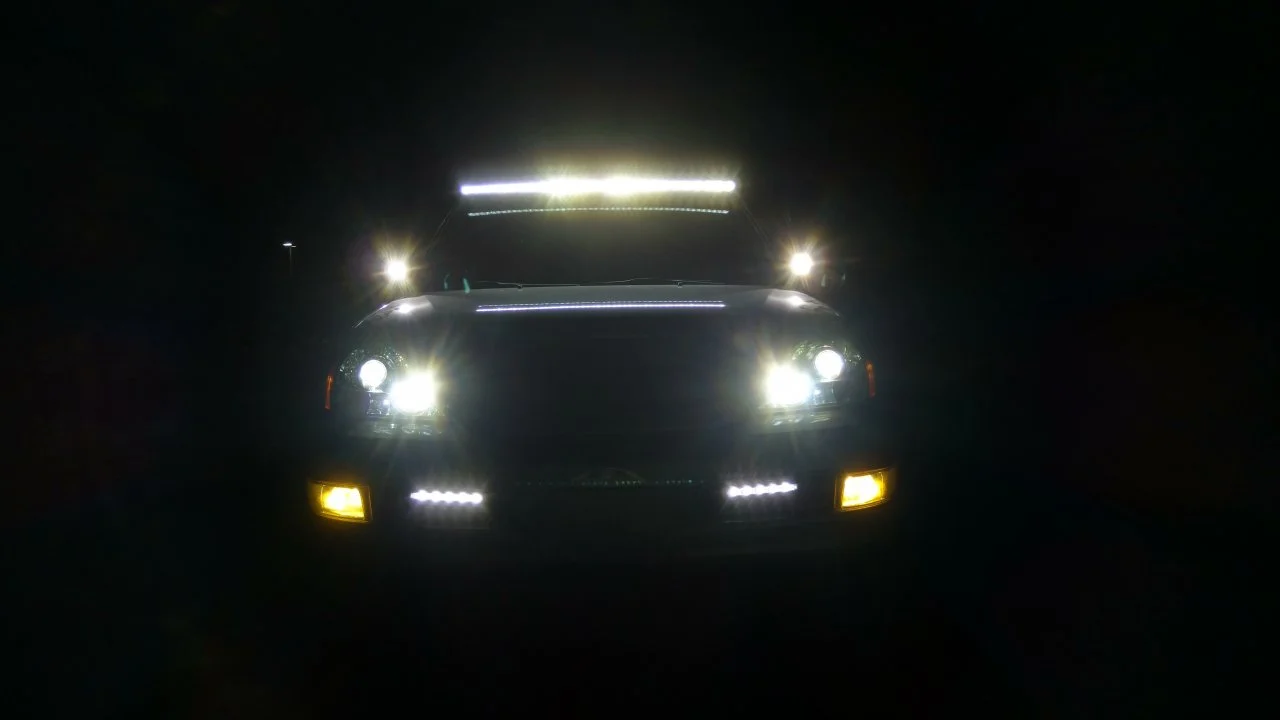

Installed a set of CBI ditch light brackets yesterday. Had to modify them ever so slightly so that they would not contact the base of the windshield. Easy to do just took a grinder and noticed out and radiused part of the brackets. Then I installed a set of KC flex lights on the brackets. Love the look.View attachment 1329655 View attachment 1329656 View attachment 1329657
What size/brand light bar are you running? What about mounts? Also do you have a link for the small bumper LEDs and the ditch lights?

It's a 50" radius single row bar, it's not a brand name, but preforms just as good as my friends 40" E series rigid bar. The mounts are custom made one off mounts. The rear bumper lights are from eBay I think. They are all the same, I think I paid like $30 for them. The ditch lights are KC flex lights, in spread pattern, awesome little lights! The Mount/brackets are from CBI OffRoad and are for a 4th gen 4runner.

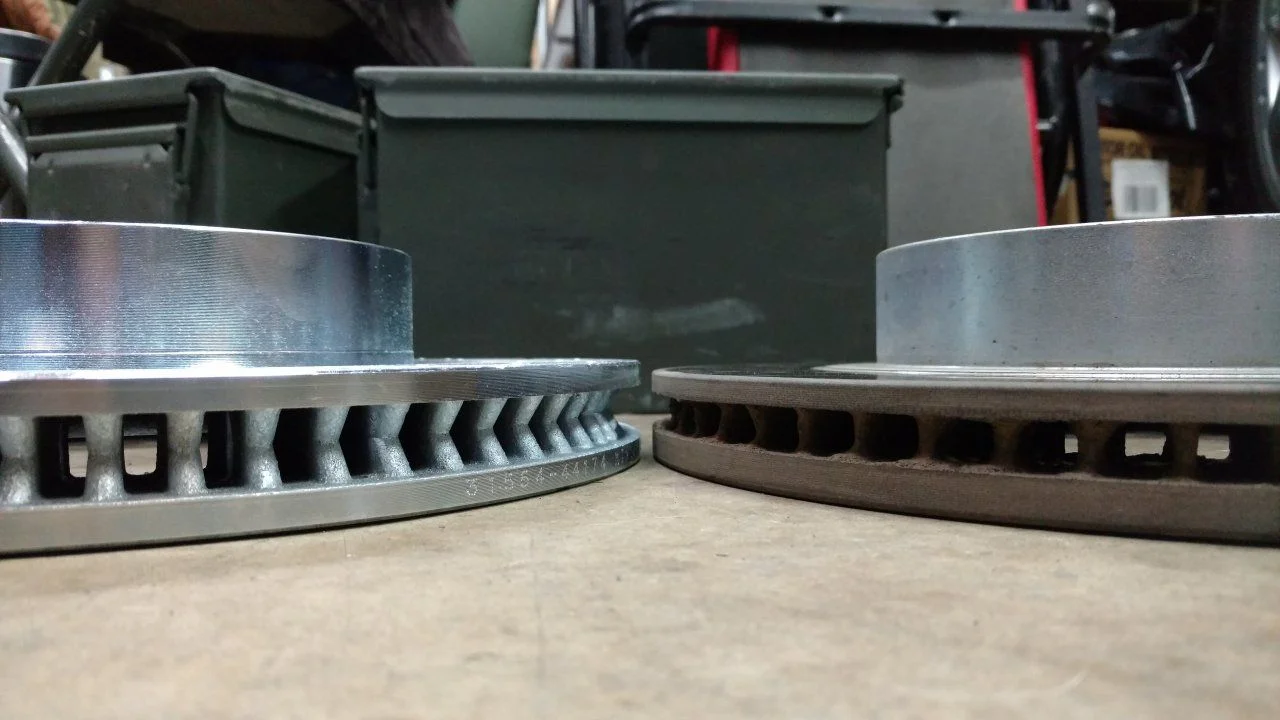

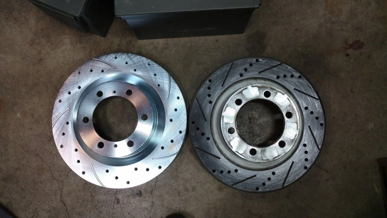

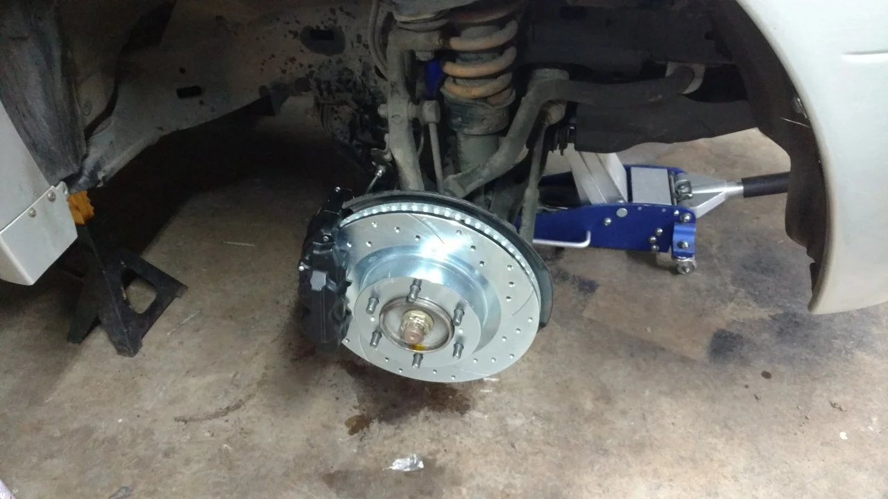

Well yesterday I finally got around to doing a project I have known about and been wanting to do probably from within the first couple months of ownership of the GX. I swapped out the front brakes for the brakes for a 2014 4runner. The calipers on 4th gen 4runners and GX470s are known for seizing and causing issues. So I started buying parts, started off with a set of new calipers from NAPA auto parts -rather hard to find, had to get them all the way from the east coast. Then I sourced a set of performance rotors from LC Engineering (had already been running their rotors for a 4th gen). The pads remain the same, so nothing changes there, but I did put in Akebono pads who makes Toyota OE pads.
Had some issues with my hard lines out of the calipers coming off, so I ended up breaking them and having to go down to NAPA and buy two new sections of hard line and bend and make my own lines -this to longer than everything else.

Like to know how you like the brakes? Why didn't you do the Tundra brake upgrade?
