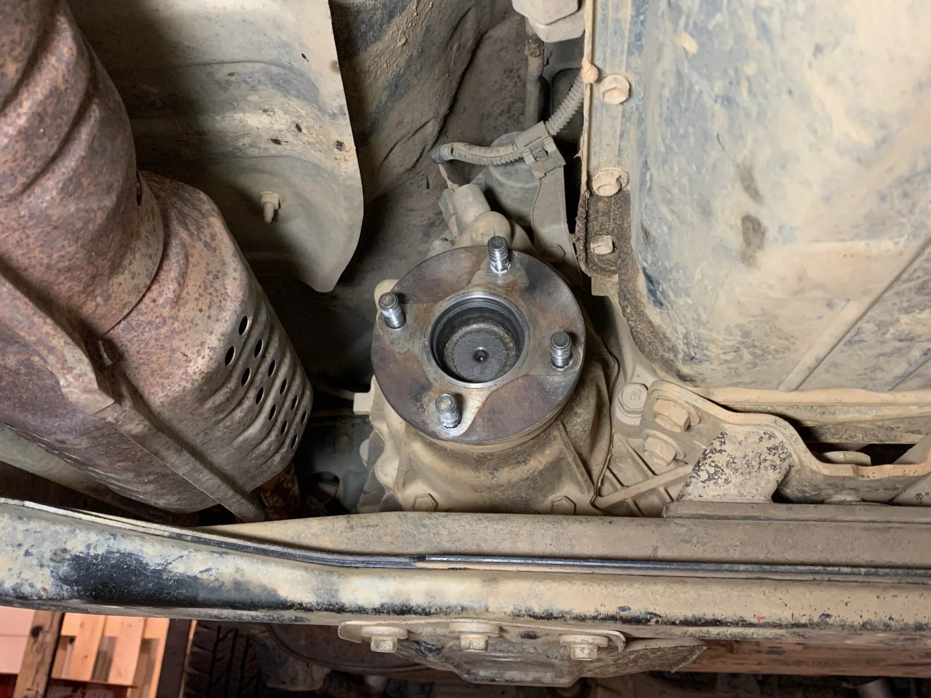

Actually, installing the drive flanges, locking the center diff and driving will tell you more. IF you still have the noise (front diff being driven by the wheels) then you'll need to investigate there. IF no noise....then odds are the drive shaft work is going to solve your issue.
Back in 20!
All noises are still gone after installing the hub flanges! Got it up to about 40mph, accelerated up steep inclines, turned under power, all things that would previously provoke the clunking noise. It remains just as silent as it was while driving with no hub flanges so that seems promising!
Any other troubleshooting steps I should take while I’m at this point?
I would submit that it almost puts you in the clear. The front diff when subjected to forces generated by the engine, Tcase might still reveal a problem that turning that mass under relatively light loads would not expose. BUT....yes, I am hopeful you have found your problem and that the drive shaft/Ujoints might be the answer. Lets hope so.
I can't think of anything else you can do at this juncture, but anxiously await the results.
Edit to add: The reason I say the above is that driving with the driveshaft removed (drive flanges in place) you turn the front diff....BUT the pinion gear is being driven by the ring gear instead of the other way around. When the diff receives power from the driveshaft you'll have more force involved.
The pinion gear tries to climb the ring gear but is held in place by the diff housing, that is a different force than what you applied driving with the drive shaft out. But hopefully....you are in the clear.

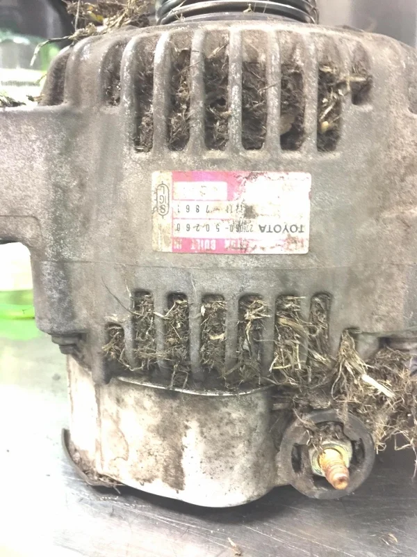

Just a quick note: #1 skids are important. Without, we get a lot of moisture and road dirty/mud/sand into engine compartment. Sure way to reduce life of alternator.

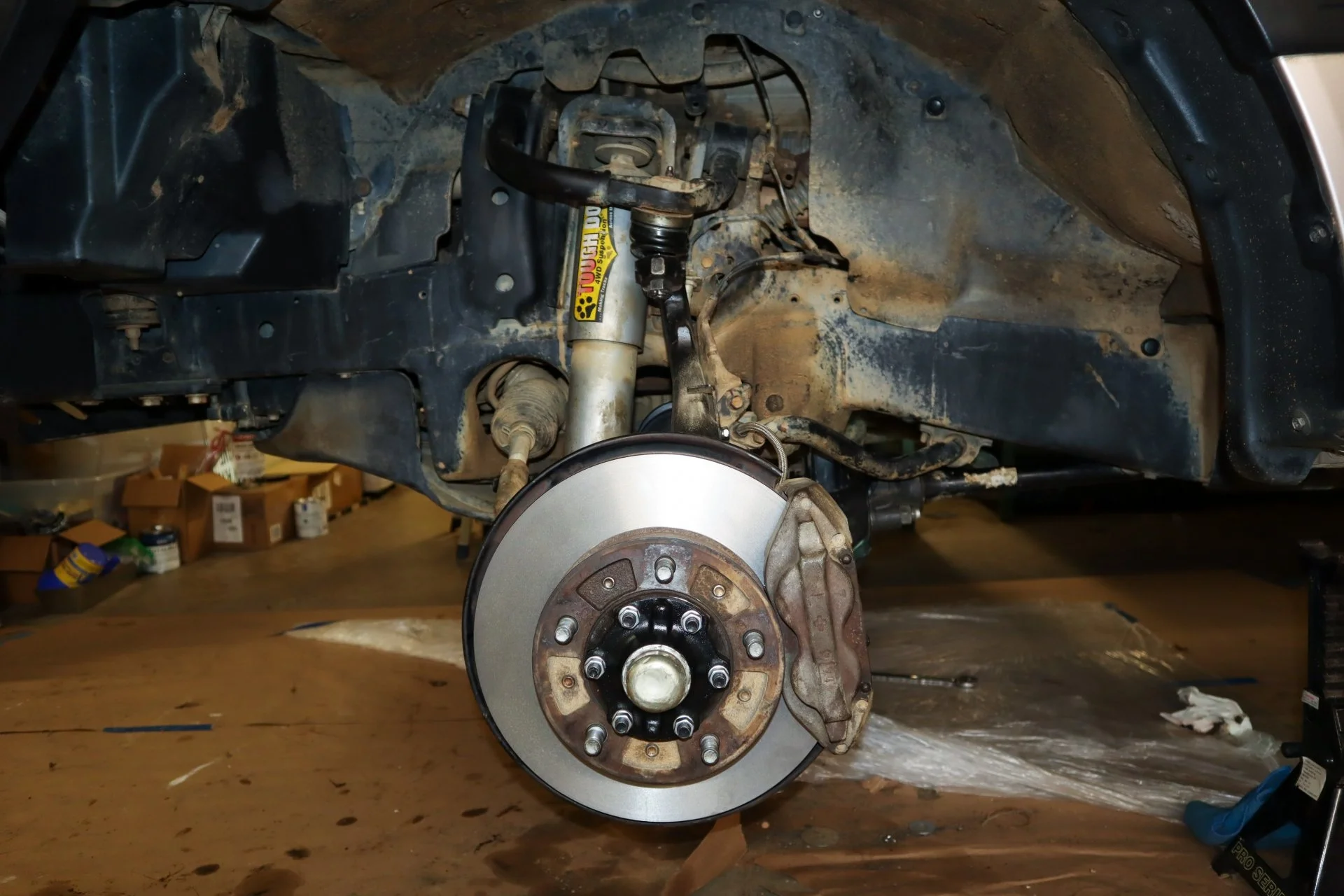

Agreed! I pulled it off in the beginning when I removed the axle to give me more room to work. Since an issue is still present I have just kept it off so I can get a better view of things. Since it was a rotational noise I wanted to make sure there wasn't anything coming in contact with an axle or driveshaft and that's easier to do with it removed. I do plan on reinstalling it when I get the driveshaft reinstalled!
After I get all these issues resolved I plan on backing out onto the driveway and cleaning the entire undercarriage. I drop the spare tire, remove all skid plates, and roll around on a creeper scrubbing everything with simple green hah!
I saw a lot of fresh looking mud in engine bay pictures, and no #1 shield! So I was thinking you ran without.
But perhaps it the missing inner fender skirts. Some guys w/lifted use rubber extenders.
Yeah, you gotta love where Toyota chose to put the alternator on an off-road vehicle.
Skid plates/covers or not.

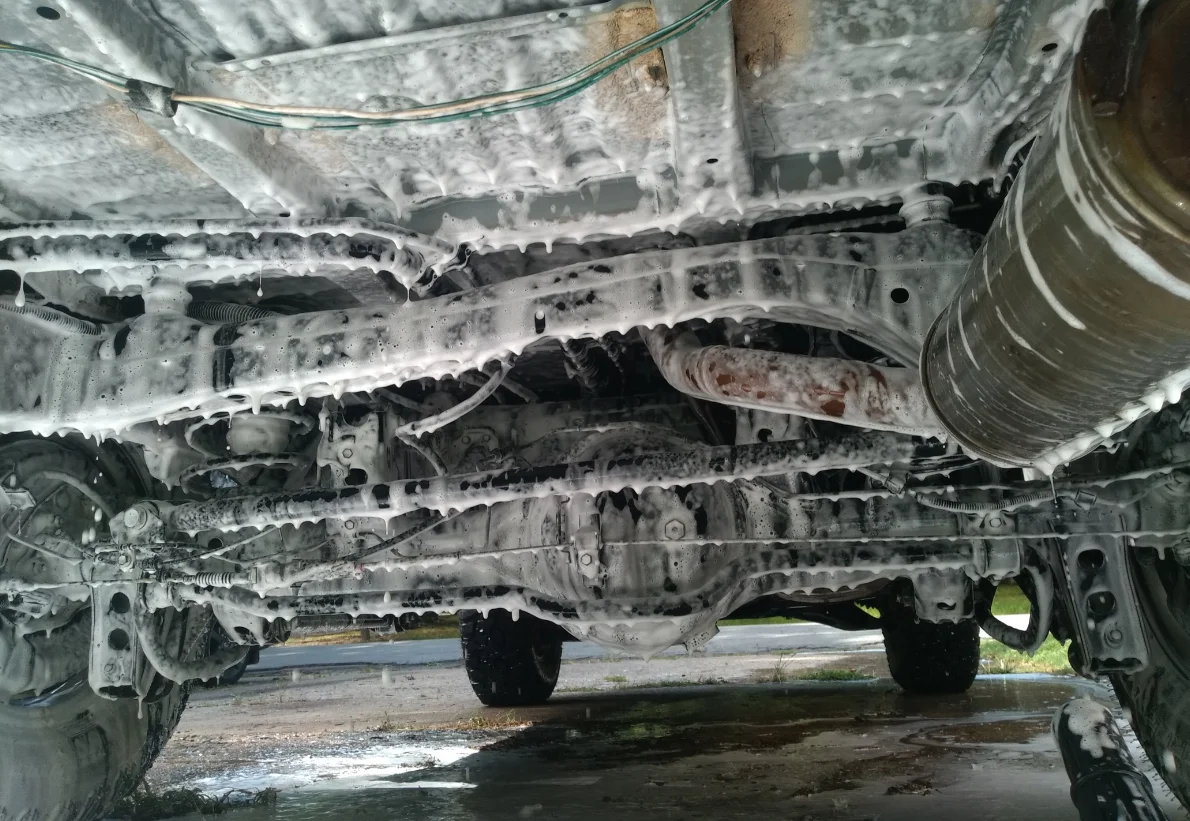

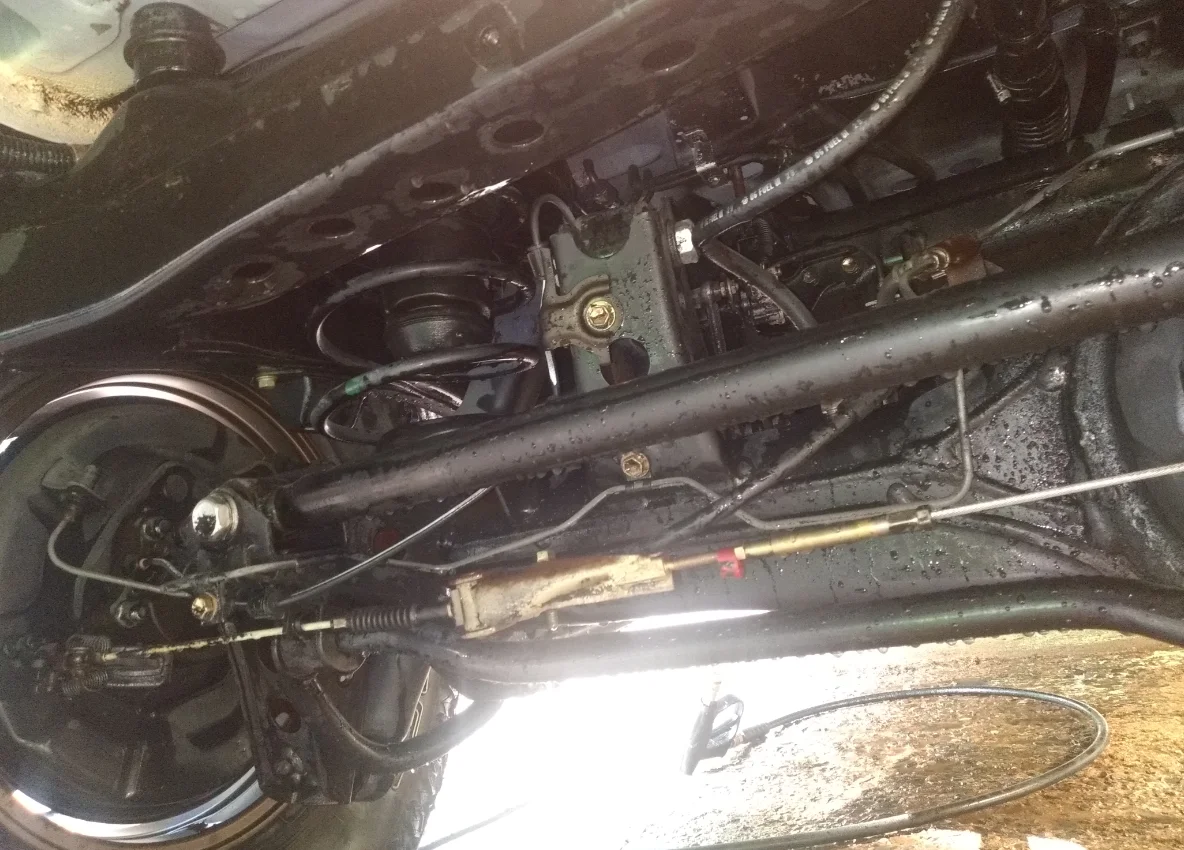

I'm still experimenting with using Murphy's Oil Soap with a pressure washer foam gun. It leaves behind a slightly oily residue that I like. I'm due to use it again soon.
Over the years, I've drifted away from caustic detergents. I was surprised how Murphys foams up and sticks when being dispensed with the foam gun.
I need to try it a few more times before I settle on it. Has anyone else used Murphy's for cleaning an undercarriage?
I used a pressure washer pistol that you can see in the picture to wash off the Murphy's foam. Makes it easier to spot problems when you can see hose condition and parts.

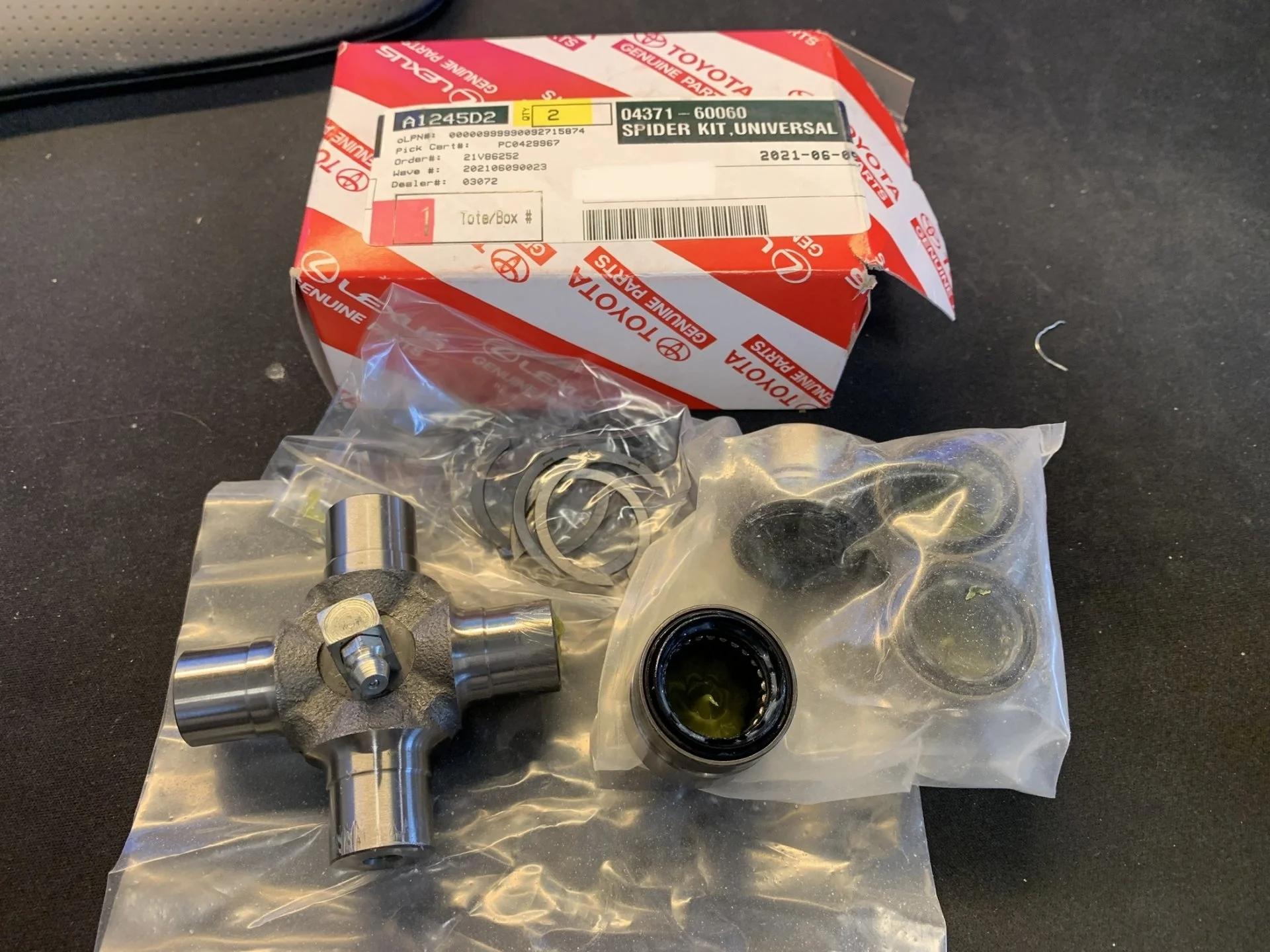

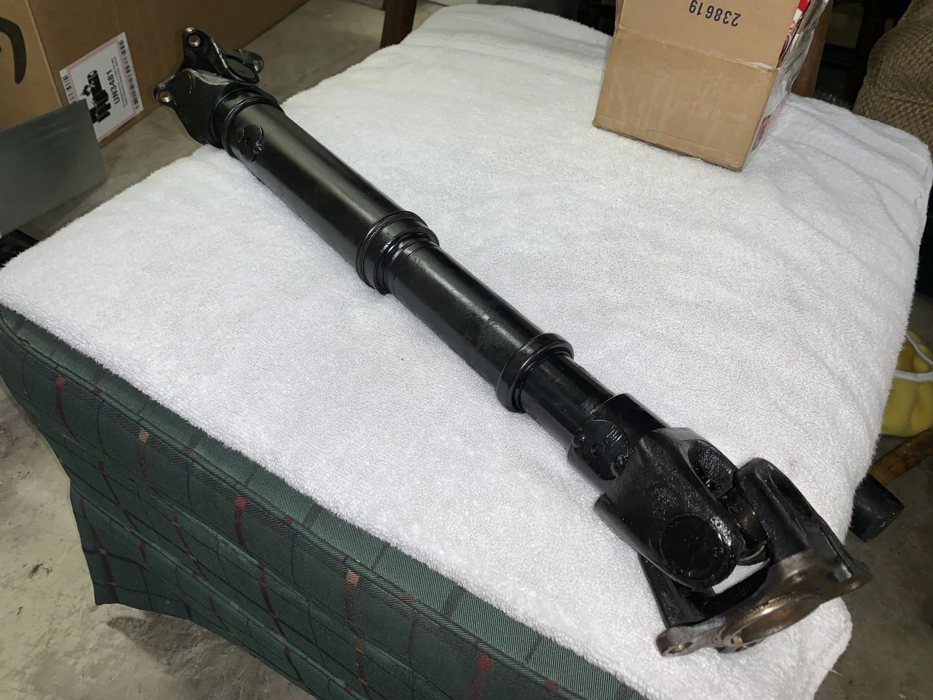

Driveline shop just called and told me these are the wrong u-joints for the front drive shaft...WTF?? I cross referenced the part number across this forum as well as a few parts websites and thought I had it correct. He said he removed the old ones and there's an obvious size difference between those and the new ones. Did Toyota package the wrong sized u-joints in this box or am I an idiot??

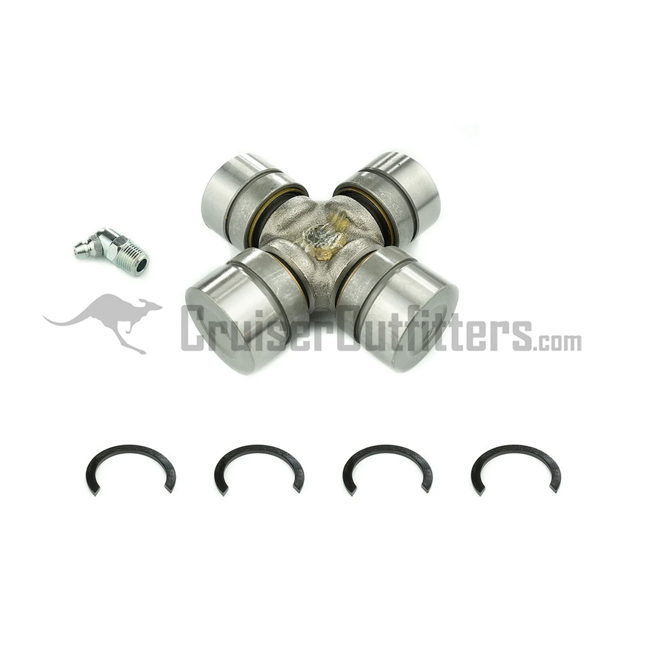

Taken from @cruiseroutfit website:
OEM Toyota Front U-Joint

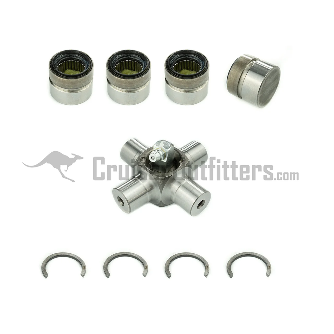

Matsuba Rear U-Joint:
The u-joint I received:
From what I can tell the center of the joint where the grease fitting sits looks much more similar to the rear Matsuba u-joint. I think I ordered the correct part number but received the incorrect part
Okay so huge thanks to @cruiseroutfit for overnighting me the proper u-joints! The shop got them installed and also cleaned the splines in the yoke and balanced it for me.

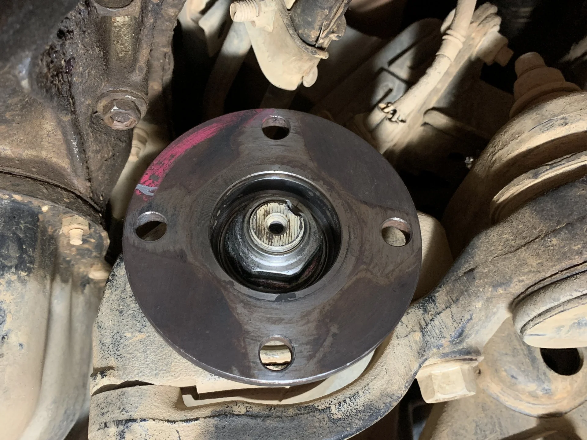

Finally got everything buttoned up. 62ft-lbs on the wheel bearing adjusting nut got me to 12lbs of preload. After torquing the lock nut to 47ft-lbs I’m getting readings right around 13.5-14lbs so I’m very happy with that. Used the “D” snap ring (2.6mm) leaving me with a 0.08mm gap. The handy CV Axle Puller Tool made it a breeze;)
