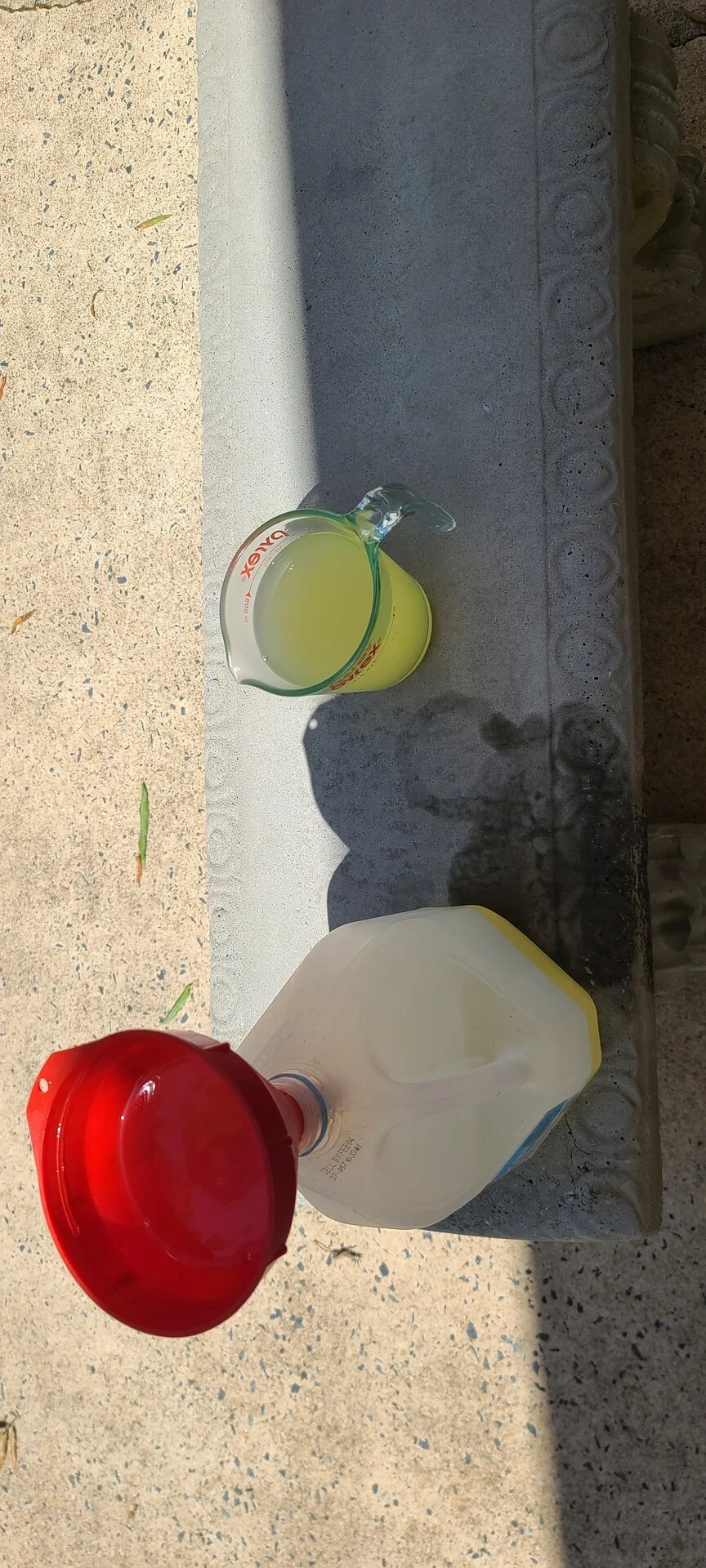

I wasn't pleased at what I found. These are the last 6 cups of "fuel" from the tank:
Yes, that is gasoline and yes, the funnel had been draining for several minutes when I took this photo. The previous 12 cups didn't look much better, but they did go through the funnel.
I had done this several years ago when I replaced my fuel tank bands, but obviously I need to do this more often. Like yearly, maybe. The gasket is $1.85. Retail. What's left in the tank may be good for an amateur arsonist, but it sure ain't fuel.

Why is that in there if you run your tank down to the fuel light on and then fill up? It looks like lemon-aide! Does it have to do with where you buy fuel and the climate that you live in?
To be clear, I don't always run the tank dry; I just did it this time because I knew I wasn't using what I drained out. I try to fill up when it's empty or nearly, or so.
To answer your question, I have no idea why it's so nasty, but that's exactly why Toyota designed the tank with a sump in it. The last gallon and a half is below the pickup. In areas where the norm is to strain fuel through your sock before it goes in the tank, the sump is where the trash resides.

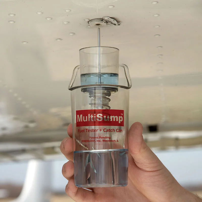

Same reason before flying (small aircraft) pilots check the fuel themselves to see (and remove) if any water has collected in the fuel system while it's been parked.

I'm sure the wife would not be thinking "chicken soup for dinner tonight" if she saw that in her pyrex jug :lol:
It's my Pyrex cup; I recycle them when the dishwasher eats the marks away from the outside
