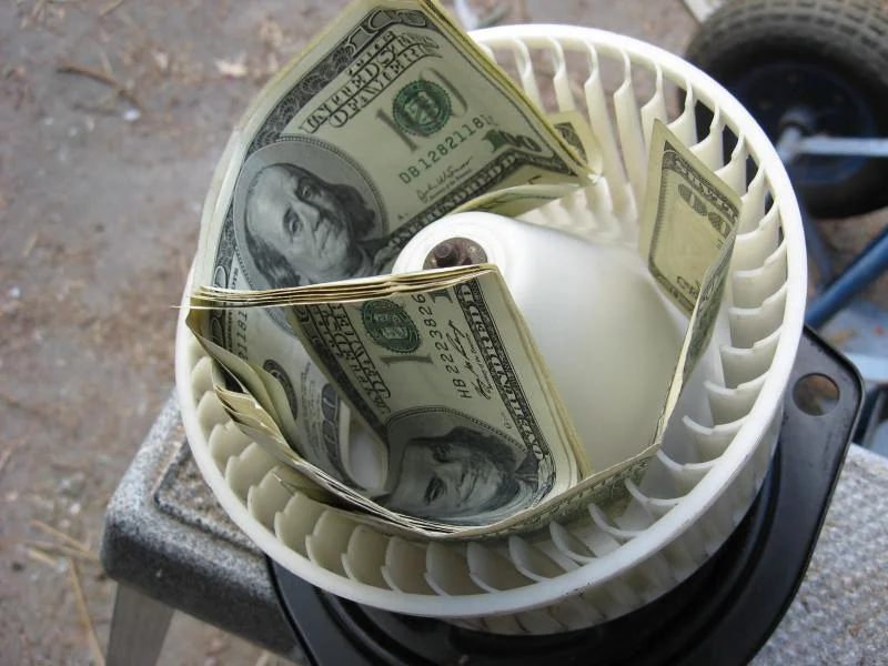

Well, wadddya know - Took mine out and look what I found:
At least now I know where all that money I threw at her went !!!
Woooo Hoooo ! Hooker Money !!!
Be glad that she saves it up. It's clear she doesn't have a hole in her hand!
