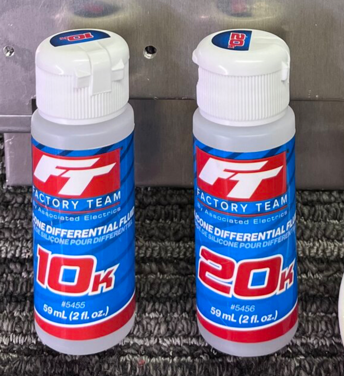

It’s easy to mod yourself. Aisin FTC-049 is adjustable and available on Amazon. Also order up some 10 or 15 weight silicone oil. I got some online from a RC hobby shop (pic below).
The factory oil is something like 5 CST. I used straight 20 but I live in phoenix and the fan locks up hard all summer, which works great. I probably wouldn’t use 20 if I lived anywhere else.
