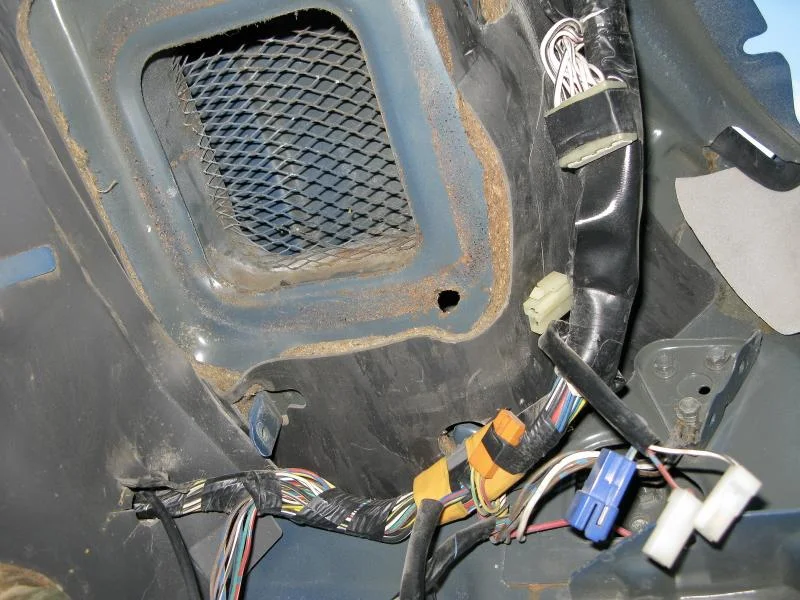

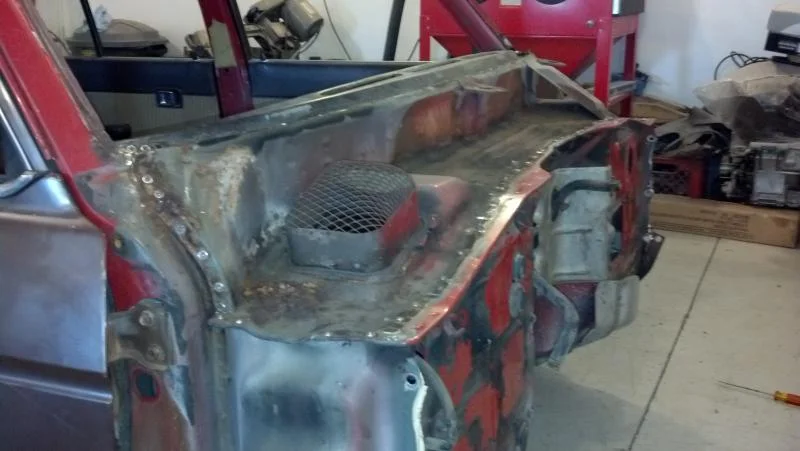

Check the fresh Air intake screen in the Cowl, behind the wiper motor (LHD). It's often very occluded.

1. I’ll check the intake below the cowl.
