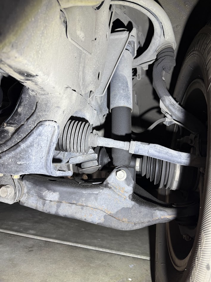

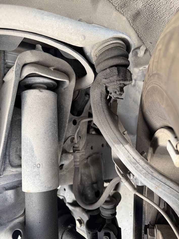

I would de-grease the entire area and then watch to see what gets wetted again.
Looks like your shock absorber may be leaking. And possibly the inner CV boot.
Check the ball joints for play, and integrity of the ball joint boots.

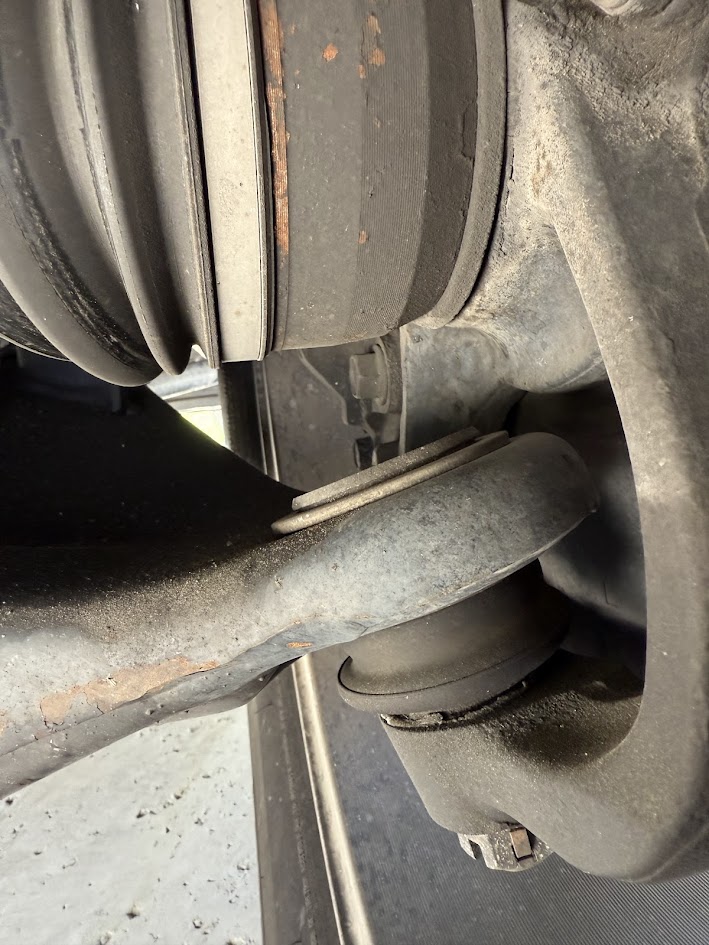

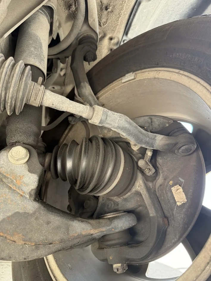

Hello friends, may i please ask a question related to the suspension. Should, I replace the UCA and LCA? Or Replace the ball joints? ( not enough info i can find it here on replacing only the ball joints) or reboot the ball joints (saw this process here as well)? Based on what i learned, my understanding is that the OEM ball joints are not available for sale so you have to replace the entire thing.. with current sale, 25%, on parts at the toyota dealership, all 4 ( 2 UCA and 2 LCA) are about 1100$. So wondering what to do here... i know I have to replace the shocks and reboot the CVs ( although i dont see anything torn just grease spewing out from them). Just trying to get all the parts possible to base line the suspension, your expert opinion/advise is appreciated.
Please see the phots i have taken of the UCA/LCA - might give you an idea what i am working with. thank you.
According to your first post, at 110,000 miles, it is not likely that your ball joints have failed… But it’s not impossible.
Why do you think your ball joints have failed? What symptoms does it exhibit?
New Sankei 555 ball joints are 1/10 of the cost of upper and lower control arms. Replacing ball joints is not difficult, but it takes a few tools.
I would begin by cleaning up the area with degreaser, so that you know what you’re working with. Then, you can check the ball joints for abnormal vertical movement, or other issues.
Lastly, from where are you sourcing OEM Toyota parts at 25% off at this time of year? I am genuinely interested.
Thank you for the input. I am not able to tell ( not that expert ) if the ball joints have failed.. i only see a lot of grease in those areas... the only think i can say is that i feel the steering has a little bit of play ( i think) though my comparison is with LC200 steering which is a lot heavy than the 100. Toyota of Decatur has 25% of and today is the last day Genuine Toyota Parts and Accessories: Official Online Store Serra Toyota of Decatur - https://autoparts.toyotaofdecatur.com/ . Also, does anyone know the part number for the CV reboot kit? I will be order the OEM shocks and CV reboot kit from them today.
