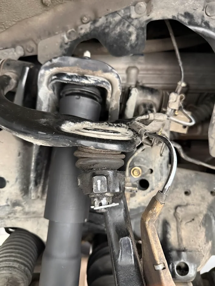

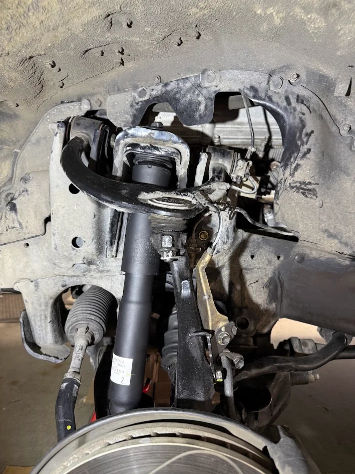

May I please have your expert advise: I replaced the front shocks and noticed that the UCA on the driver side looks bit off compare to the one on the passenger side. Also, after replacing the shocks a slight lean towards the driver side is still there, i was hoping it would corrected after the bad shock is replaced. I have attached two pics, both of the driver side UCA, does anything look wrong here? Is ball joint the culprit ? Please advise..
You fix lean by adjusting the torsion bar.
