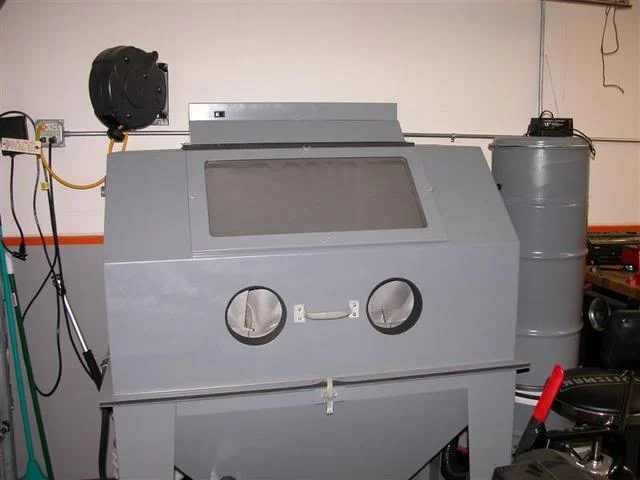

Econoline blast cabinet:
Picked it up used, rebuilt it with new internals, replaced the gloves/seals, and blew a quick coat of paint on it. Probably got around $600 into it. I replaced the plastic window with tempered glass, but still use plastic shields to keep from etching the glass. Buy the plasic in bulk rolls and cut it yourself. I actually take it to FedEx Office and use their paper cutter to slice it to size. You will be changing it often, if you do a lot of blasting rusty/nasty parts. The vac is a must. I also added a water separator.
Off the top of my head, I think it's 36" or so inside dimension (width). Probably 18" deep. Although the fluorescent light work fine, if it ever dies, I'll go LED. It has a 24 cfm gun, which takes a lot of air to run. I have a IR 7.5hp compressor with an 80 gallon tank, and it will cycle constantly during lengthy blasting sessions.
I normally just run Aluminum Oxide for media.
