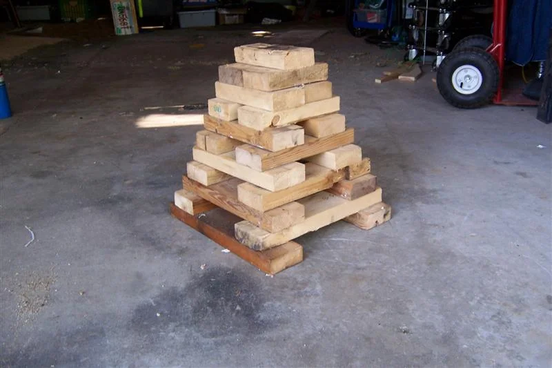

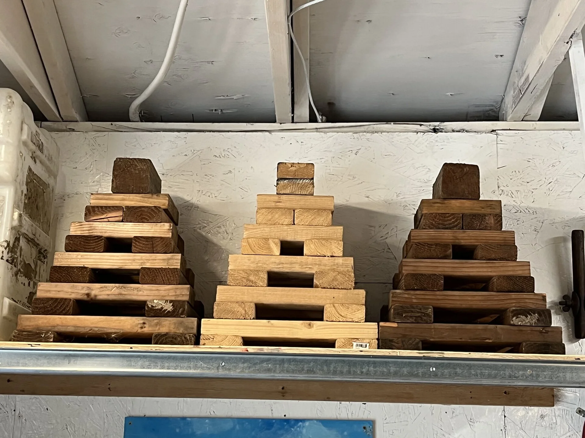

I use 2x4 jackstands. Screwed together, plenty tall and last forever.
Instructions here:
