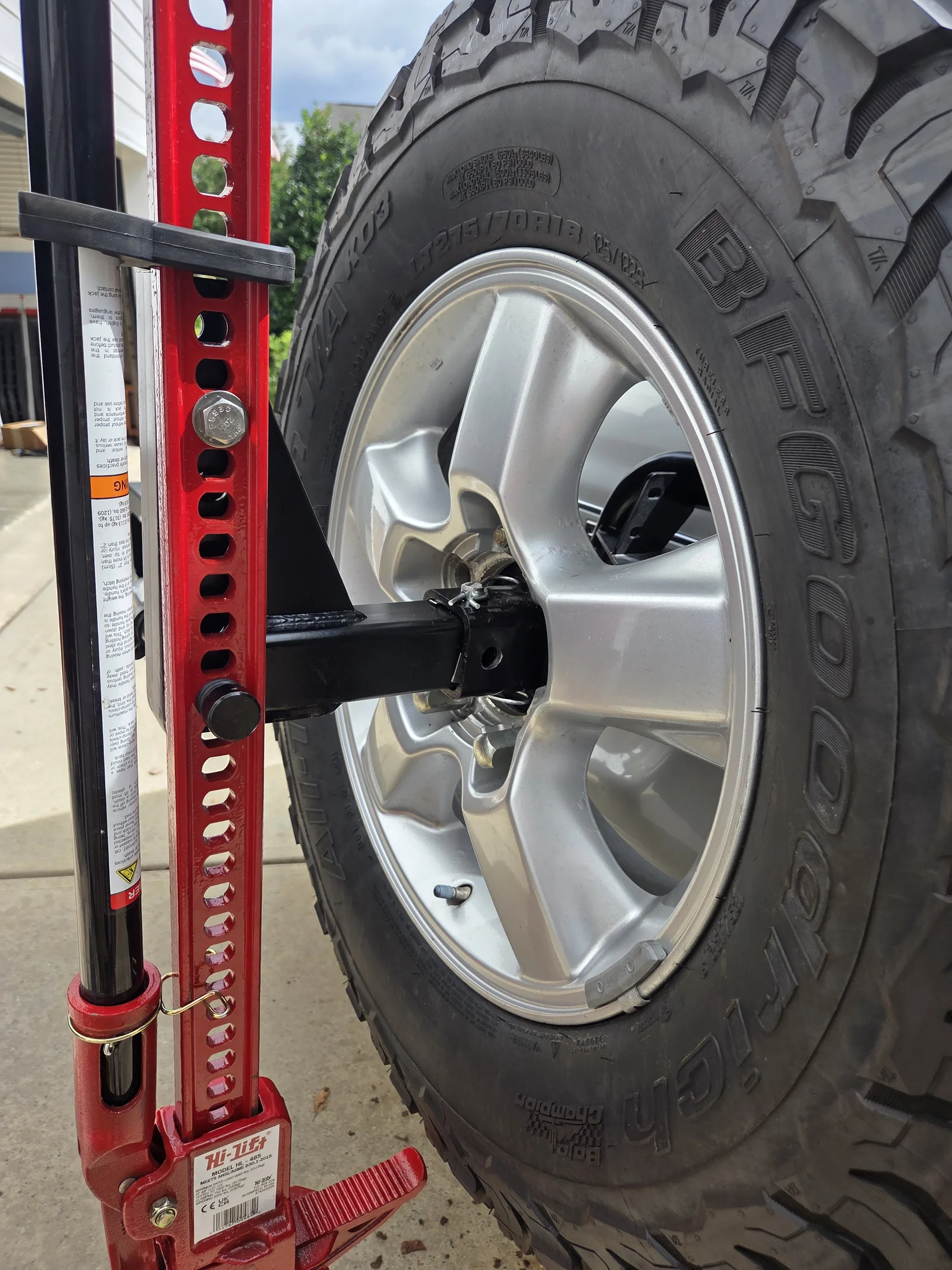

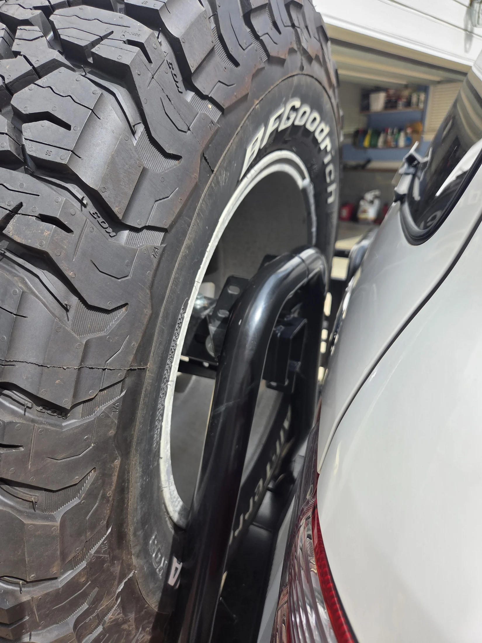

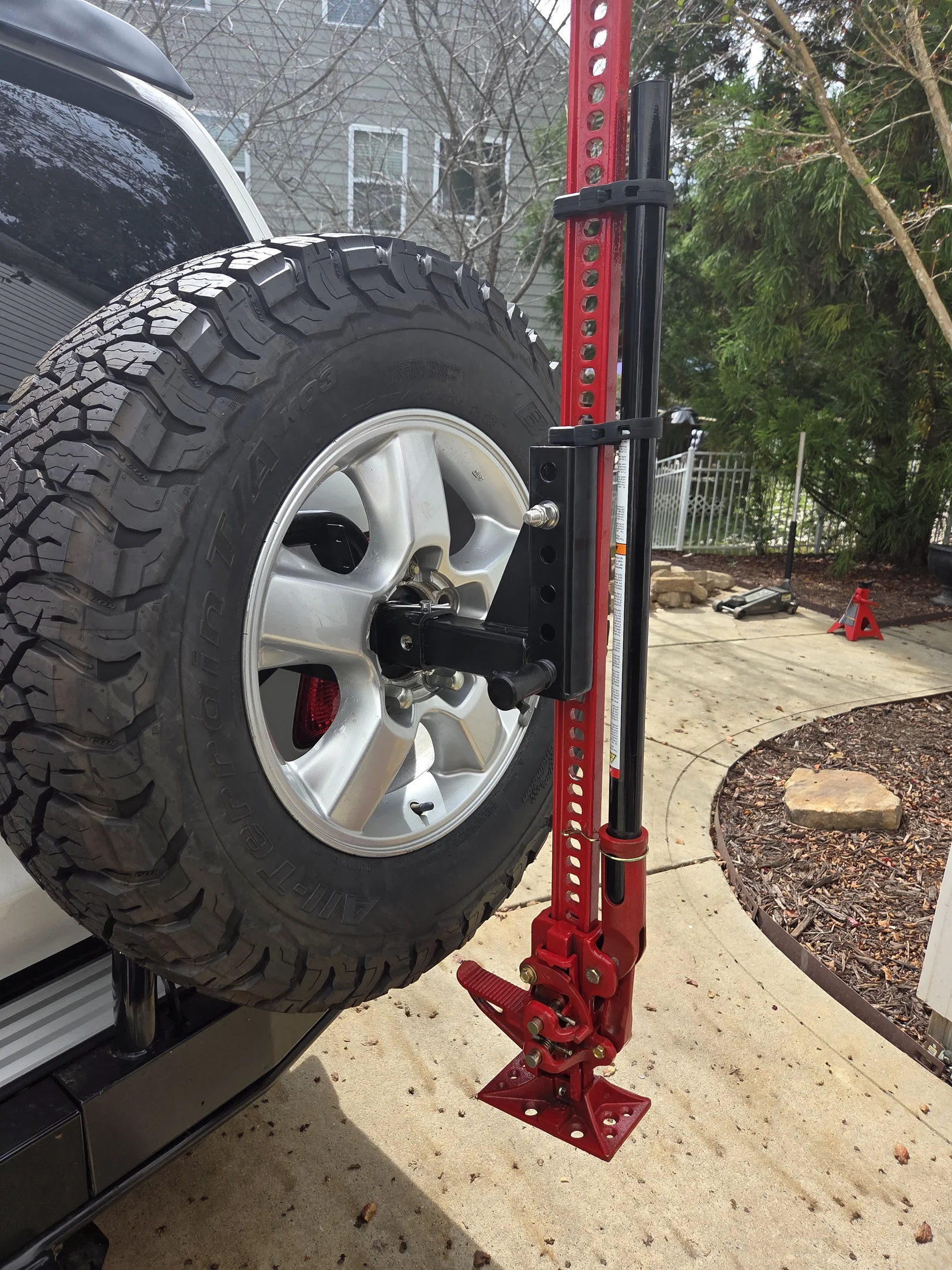

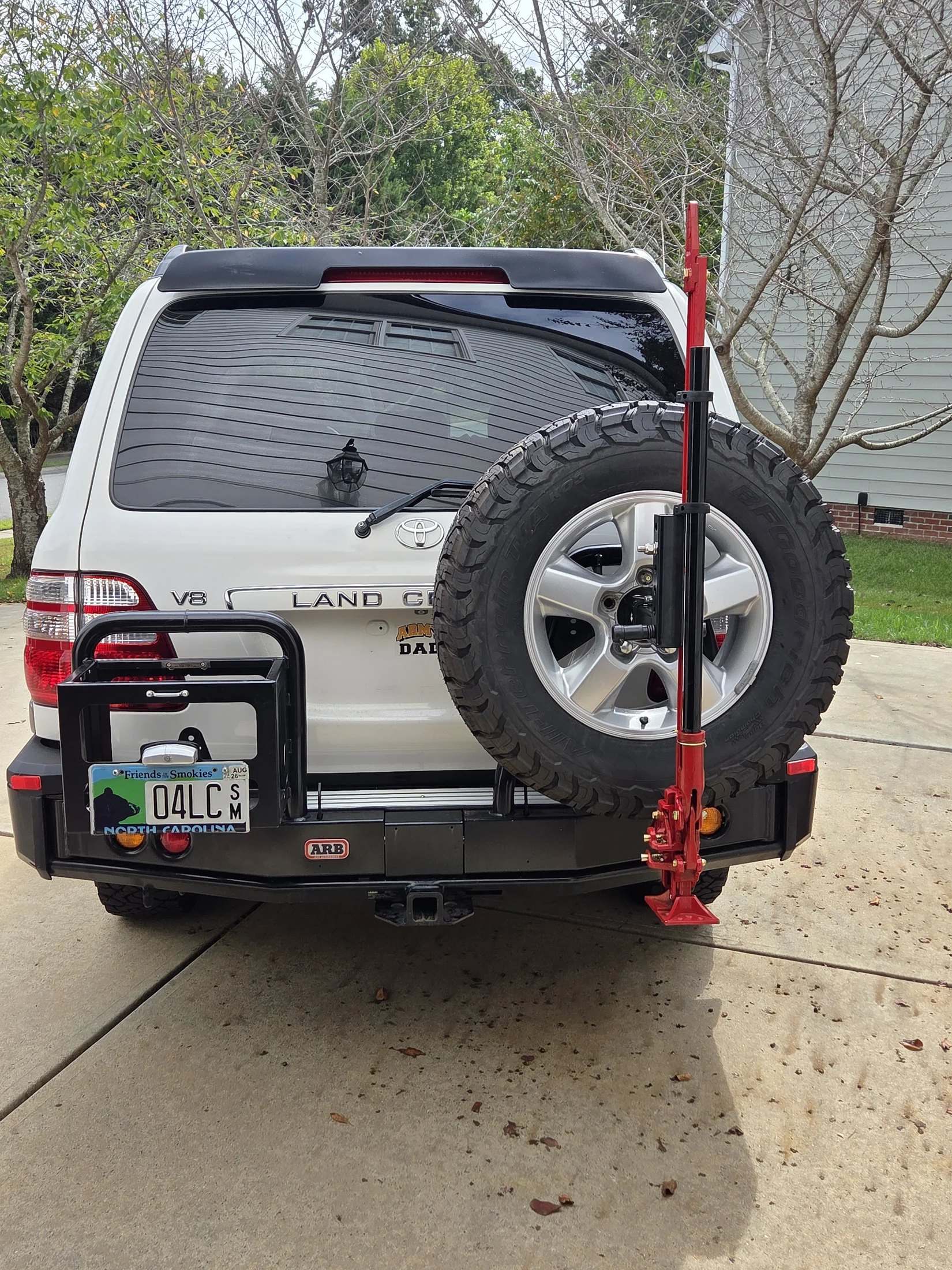

Trying to figure out the best spot to mount my 48" farm Jack. Tried the roof mount but couldn't get it in the garage. Looked at mounting it in the front bumper (ARB) but wasn't interested in a potential decapitation and really didn't like the look. Then I came across this solution that connects to my ARB rear bumper swing. What do you think?
I think if you ever drop down into a hole and the jack hits ground while moving forward you could end up with some significant damage.

I personally think it's sticking out too far, but it will very likely work.
Why not mount it on the side of the jerry can holder towards the tire?! 80/20 profile that fits into the trench of the jack, 2 bolts, done.
Or hide behind the box between the trunk and that A Frame of the jerry can holder. You could potentially transfer the lead directly onto the bumper instead of having it hanging and creating a momentum.
The ARB mount would work better. I would also relocate the clamp on the top of the jack to lower the profile and doesn't catch on anything. I find the jack useful for many things... just not useful for changing tires.
is the right turn/brake light visible with the tire on it?
X2 the additional weight hanging off the rack and the loss of clearance
