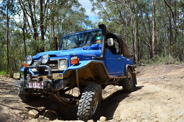

did some wheeling and took some vid..

Nice front wheel droop! :eek: :clap: :beer:
That's pretty darn good for a SUA set-up! Care to share your secrets?
Regards,
Alan
75+40 leaves up front with 10" bilstien 5100 shocks, 60+75 leaves in the rear with 10" bilstien 5150 shocks, rear hanger reversal, 1"longer than stock shackles, total 5" longer wheelbase
Add to that about 1.5" longer bump stops and hub spacers up front, 60 diff in the rear.
tyres are 34x10.5r16 ltb's
