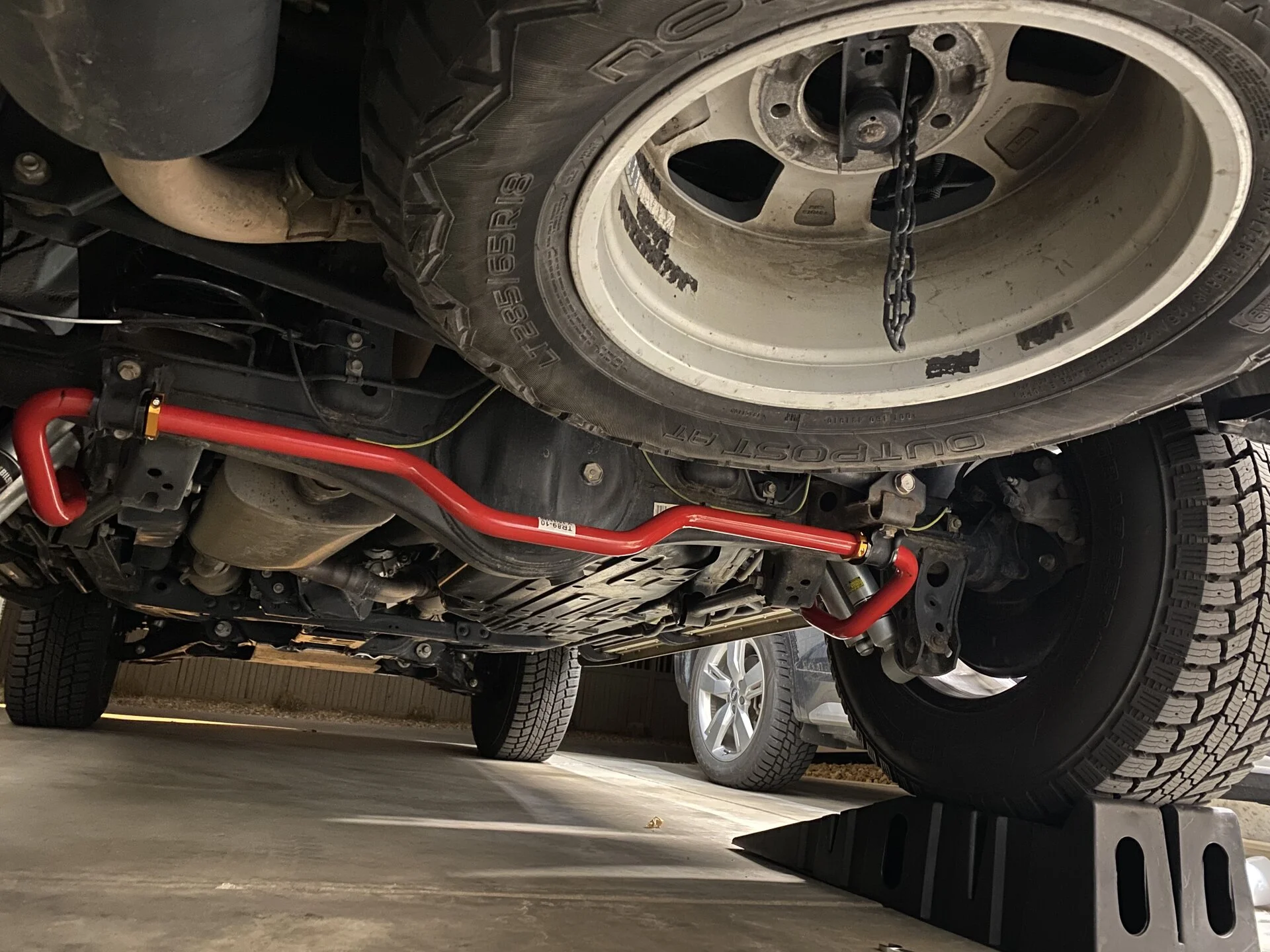

Nolathane 30mm RSB on my LX. Red gives more horsepowers, right?
How much of a difference does it make.
I did a rear sway bar on my F150 but it didnt have one at all from the factory. The difference was insane.
Not appreciably. At least not with the OEM AHC setup. @sedole is on aftermarket suspension which would maybe a different answer.
I've grenaded my rear sway endlinks effectively disabling the rear OEM sway bar. AHC still cornered surprisingly flat and had lots of control even towing 8k in the mountains. Where I felt it made more of a difference was not so much on road, but off-road where having no rear sway allowed the rear axle to be extra flexy to the point that the front end was lazy and not doing it's part to flex (to keep the overall rig more level) on articulated obstacles.
Like @TeCKis300 said I'm no longer on AHC so a result with AHC might be very different. But for me it made a huge difference. I use driving up I-70 here in Colorado as my example as I'm always making the trek. With the Bilstein suspension I'd compare the body roll amount/wallowy feel to having a loaded down rig in comfort mode (i.e. more body roll than just a single person driving in comfort mode). Totally driveable, but most would wish it would corner a little flatter and be bumping up into normal or sport--or just slowing way down. Driving by myself on the new setup feels like how it used to in normal mode. I'm back to driving up the hill much faster than I should haha. I-70 is not very windy as far as windy roads go but I'm back to taking the "windy" sections at 70mph comfortably whereas before the RSB I'd not feel comfortable even doing 65. I'd stick more around 55-60.

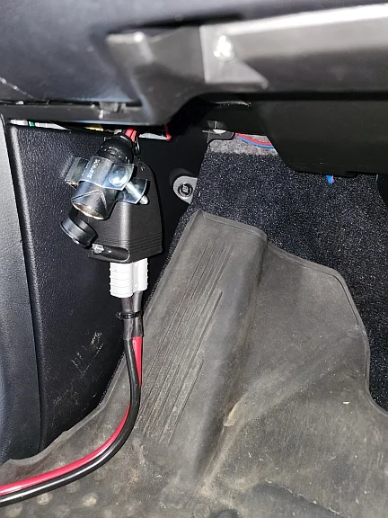

A while back I put an Anderson SB-50 connector connected to the starter battery at the driver's side kick plate so as to charge my Yeti Goal Zero 1500X while on the road. It was a hurry-up installation and held in place with velcro which wore out almost immediately. Well I finally got around to cleaning up the installation with a Powerwerx SB-50 surface mount housing (Powerwerx PanelPodSB for Anderson SB50 Series Connectors - https://powerwerx.com/panelpodsb-anderson-sb50-mounting-pod ) and added a plain old NoCo cigarette lighter tap while I was at it. I have the same thing on the passenger's side connected to the 2nd battery. It's connected to a 60A Blue Sea breaker (the one on the right in the 2nd picture below) in the engine compartment.
Last photo is test charging the Yeti using the updated setup with 450+ watts! :bounce:
Electrical-wise, I'm almost done with this truck.
60A breaker on right feeds the SB-50 at driver's left footwell.
500A relay and 120A breaker to left feeds the rear bumper's SB-175 for trailer charging.
EDIT for clarification:
Wiring and braid to 500A relay, 120A breaker and 60A breaker done by No Limit Baltimore.
Wiring & conduit from 60A breaker through firewall to driver's side footwell done by me.

The middle photo has some braided wire or cover. Where did you find that?
