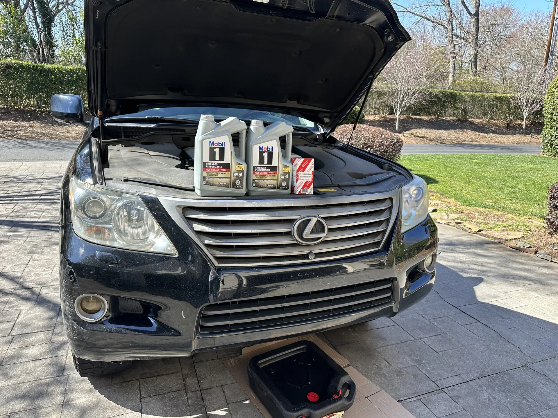

Boring Retroactive post for maintenance record keeping..
3/2/2024 changed oil
ODO 233,740
Mobile 1 fully synthetic extended performance
5w30
OEM Toyota/lexus filter
Once again that goodness for my bjowette and ezdrain
Finally my 60 was put to good use to keep the furry from getting in the way… oh u didn’t pick your dog to match your fleet? Oh wait I don’t but it’s great unintended coincidence good for pictures

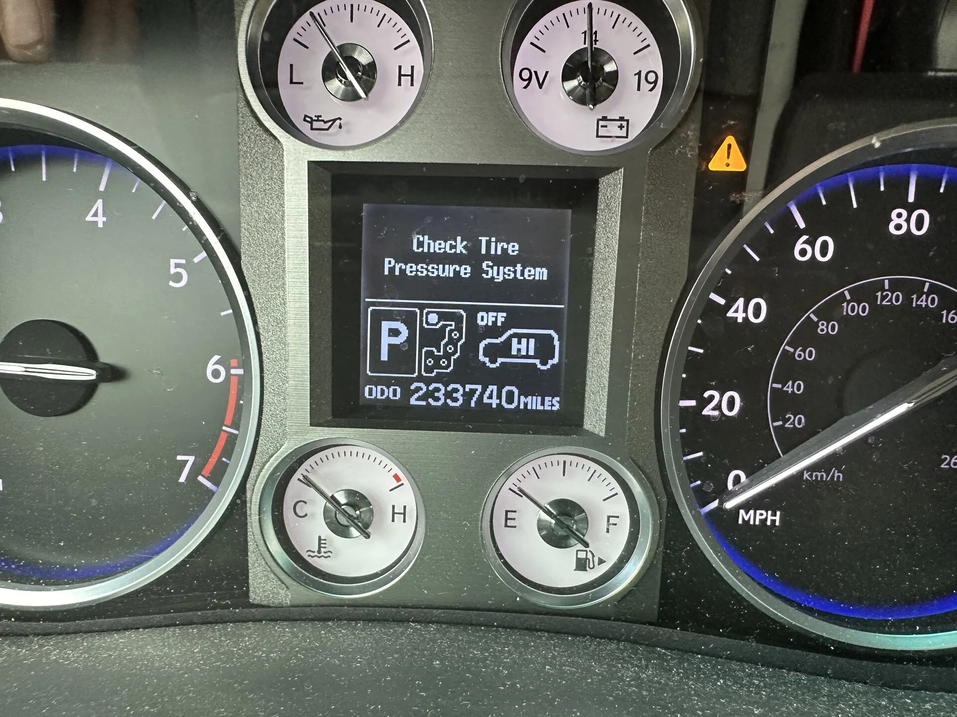

That dang tpms sensor light haunts me .. especially when in a public shaming environment

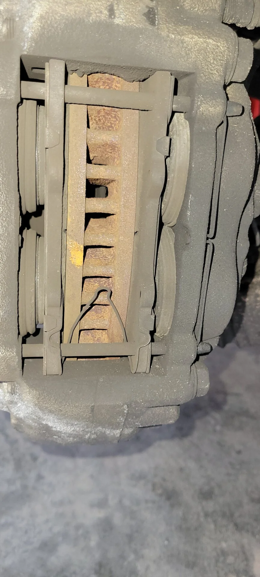

Going to have to send in my shocks for rebuild, knock out the front brakes, and relocate the rear shock resevoirs :rolleyes:

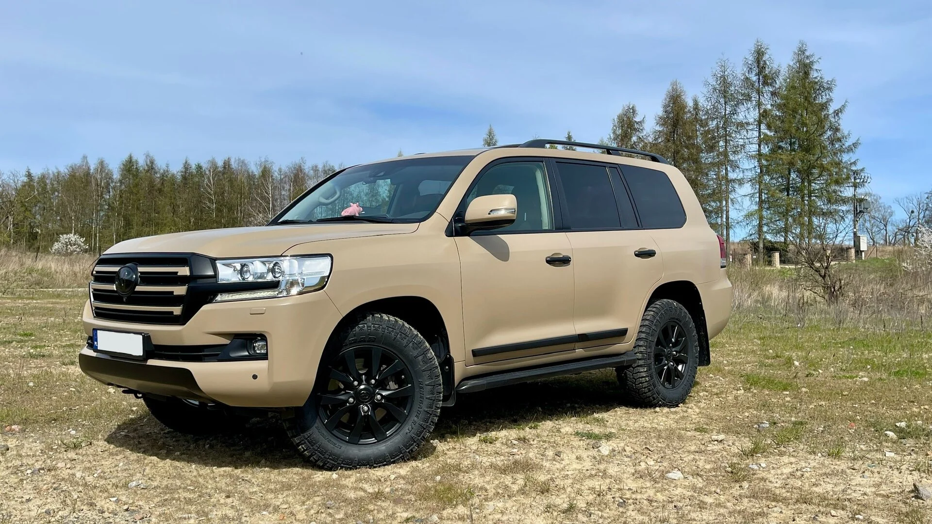

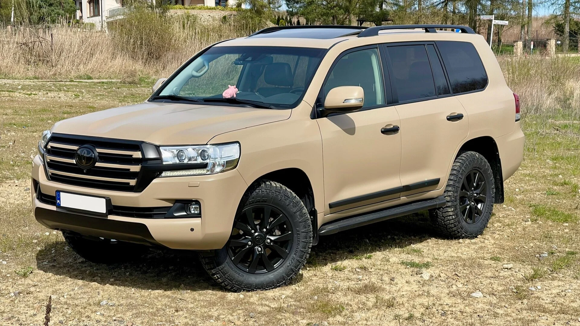

Hello everybody ;)

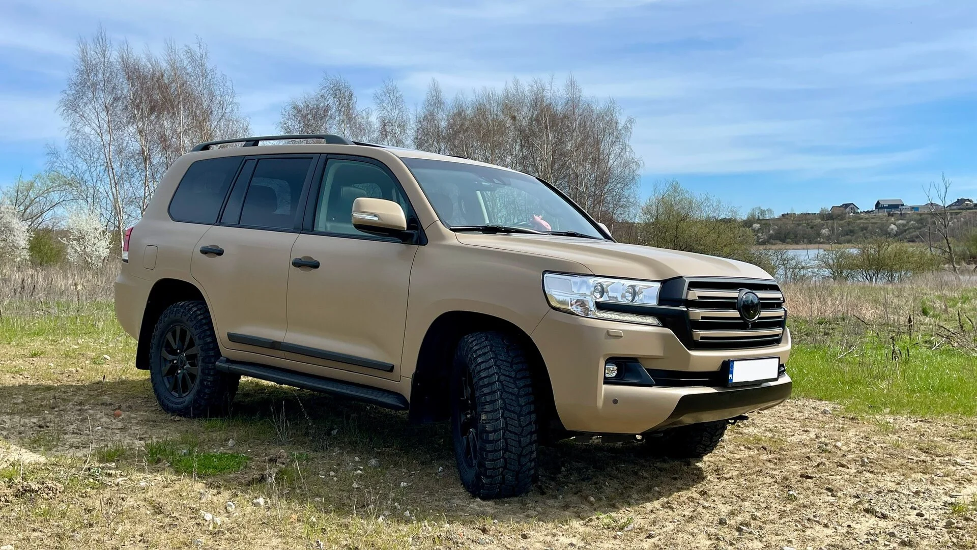

It hasn’t been a week, exactly but I’ve just collected my car from the wrapper last night and put on the new tyres today.
- satin wrap, dual colour
- alloys renovated and powder coated in satin black
- rear “LC” decor, rear logo and hubcaps painted satin black
- new tyres: Radar Renegade 285/65R18 RTs
What do you think? I’ve already have a little bullbar ordered, I’ll have a led bar on it. As we are in the EU everything added to your car must have a proper paper, otherwise you get fined… Heavily 🤷🏼‍♂️
Wow, looks great Adam! It’s a cool look; definitely one of a kind! How rare are 200’s in Poland?

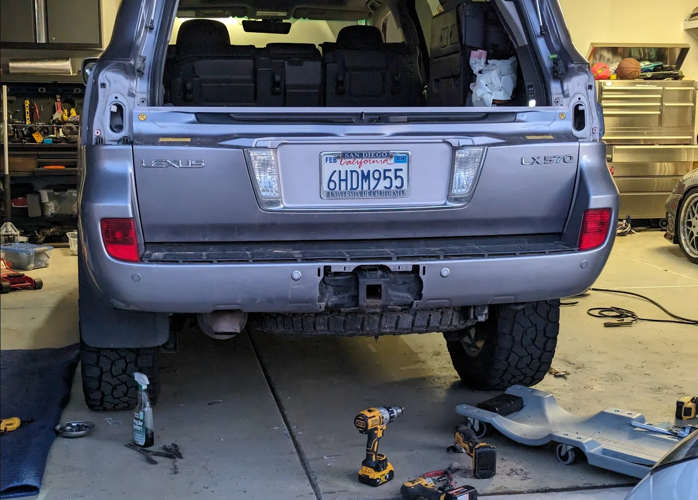

Old girl is getting a butt lift.
I'm starting to think that a mild body lift should be an integral part of just about any build. Something to be done earlier in the build. Much earlier, probably even ahead of sliders. Suspension lifts are great, but should be done in moderation to keep the suspension geometry in it's sweet spot (1.5-2"). With the rest of the lift being achieved by tires (1-3") and a mild body lift (.75-1.5").

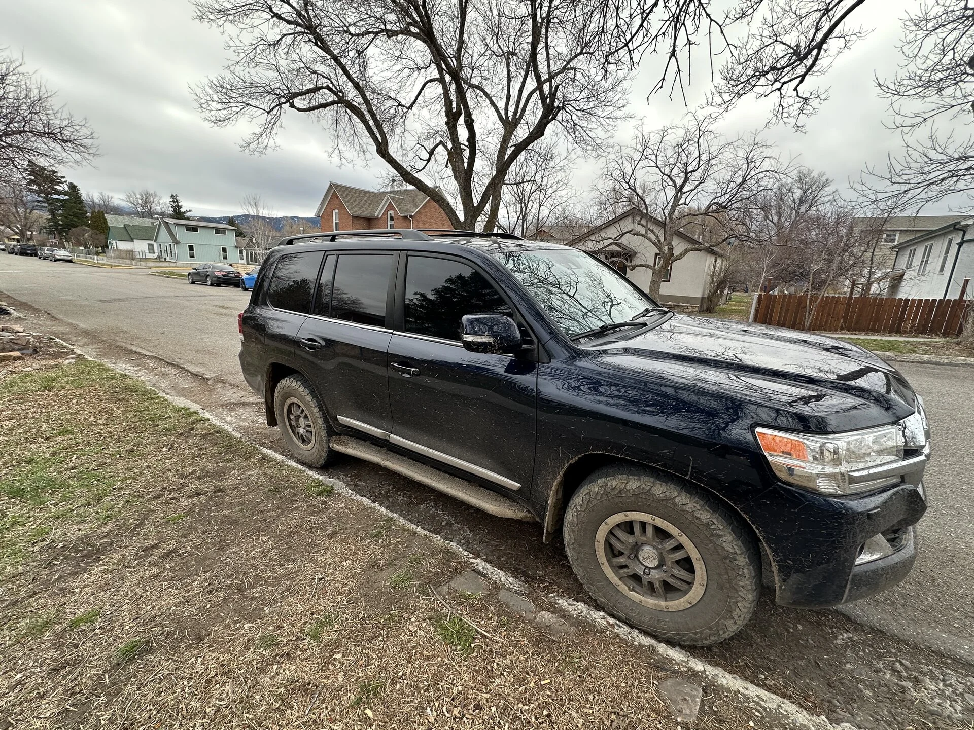

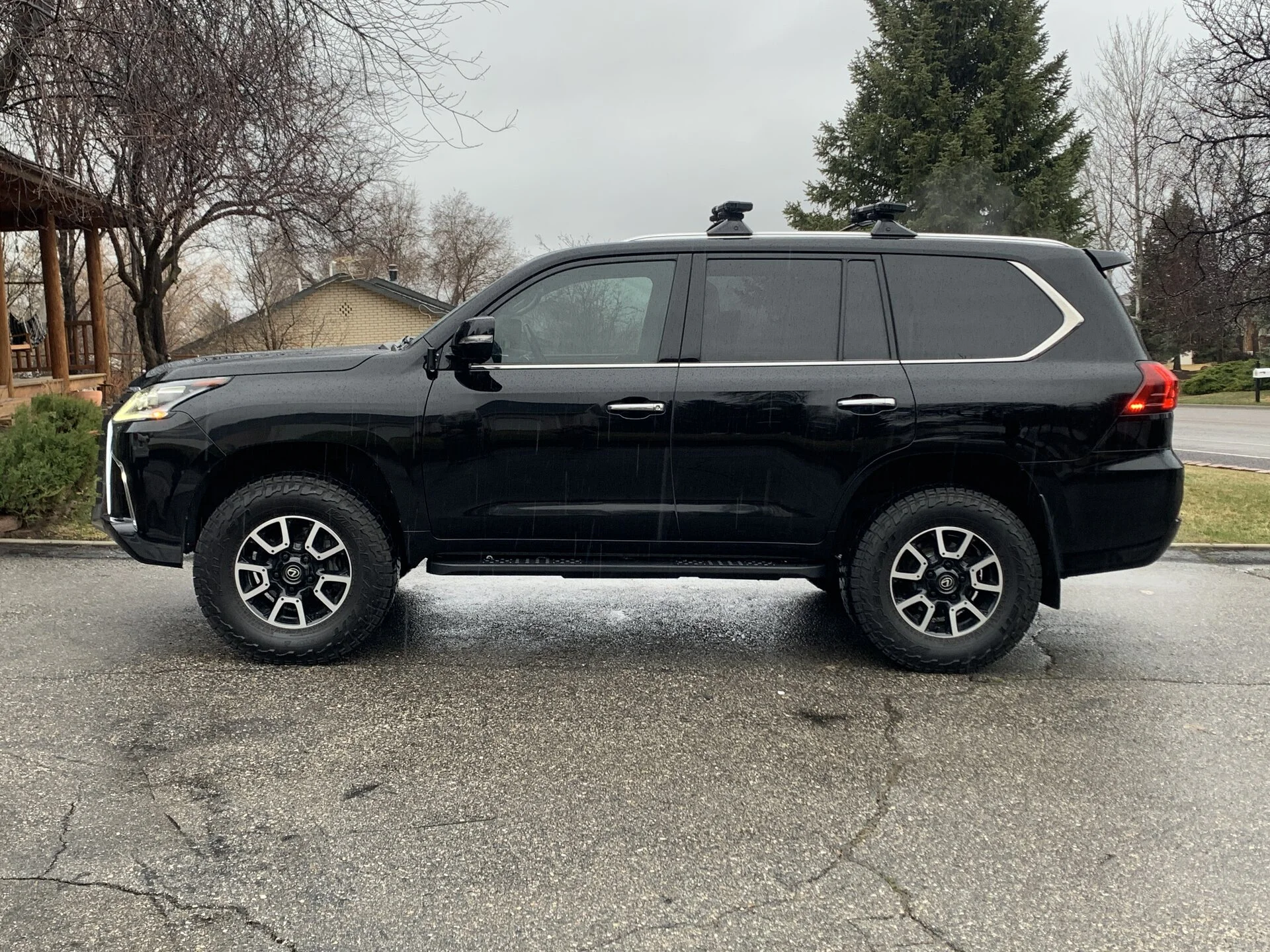

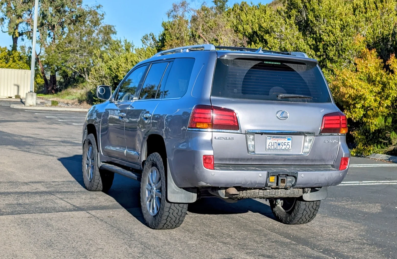

She's too dirty for a glamour shot so this will do. Butt and facelift complete. Really liking how the body lift is almost undetectable without unforseen gaps and fitments, but notably taller with more approach and departure at the bumpers. More importantly, practically zero change in drivability and handling! Fender measurements from the ground are 40" F and 42" R. Win win and I should have done this so much earlier. More to come in a dedicated thread later.
For those interested, @MTKID is going to have some ready made kits that will make this much easier.

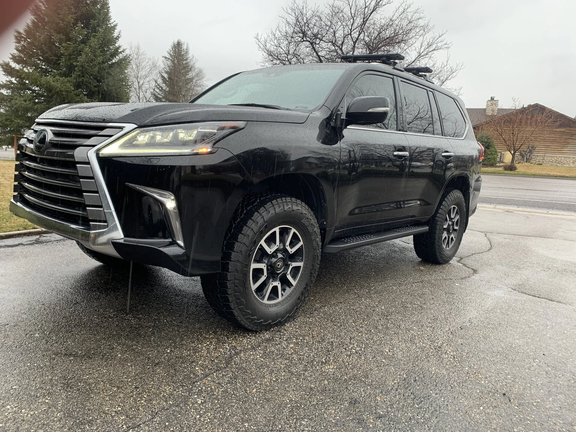

Congratulations, looks great! Also, glad to hear such great feedback on the BL.
Do you believe the BL would impact the installation of a hidden winch mount? I want to install the winch, but concerned if I do, the cutout in the bumper will not be correct once the BL goes on.
Thanks!
Yes, it will effect the alignment of the bumper to the fairlead. Definitely want to do the BL first. Same reason to do it ahead of bumper armor and potentially even sliders.
Thanks!
Yes, it will affect the alignment of the bumper to the fairlead. Definitely want to do the BL first. Same reason to do it ahead of bumper armor and potentially even sliders.
I figured as much. Too late for the sliders lol. Appreciate the feedback!
@turbo8 really helped me out with understanding my build and necessary parts. Thank you again! I just ordered his rear shock spacer, the panhard bar relocation bracket, extended SS brake lines f/r, axle breather extension, Perry parts bump stops f/r, and the SPC adjustable UCA. Just waiting on the BL now!

I never caught up. Does this not have impact to steering linkage?
At a ~1" body lift (mine is .75"), there is no concern to the steering linkage. Others have lifted higher with minimal concern. There is a hive mind looking into this ATM and yes, at some threshold, it would need addressing the steering linkage
