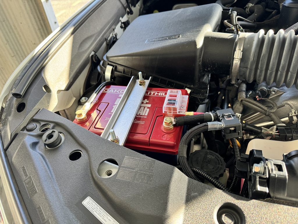

This 135AH lithium plus a Garmin Powerswitch on a 12voffroad bracket, a Victron battery monitor and a Redarc BCDC25 on the Redarc bracket in front of the radiatior. Now can run the Starlink, fridge and electric blanky all night. Wiring needs final tidy. All the charging wiring is 8awg fused at 40amps both ends; power to Powerswitch is fused at 125amps.
