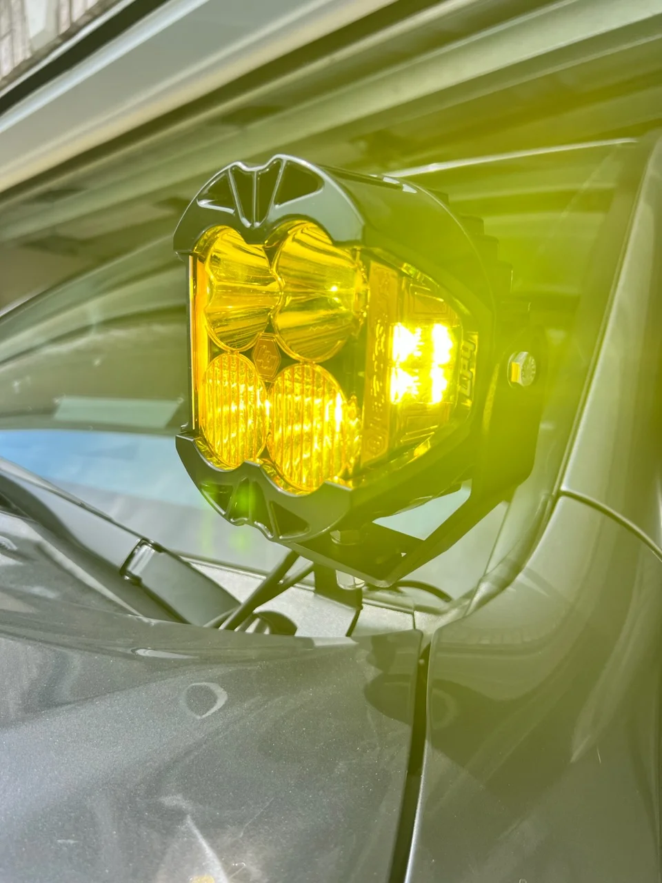

Not 100% happy with the CBI mount. Light leans forward too much and tilts outwards. Prefer it be more straight and leveled.

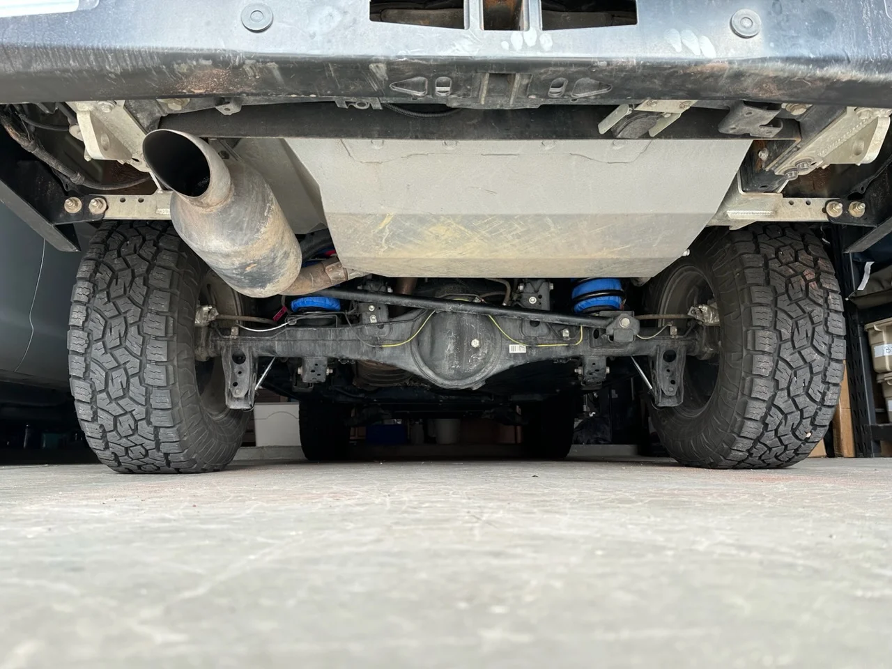

Took a step back down from the OME 2724 springs to the OME 2723 and added Airbag Man HP5051 kit.
