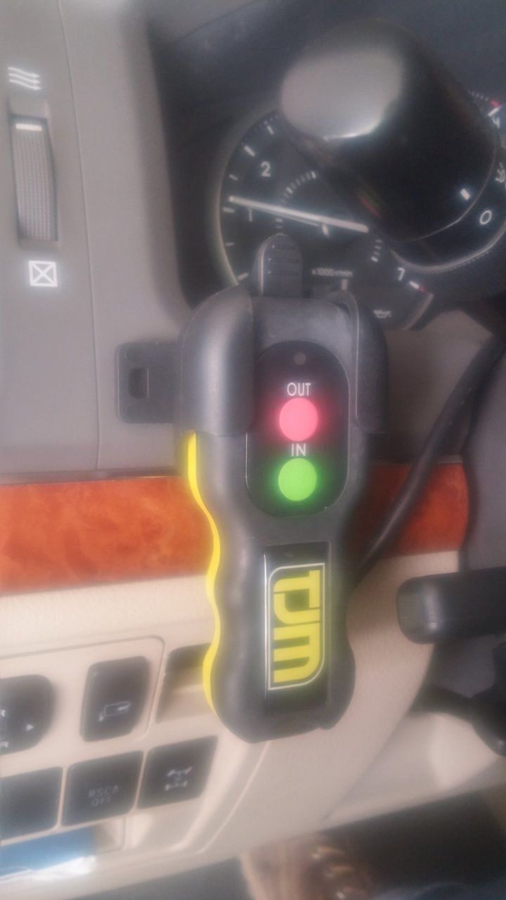

Also pic of the wireless receiver mounted in the bumper
Remote held with velcro on the dash.
