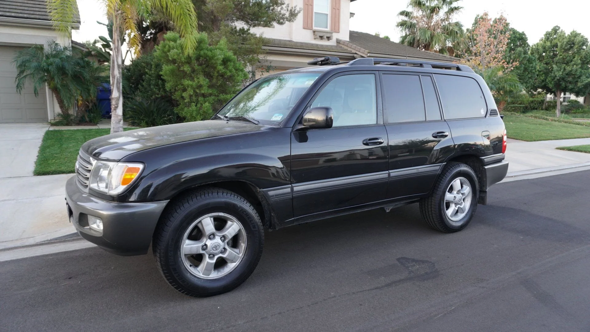

Since my last post, I've build a sleeping platform that was inspired by designs described here on ih8mud (pictured below). The cost for materials was about $270.
And I've gotten the rig some new shoes after a blowout in the Mojave (on the interstate) forced my hand. Took the opportunity to go with 32" Michellin Defender LTX M/S. They would have been nice to have at Oceano Dunes last weekend, but I did OK without them.
Not pictured are the new CA plates that have my amateur radio call sign.
