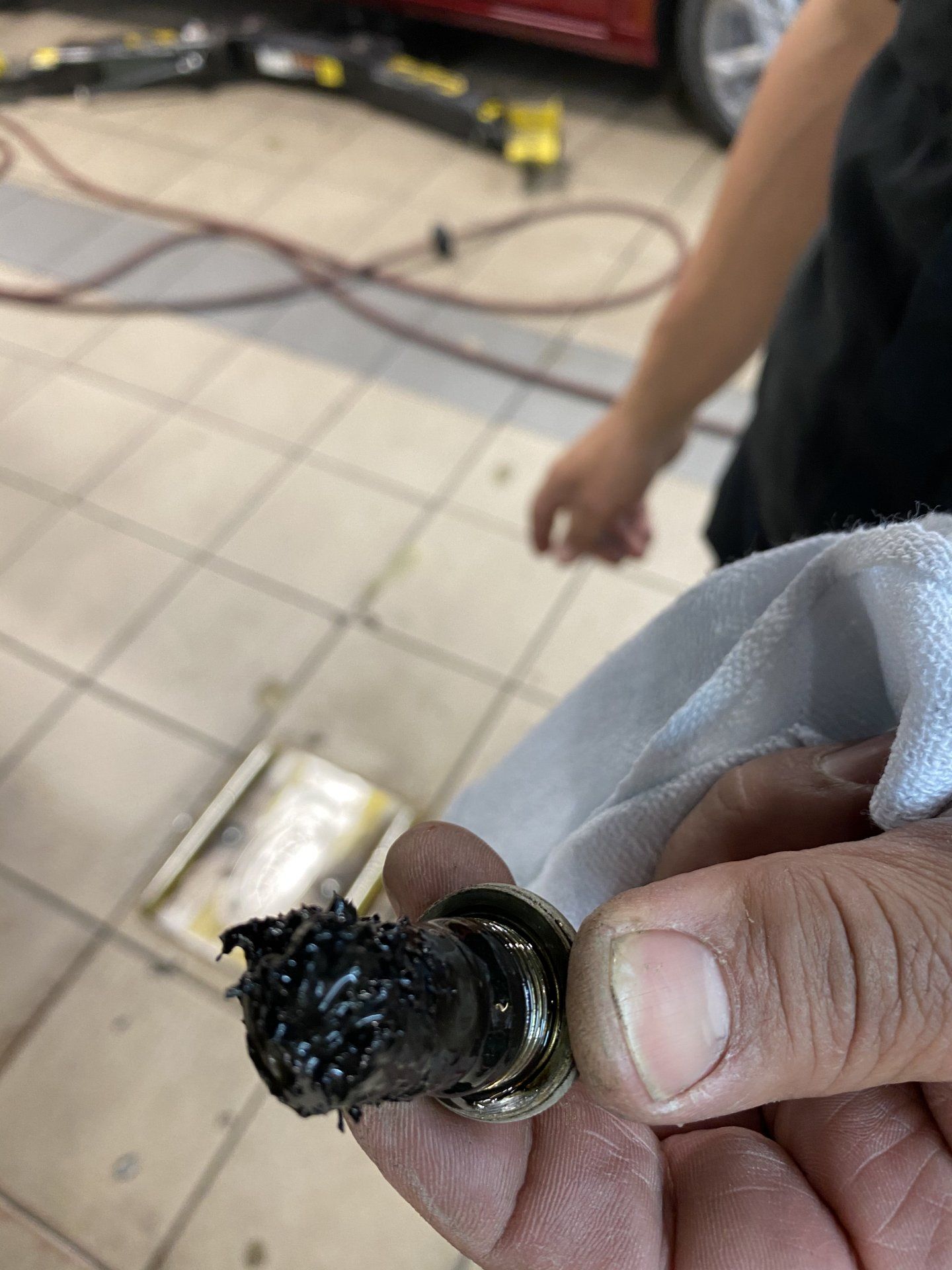

Ordered a new front diff.
A couple of weeks back a small consistent knocking noise started up. Only occurred under power, not while coasting. Slowly got worse. The amazing thing is she still drives.
The gear oil looked like a mirror. I am ordering what I believe to be the safest and best route,OEM. The original made it to 170,000 miles. 40,000 of which have come under my none too subtle driving methods.
I cannot imagine anything outperforming that. View attachment 2553027View attachment 2553026

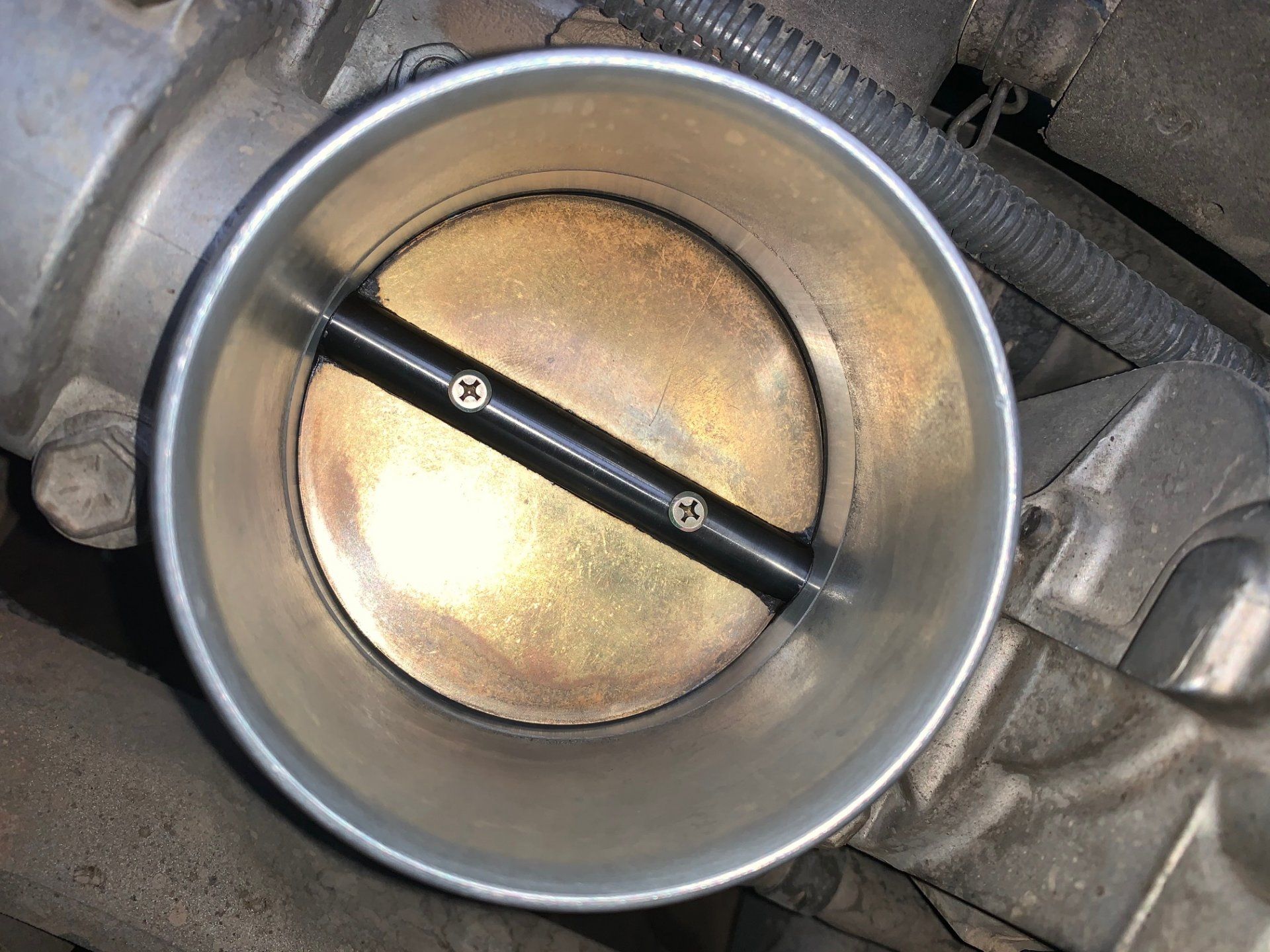

Cleaned my MAF and Throttle Body today. Figured it couldn't hurt. Getting such horrendous MPG's which is surprising considering I only have 265s... I'd be happy with just 1 extra MPG LOL.
This is my future, lots of cleaning along with a dab of gasket replacement. Nothing is wrong either, just preventative and general upkeep...

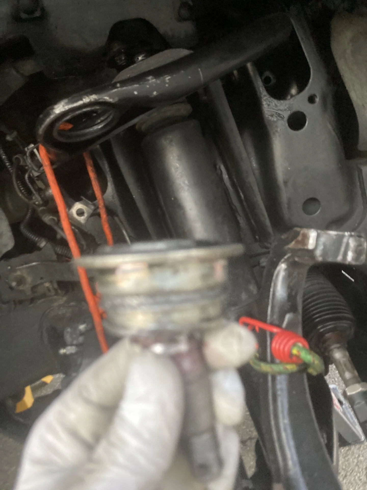

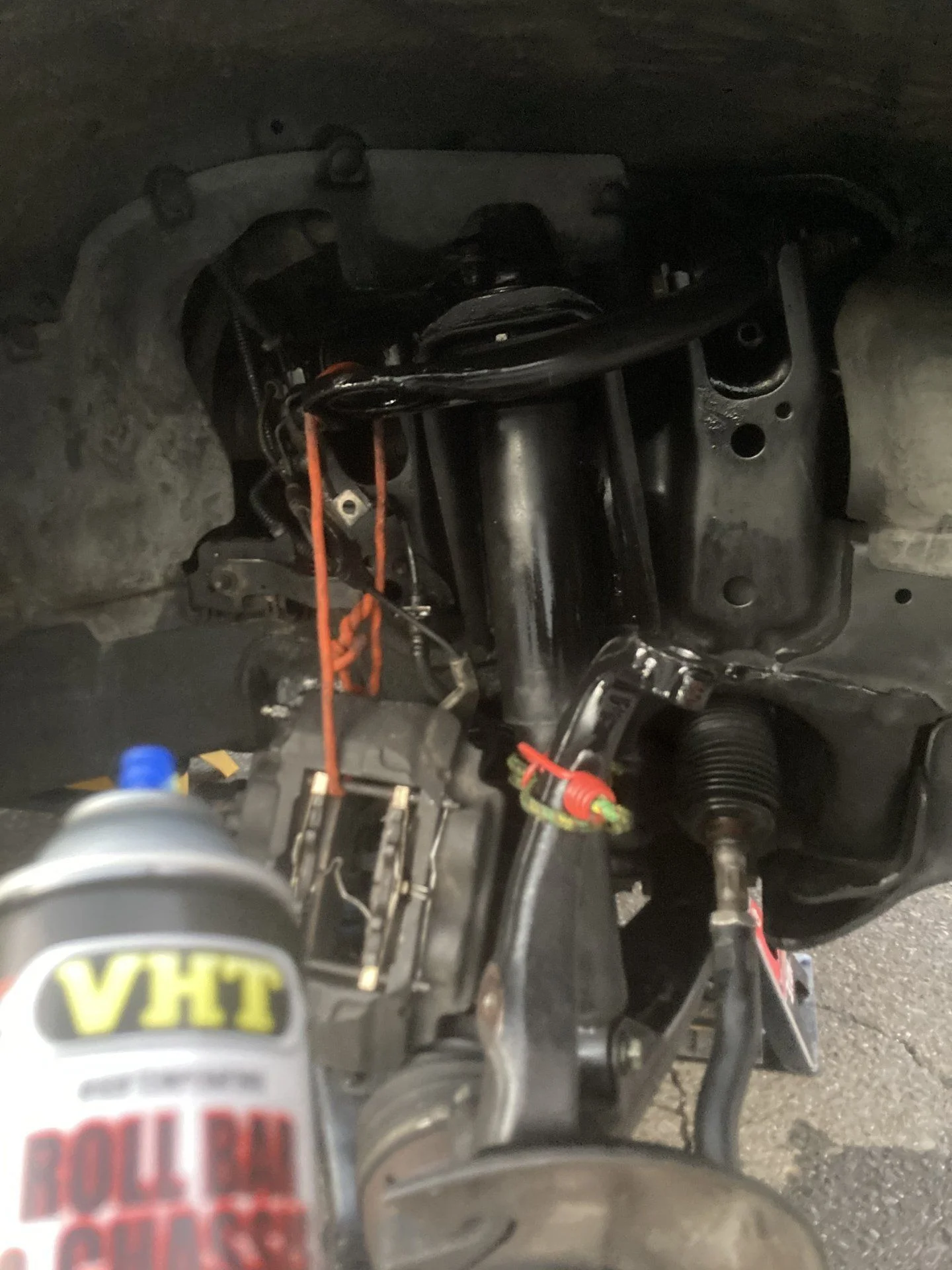

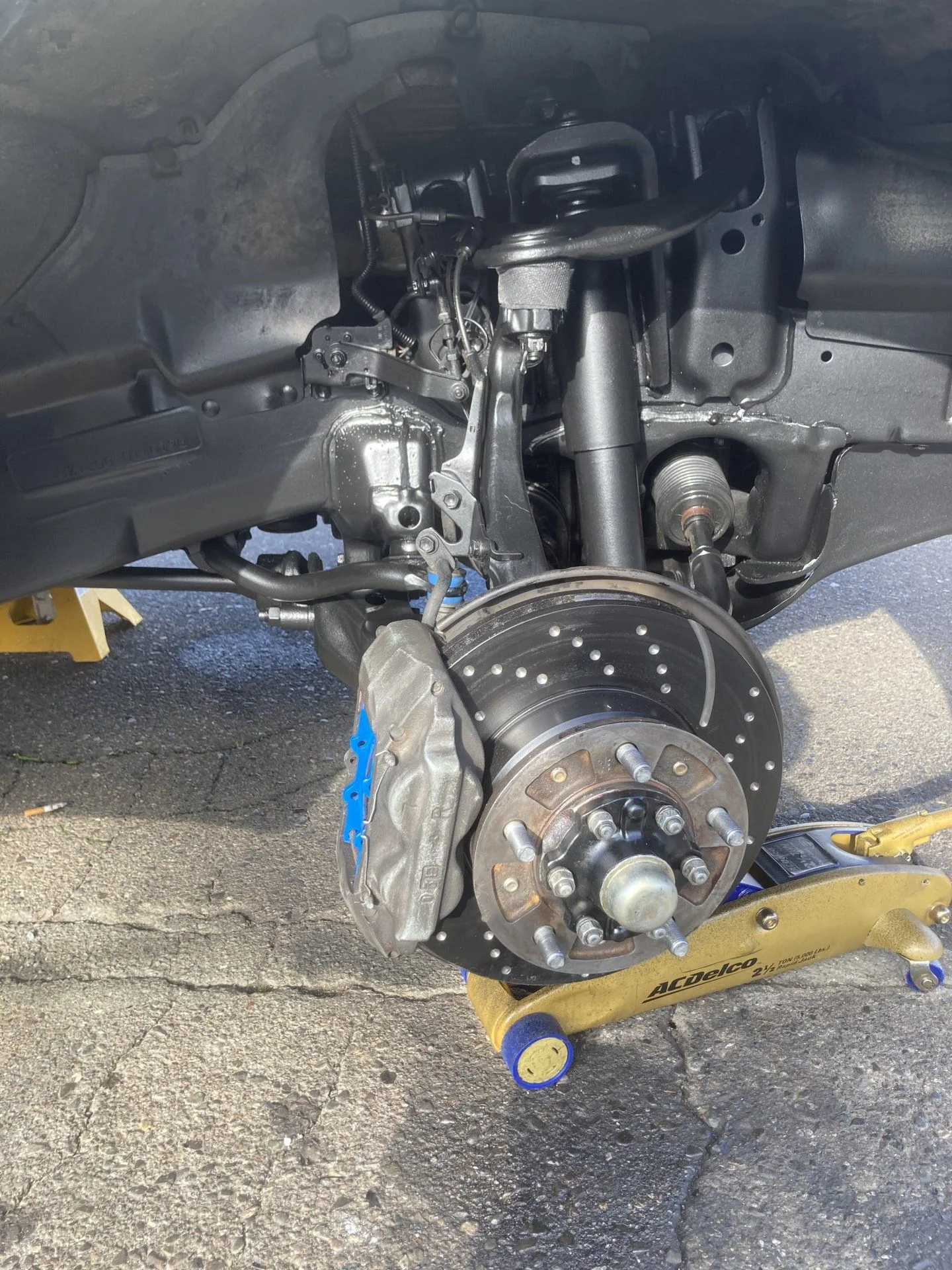

Today I almost finished the front drivetrain restoration. Moog sway bar end links, 555 ball joint, EBC stage 6 brakes with blue stuff, thoroughly cleaned, removed rust, painted and coated with RP-342. The wheel hub is already all cleaned up and filled with new Koyo bearings, just going to get back in there and replace all the mangled axle nuts and seals(thanks Lexus) to make sure preload is accurate.

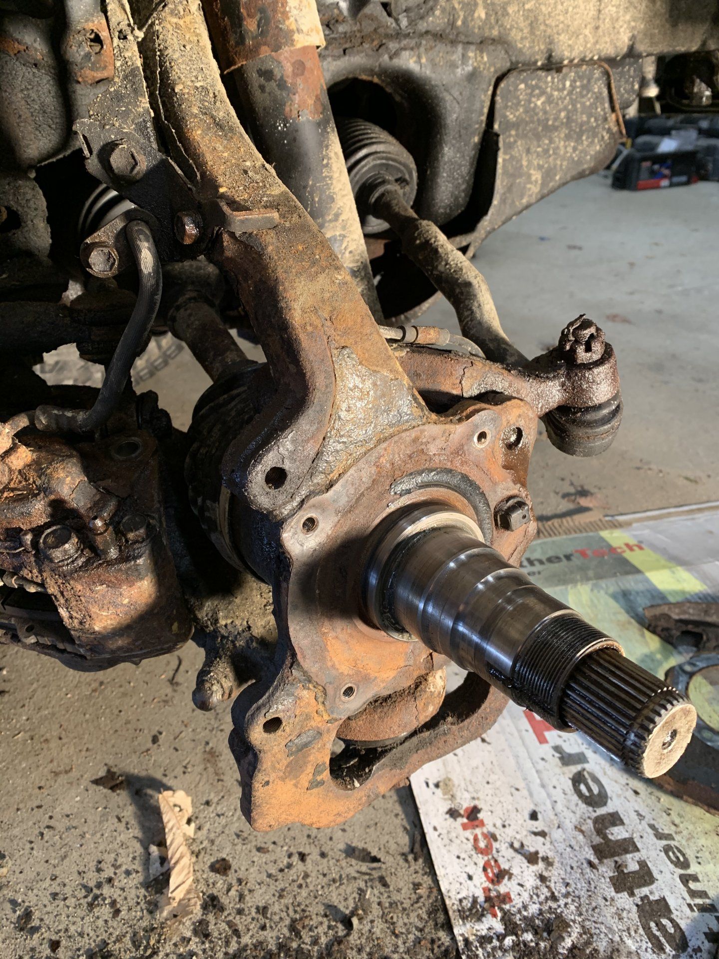

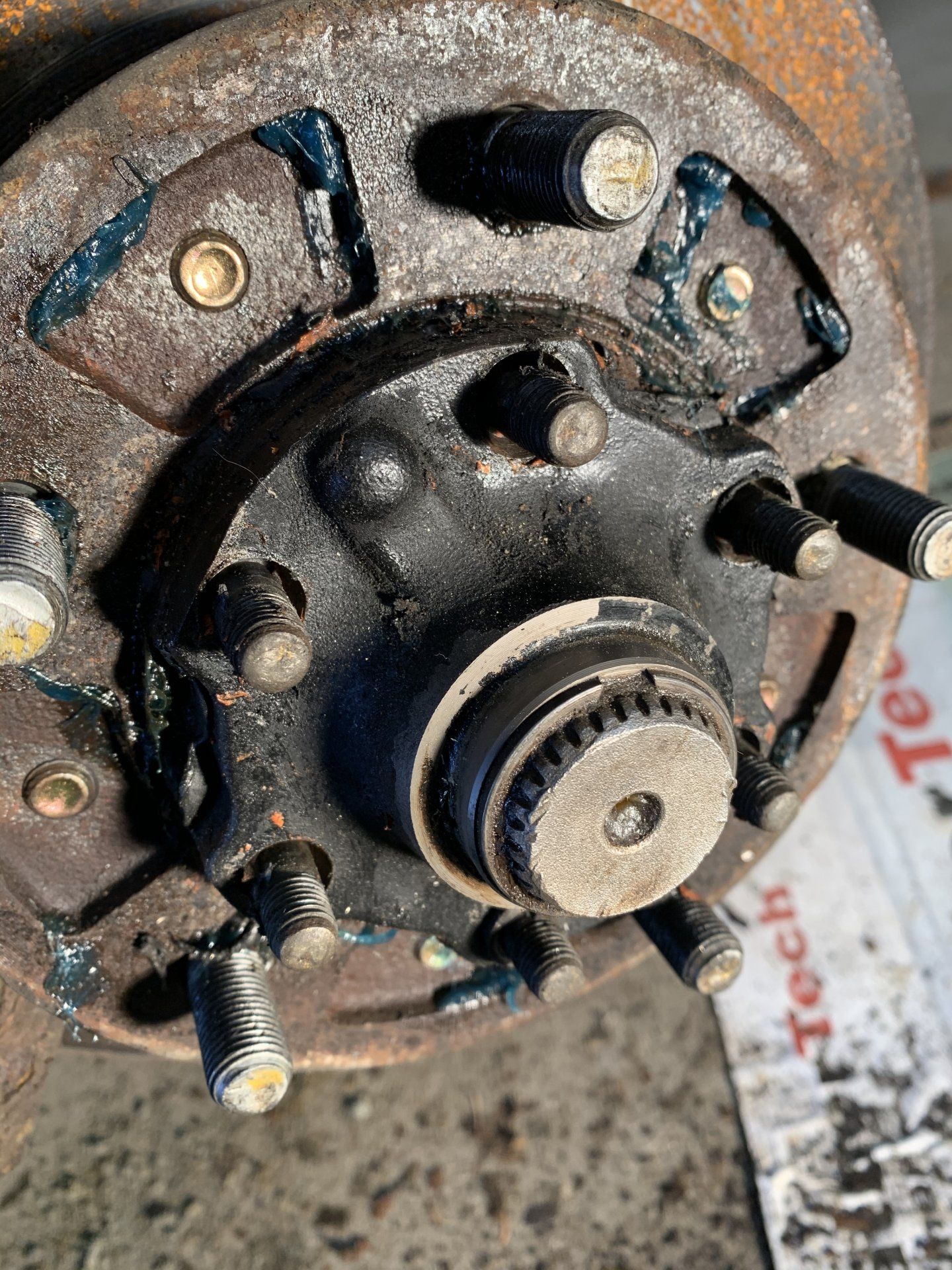

Stripped down passenger front hub to repack bearings. Some barbarian used gasket goop to seal the flange, which squidged up into the cone washers, so the whole thing was an ordeal. Thanks for the tips in various threads, @2001LC! The hub itself is pretty rusty, with all the coating flaked off. Is it worth disassembling and coating with POR15 to prevent further rust? Also, the bearings look in decent shape but are clearly not OEM - stamp says SKF/China. Worth replacing with Timken, or leave it if they’re in ok shape? I have a feeling my slop was due to improper preload/ clip spacing.
My hub was about as rusted as you’re is. Getting the rotor off was fun. And there was also silicone sealant over the flange which got the cone washers wedged something awful. I did the file, sand and paint restore because there didn’t appear to be any significance damage. Cheaper than the $400 wheel hub assembly and depending on how well work is going, sometimes worth it😁
Judging by your pictures, yours is in much better shape than mine! No surprise, given your location. I'm going to clean everything up and reuse what I can; I discovered the spindle bearing and oil seal were shot so now I'm waiting on those parts, which gives me time to clean and repaint the knuckle assembly.

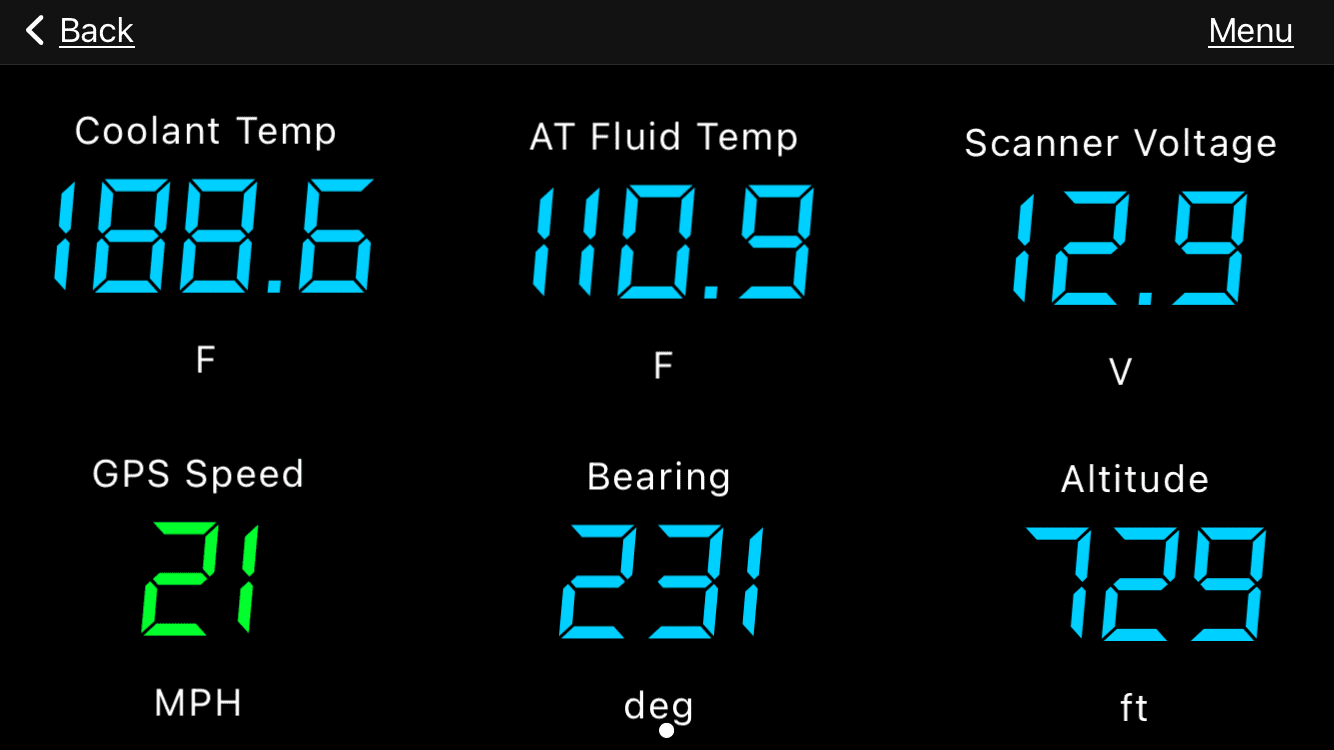

Yep, all sorts of info to snag besides mechanical. Extra stuff is $9.99
Veepeak OBDCheck BLE OBD2 Bluetooth Scanner Auto OBD II Diagnostic Scan Tool for iOS & Android, Bluetooth 4.0 Car Check Engine Light Code Reader Supports Torque, OBD Fusion app Amazon product ASIN B073XKQQQW
