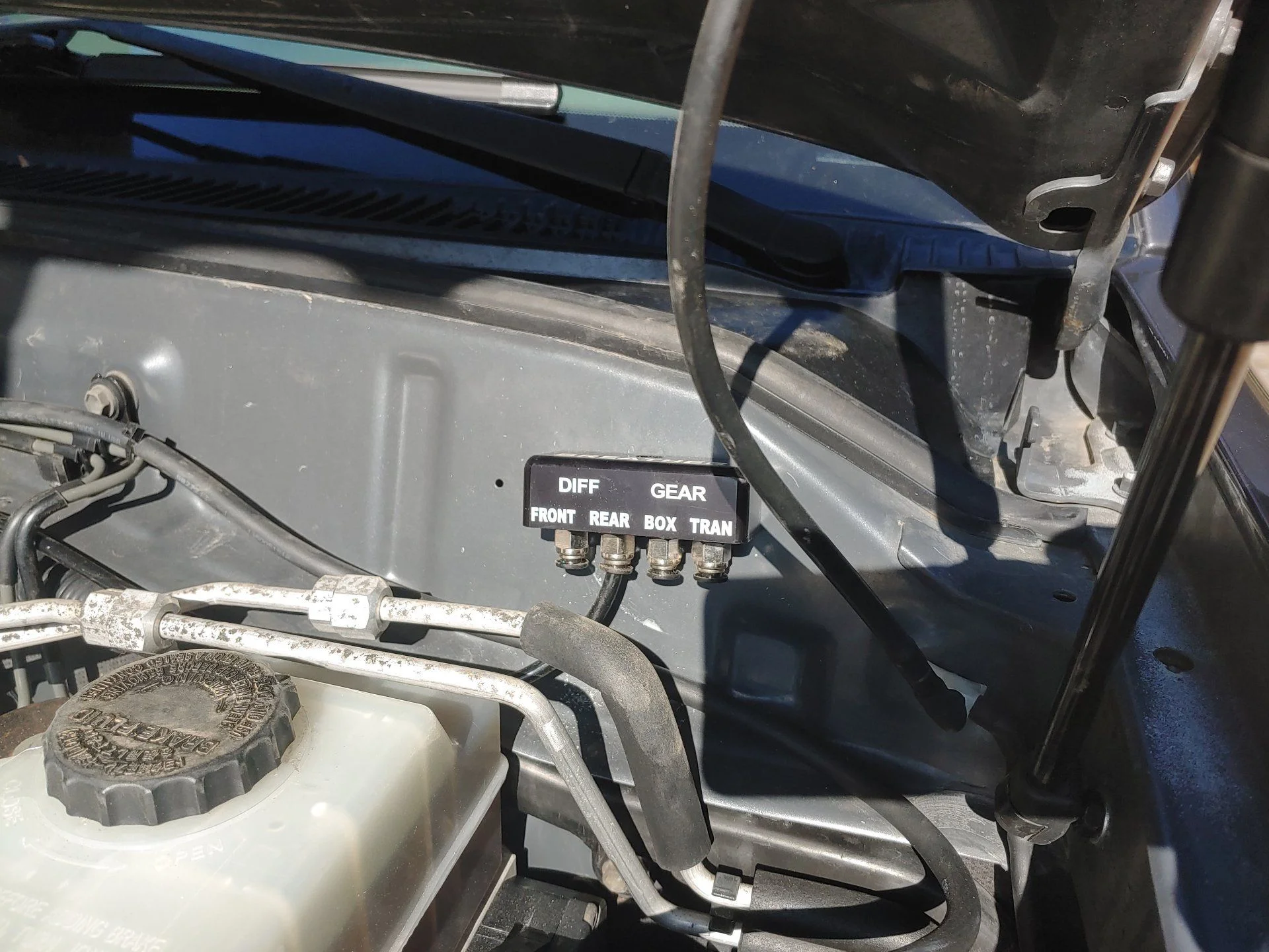

Began running my extended diff breathers. Should have done this a long time ago but alas, here we are. Hardest part of the whole job is working around the skid plates which I don't feel like removing.
Hoping this will alleviate some leaking of my rear axle seal. Will drive it as it it for a week or two and see if it's any better.

Nice. I haven't seen that before? Where is it from?

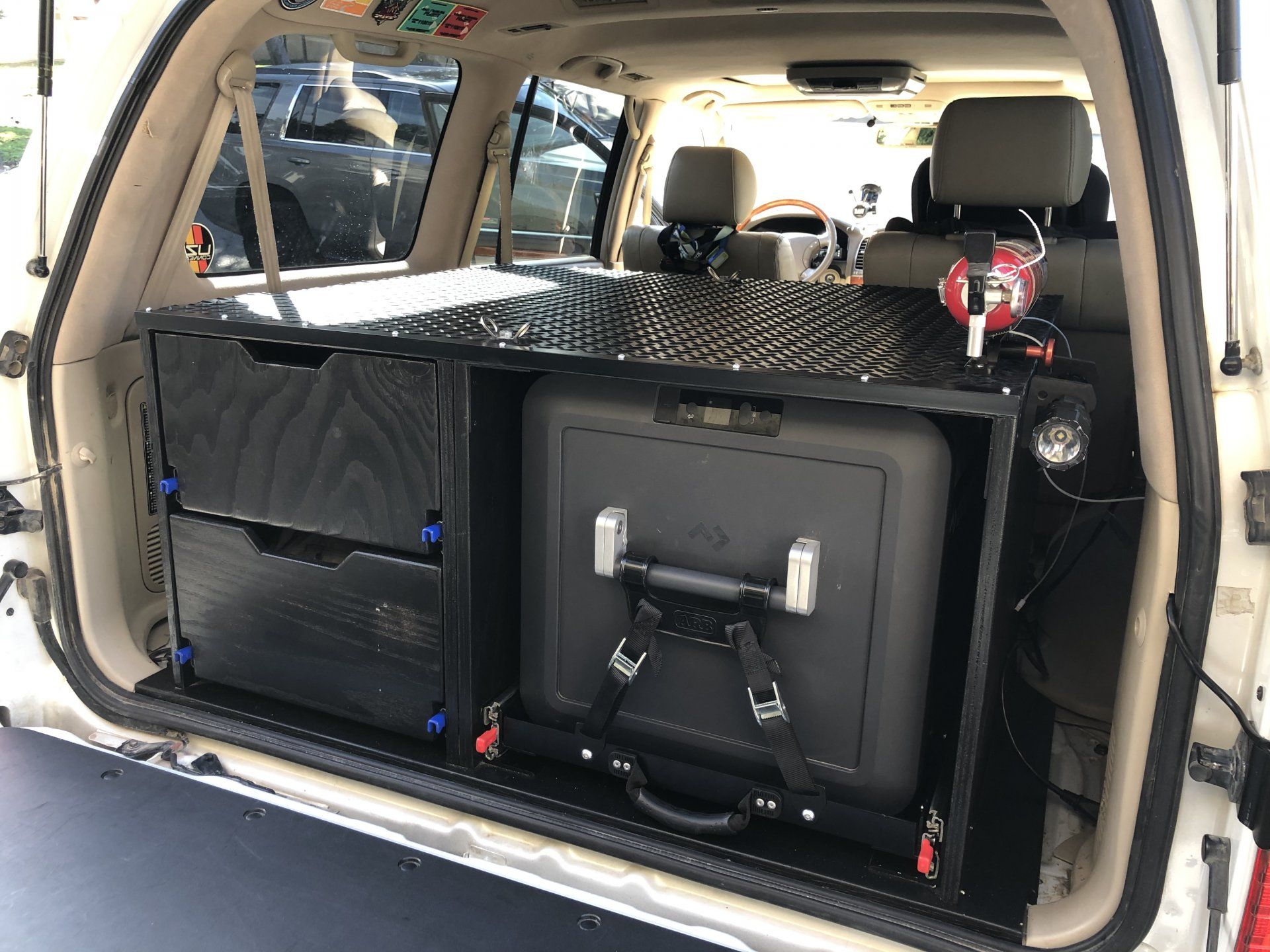

Put an update on my build thread (link in the signature) but a couple items knocked off:
Yak Track with ram device mounts

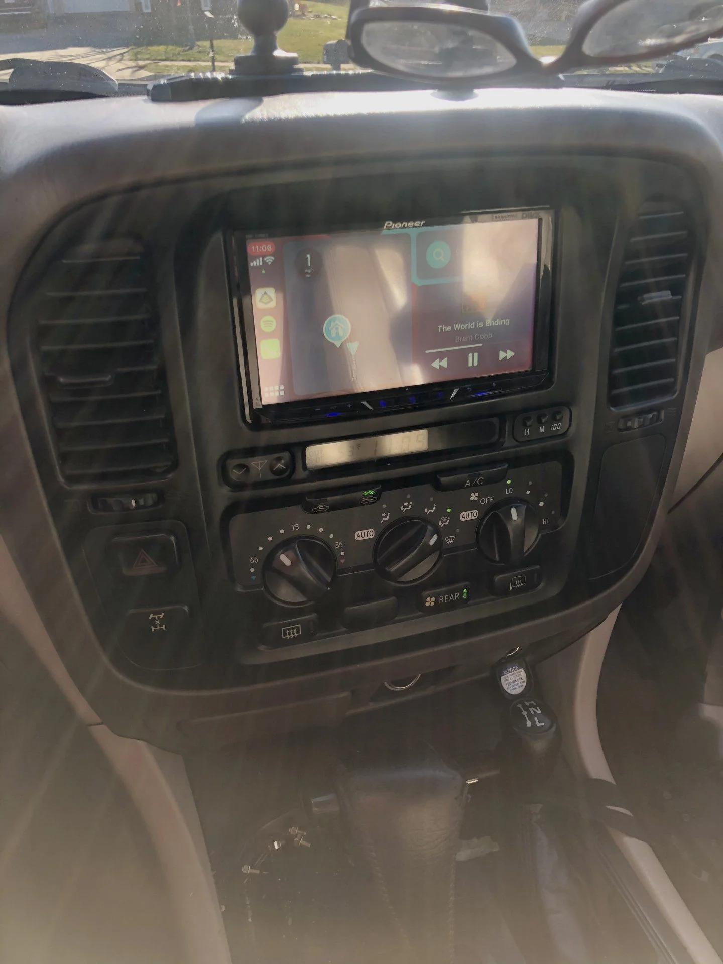

Pioneer CarPlay Head Unit

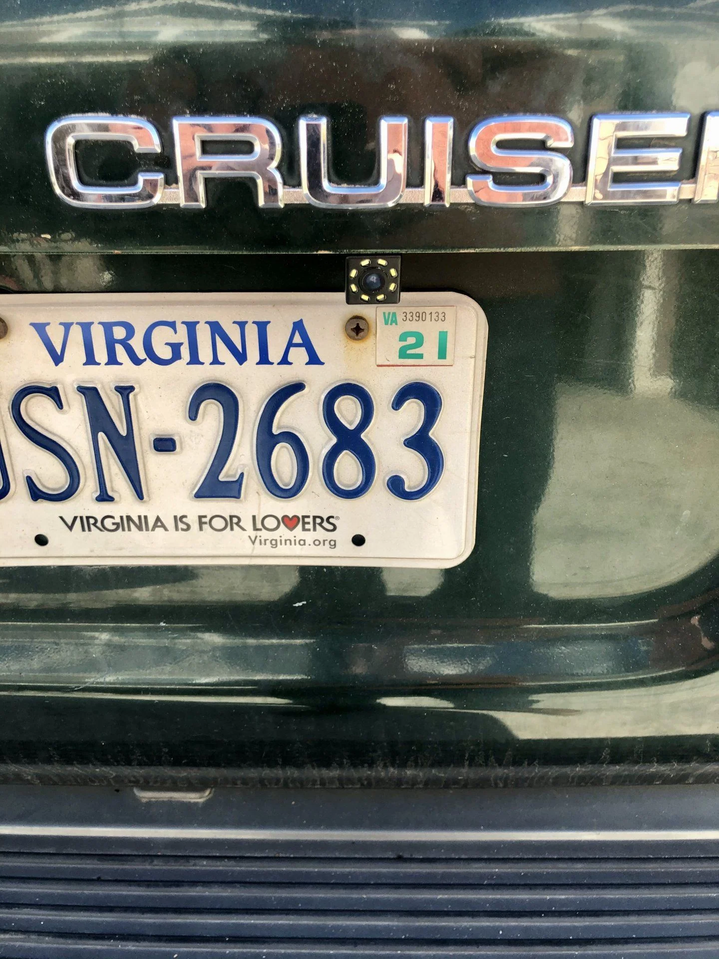

Reverse Camera
Stained the inside of the drawers
New cutting board/counter top - walnut with cherry inlay, grooves to slide on top of the drawer
Oil report and some other CNC stuff over on my build thread as well.

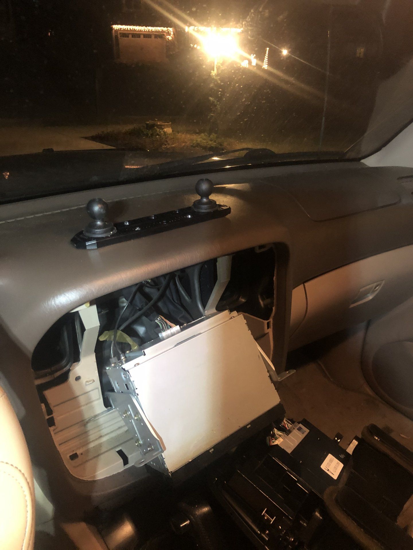

Ah modern technology. What an upgrade from the Nakamichi. And you wouldn't believe the sound quality!
Reality: had to button things up briefly to drive some places and still have climate control. Waiting on a couple parts and will have a new headunit with wireless Carplay/Android Auto and backup camera installed. I think it will modernize the truck a ton.
what is it? sub?

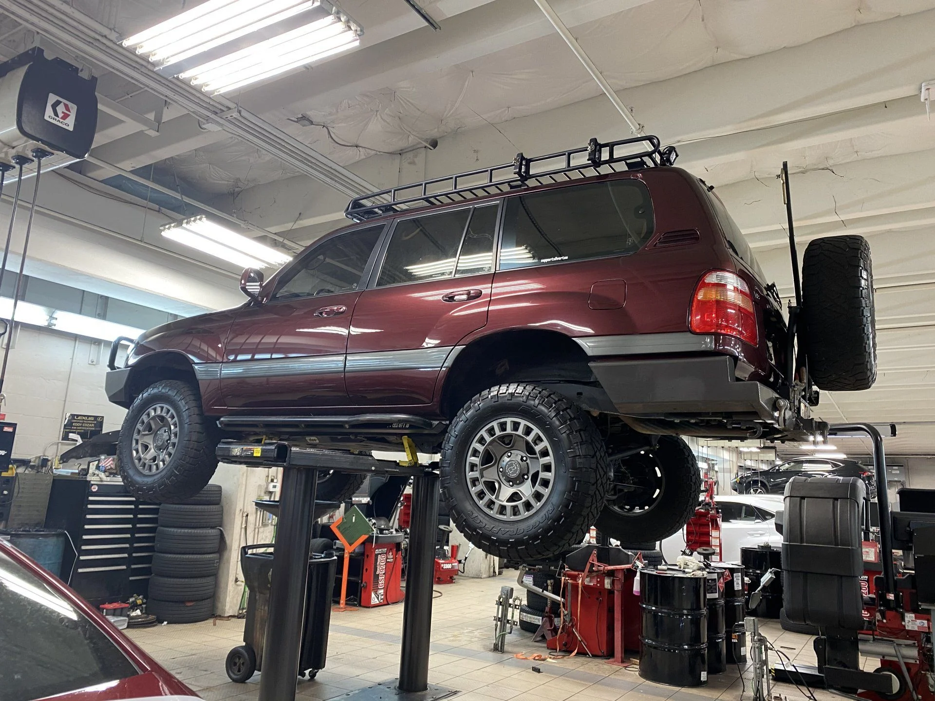

Did an impulse thing today and now excited to get this powder-coated. I’m feeling metallic gloss black topped with 2k polyurethane clear :grinpimp: color of the hundy is a silver LX, any other recommendations?
got any other colour on the rig to accent it too ? bumpers light matt black or somethin ? Chrome strips ?
found the ugliest colour ever put on a car tho, and I tried spraying this thing when I drove it as a taxi. Worst colour ever . metallic too OOoer
No accent, just the plain old monotone silver LX. Everything factory on the body and yes it still has the chrome lining on the claddings.
Again? Lol she’s on mag blue wheels now. But I saw one it’s on steel rims non-metallic straight color grey+blue-ish (like the FJ40 factory steelies) man that thing is a beauty. how about gun metal or I saw one like matte brown something like that. I'm going through 100 pics now trying to get inspiration from existing builds.
what is it? sub?
Haha, I did put a new sub in, but the pic is just a crappy Bluetooth speaker sitting in my empty double din slot while I wait on a part to finish the stereo.

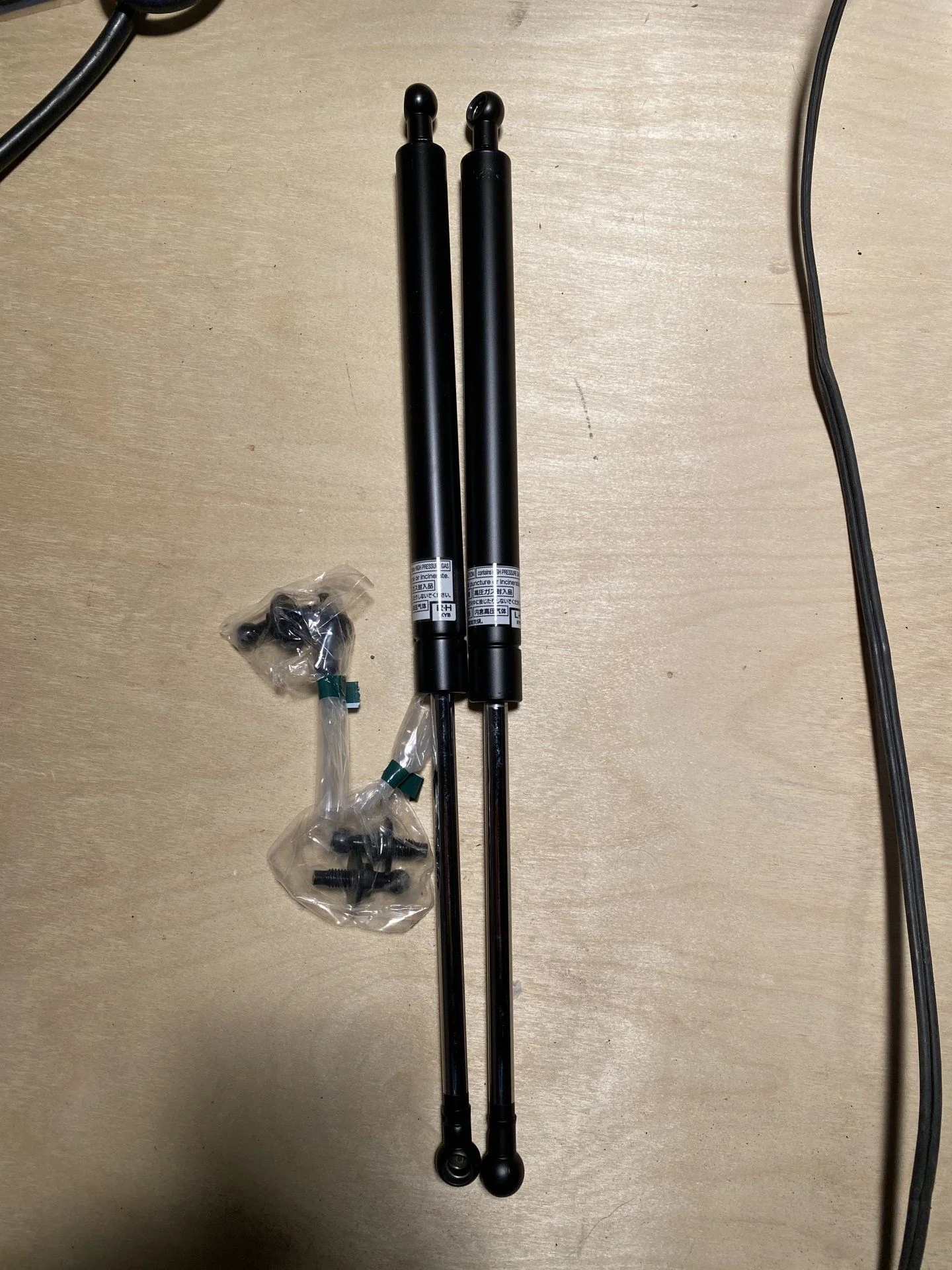

1. Replaced the hood struts with OEM. It's amazing what a difference new struts make.
I slightly cross threaded the hood threads and slightly stripped the bolt when replacing it and had to fix the threads.
So in case anyone else has the same issue, the threads at 8mm x 1.25. All good once I re-threaded (or whatever its called).

New Toyota struts ready to go in.
