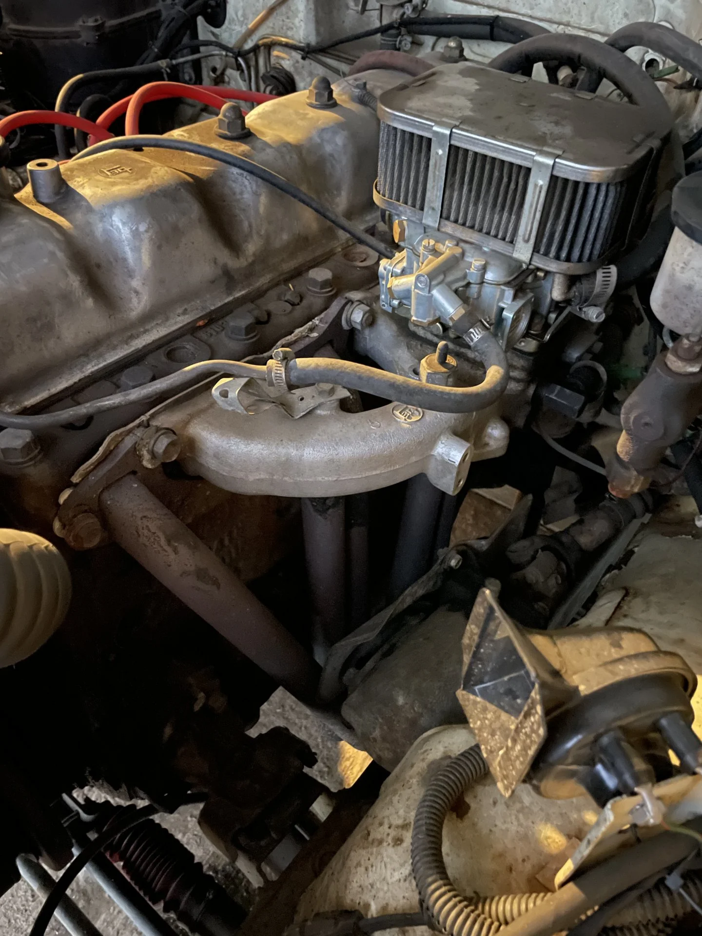

Morning everyone. I’m going to be replacing the Weber carb with a city racer one in the next couple weeks on my 78’ 55. I’m in the amassing parts needed phase.
I figured I would try and cure the exhaust leak at the head/header intersection with either a felpro gasket or double OEM gasket. I’m not usually a short cut guy but there is enough to do on this 55 without trying to find a decent OEM exhaust manifold, and have them machined and mated up.
Can anyone confirm that any gasket I would use for an OEM intake/exhaust set up will work for this OEM intake/header set up?
Thanks in advance.
