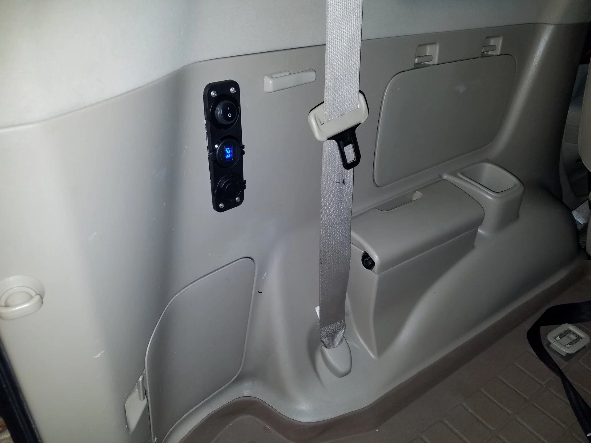

Finally got around to installing 12V power panel to the rear cargo area. This was actually a very easy upgrade. I ran a 16-ga wire from a add-a-circuit fuse tap at the cabin fusebox all the way back to the cargo area. This only required popping up the door sills, putting the wire in the OEM harness channel, then snapping the sills back in. I sliced a hole in the factory cargo side panel with a Dremel and ran the wires up to the power panel through the jack door. I did have to temporarily remove the jack and CANBUS computer to gain access. Grounding was provided through a ring terminal around one of the CANBUS computer mounting bolts The panel is always hot (the add-a-circuit was plugged into the power seat circuit), but is switched so it can be turned off when not in use. This will be very useful for camping, going to the river, etc, when we want to charge phones or operate 12V accessories but don't want the ignition on. I love Japanese cars but none of them seem to provide always-on power to 12V receptacles.....this cheap upgrade gets around that.

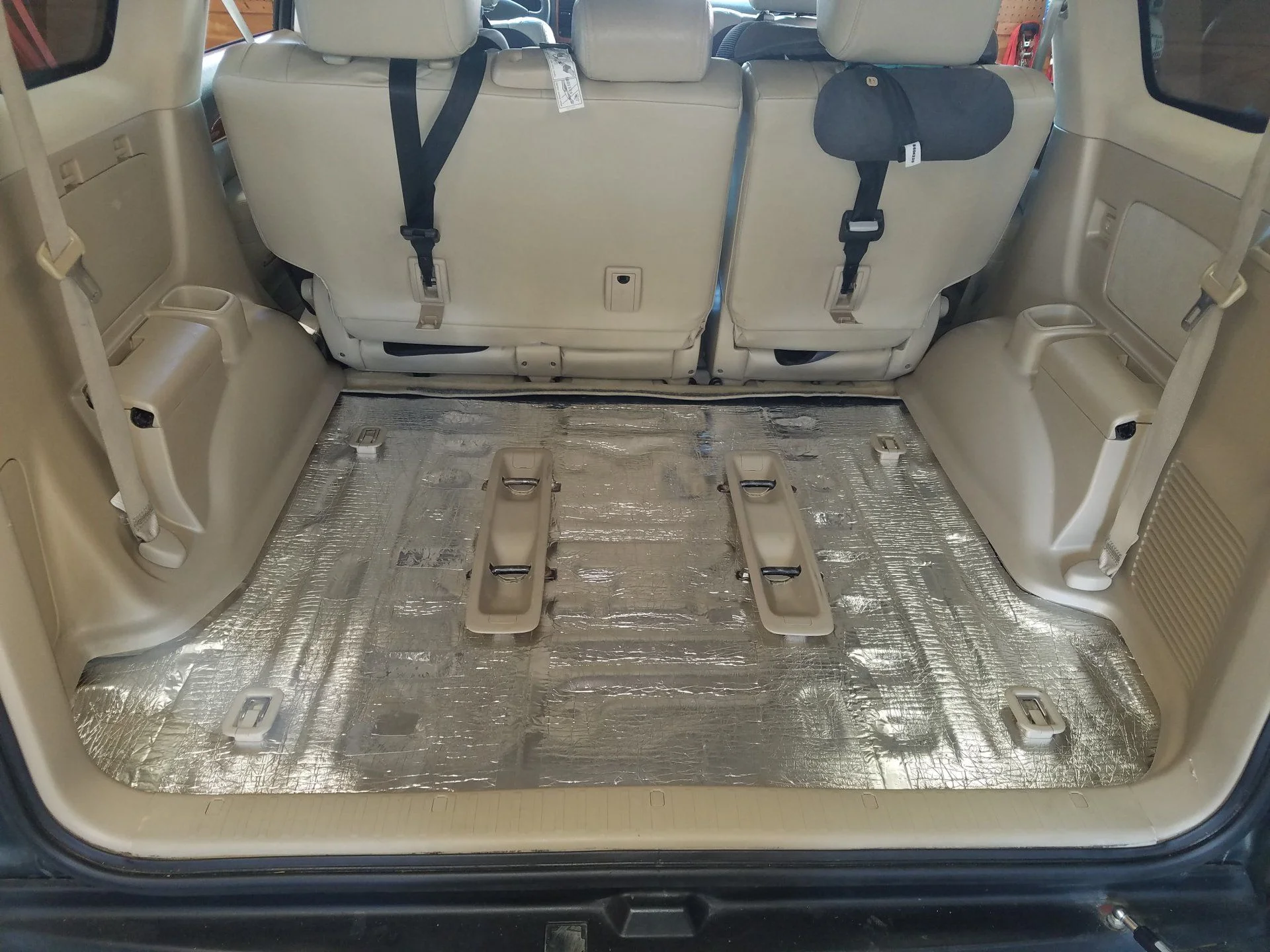

My GX was missing the rear carpet (who knows what happened to it - my guess is something disgusting), and only included a WeatherTech rear cargo mat sitting on bare sheetmetal. Needless to say, there was a bit of road noise coming in. So I added a layer of 157-mil sound deadening on top of the sheet metal. It's much quieter now.
Unfortunately, I'm still not happy with the gaps between the trim/attachment points and the cargo mat. I'm going to add another 1-2 layers of sound deadening to get things flush and may cut a plastic wall sheet on top of everything if it seems too squishy for cargo.

The 36 square-foot roll is enough to do two layers in the GX. It went in pretty easy (around 45 minutes for the first layer, with rolling). The edges of the roller were kind of sharp and sliced the foil backing, so I had to chamfer them with my bench grinder. I also had to poke tiny holes through the deadner to let air out of the divots/depressions on the cargo area floor. All seams and holes were sealed with metal foil tape, which was a perfect match. As mentioned earlier, the deadener is around 4 mm thick while the gap between the bottom of the trim and the floor is around 20 mm. I'll be adding two more deadener layers to get it closer.
