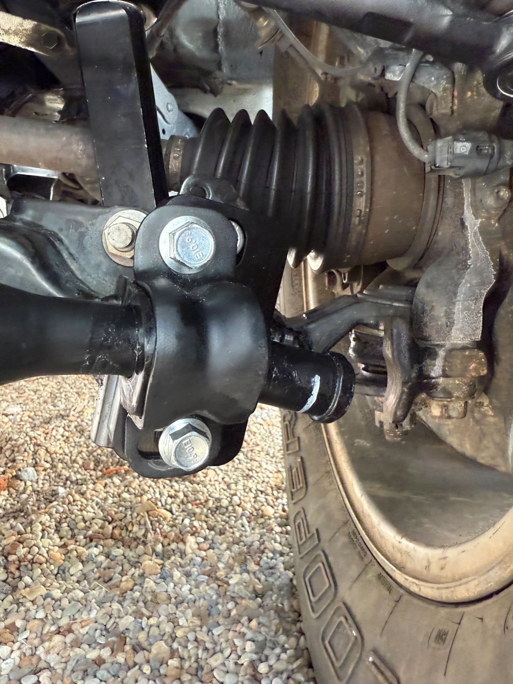

Installed the DrKDSS adapter plates for the LCA, along with some poly bushings.
The bar sits way better on the driver side, and can’t tell much difference on the passenger.
Honestly, this is likely short term. I have a feeling I’ll be ditching KDSS in the future, and running something like a currie antirock sway in the rear. This car basically goes to and from the gym, and to and from camp sites. We use my fiancé’s car for road trips and errands.
The KDSS feels really stiff / aggressive when on rutted out forest service roads. It’s also an absolute pain in the ass to remove and re-attach the sway bar.

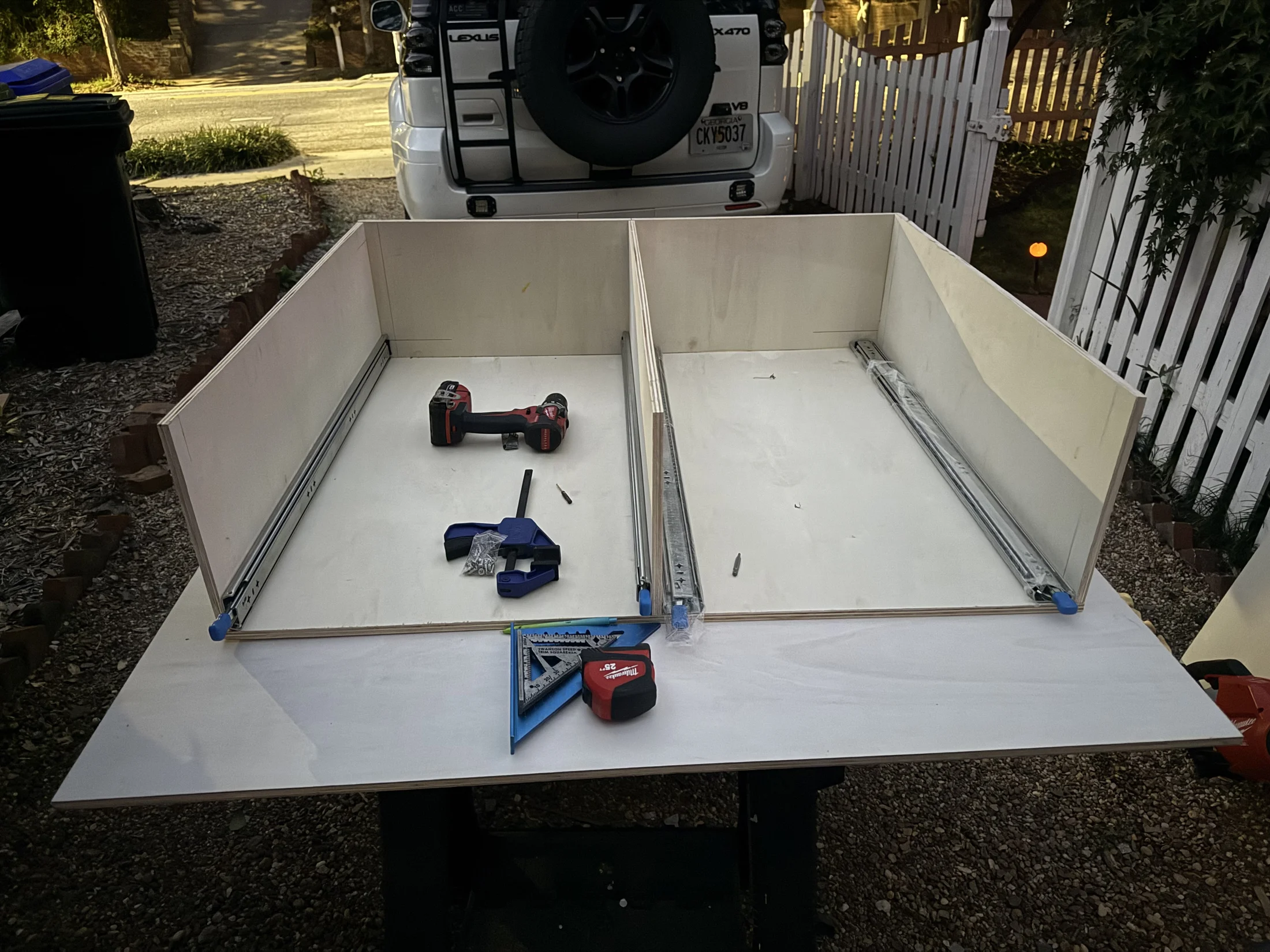

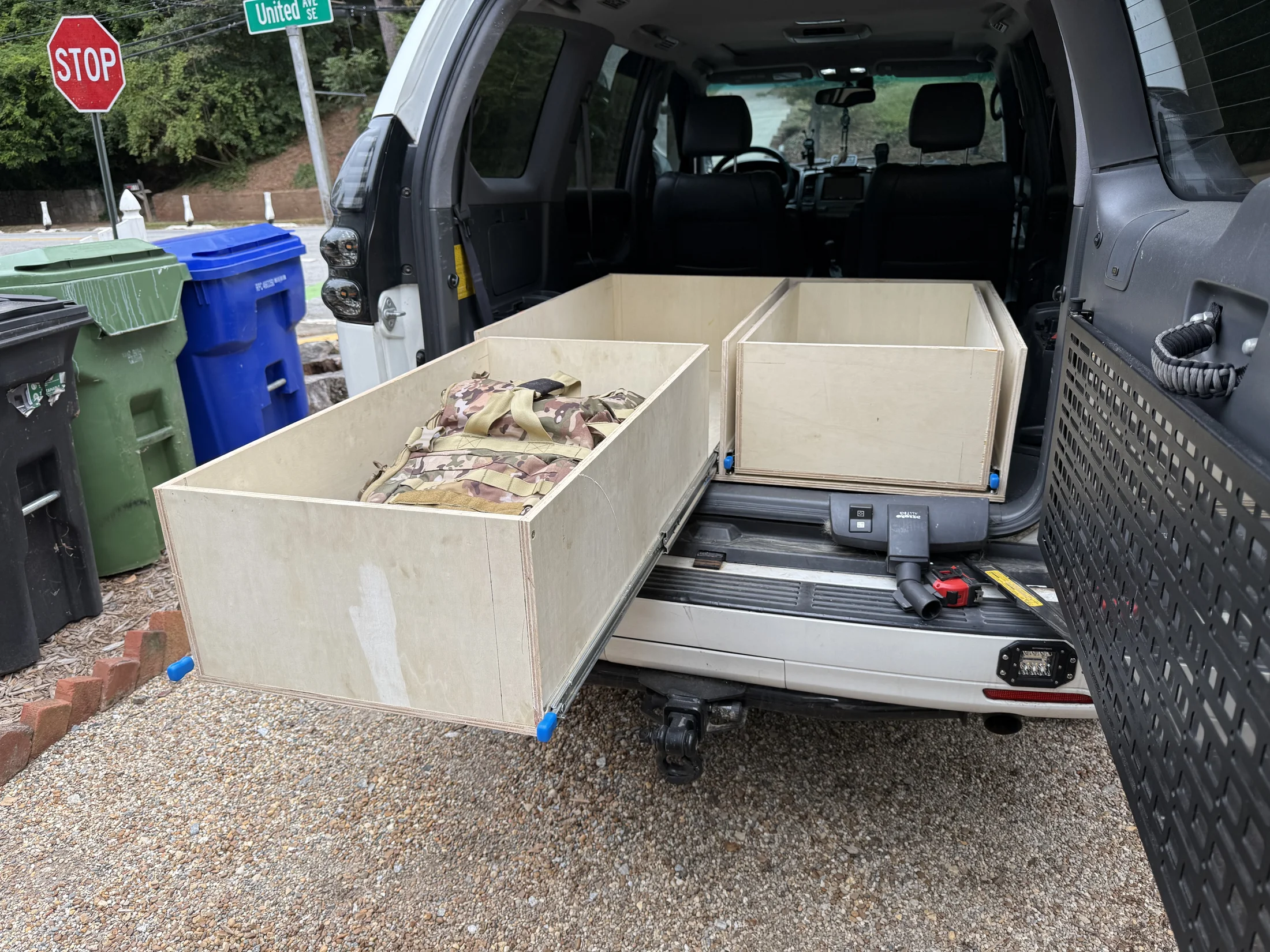

Drawers came together nicely!
Now to build the replacement for the second row seats. Gonna turn that into more storage with lids that open up on both the passenger and driver side. Basically you’ll open either second row door, and then lift a lid up.
The top will be a sleeping platform front to back. Probably gonna order more drawer slides to make a little slide for my cooler that goes on top of the drawers.
That's a great looking set of drawers! Should be much cheaper too than buying pre-built drawers, which are crazy-expensive regardless of where you get them from.
Thanks man!
Price was my main reason for DIY. Absolutely not the quality of an air down gear up build, but the drawers slide in and out and hold a hundred or so pounds of gear! All for $300 in parts from Lowe’s.
Sleeping platform | drawers | storage is just about done. Work got in the way the last few weekends. Had time today, and I made a lot of progress. All that’s left is making the lids for the storage compartment.
The carpet makes it tough to see, but there’s a lip down the inner edge of the storage compartment cutouts. Got magnets under the carpet in the lip. Magnets will go in the four corners of the lid. Hoping that helps keep it from rattling, while still being easy to access the stuff inside.
Next up is making a drawer slide for my cooler that will mount on top of the drawers. Gonna use the extra wood and drawer slides for that.
Nice job! Really like the adjustable feet idea up front. What wood did you use?
Thank you! I just grabbed two sheets of the mid grade 1/2” plywood from Lowe’s it was priced between the maple and the crummy mdf. Nice smooth finish, but definitely not as nice as the cabinet grade maple. The paint took to it well.
The adjustable feet helped a lot because that was a tough spot to measure precisely!
