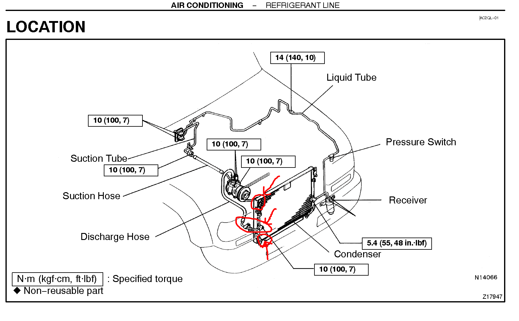

Quick update on what I've found. Initial thought about the a/c drier/receiver was wrong. Compressor looks good too. It took me awhile but I think found I the culprit. I initially thought it was where the compressor discharge hose enters the condenser (middle circle in the diagram below)

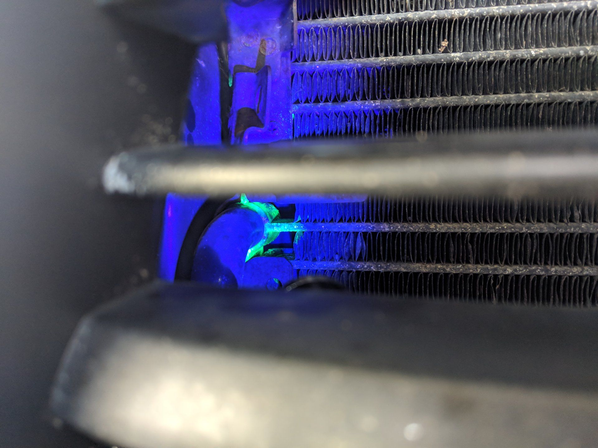

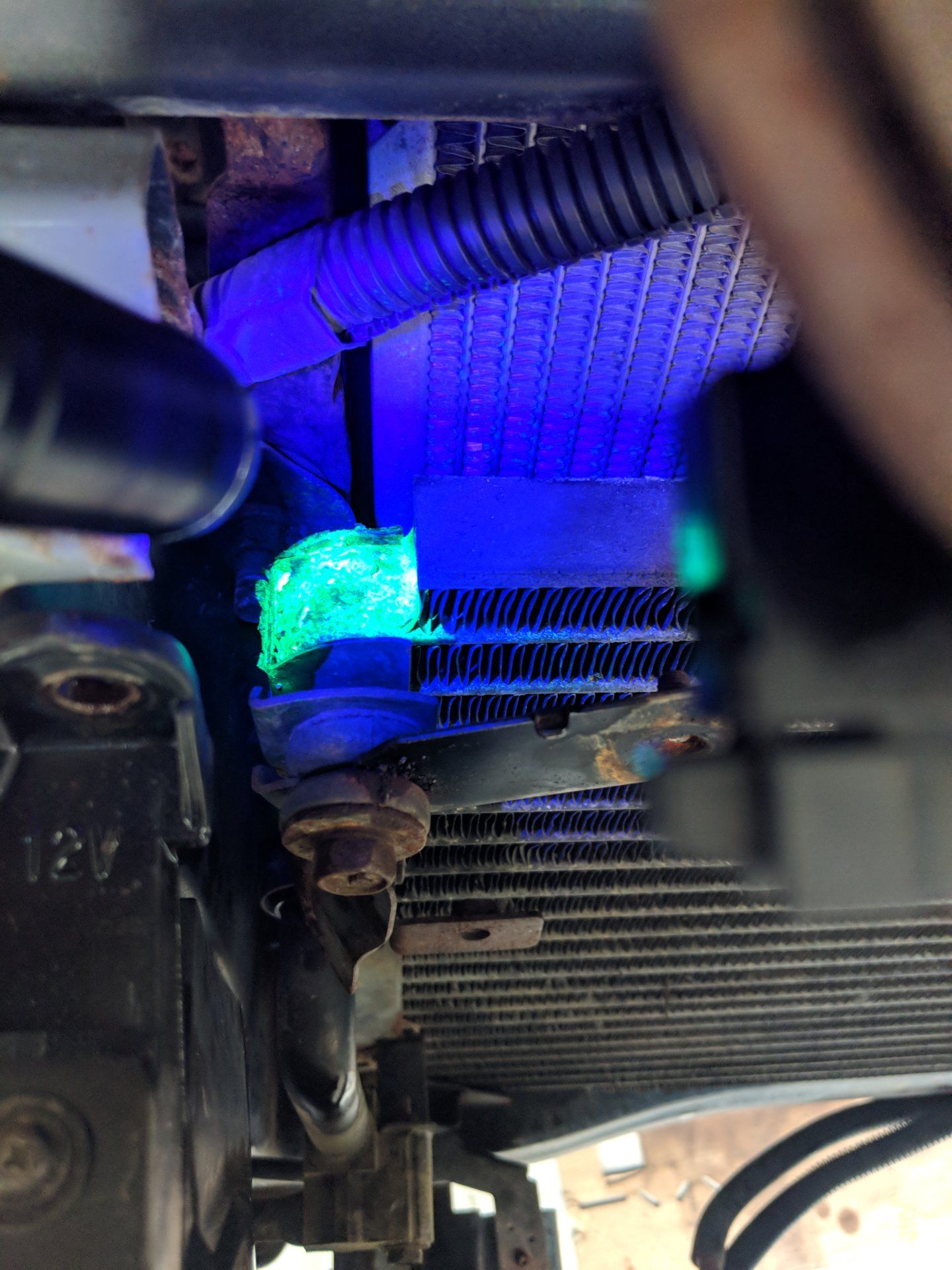

But after removing the center brace I was able to see the top of the condenser covered in dye as well. A couple pictures below but thoughts on the condenser being shot versus just a bad connection? My guts telling me it's prob the condenser but I'm a bit out of element here.
Picture#2 from the Front showing the compressor discharge hose entering into the condenser.
Wow, that's pretty clear!
Brake clean it all off and drive it again.
So some good news (i guess)- second test produced the same results. I pulled the condenser today and ordered the ac receiver/dryer, o-rings and condenser. To be sure I wasn't missing a hidden leak I pulled the evaporator and checked for dye. No dye in the evap but ordered the expansion valve as a precautionary measure since it's open.
