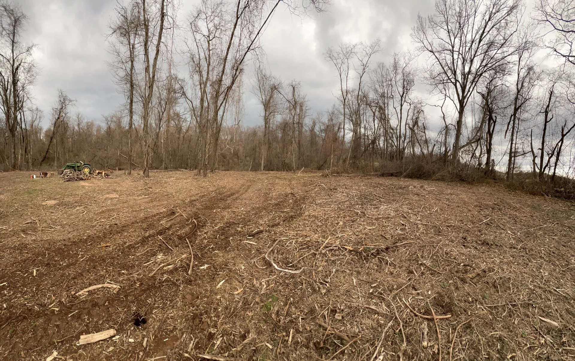

Nothing new with the Toyotas, been too busy with work and adding several new staff, as well as clearing the house site. Started off overgrown and very difficult to walk through, but getting there. The JD 850 has been running like a top and making things a bit easier. Probably 16 more trees to come down, hopefully I will get that done tomorrow.
Worked with an architect to refine and formalize the design we came up with and got those plans approved. Trying to save a bit of money, so I have been doing the site design and getting all the permits myself. Builder, excavation contractor and cabinet manufacturer are my neighbors, and most of the other trades are also from Perry County, so we are keeping this project local.
Driveway gets cut in next week, along with the basement.

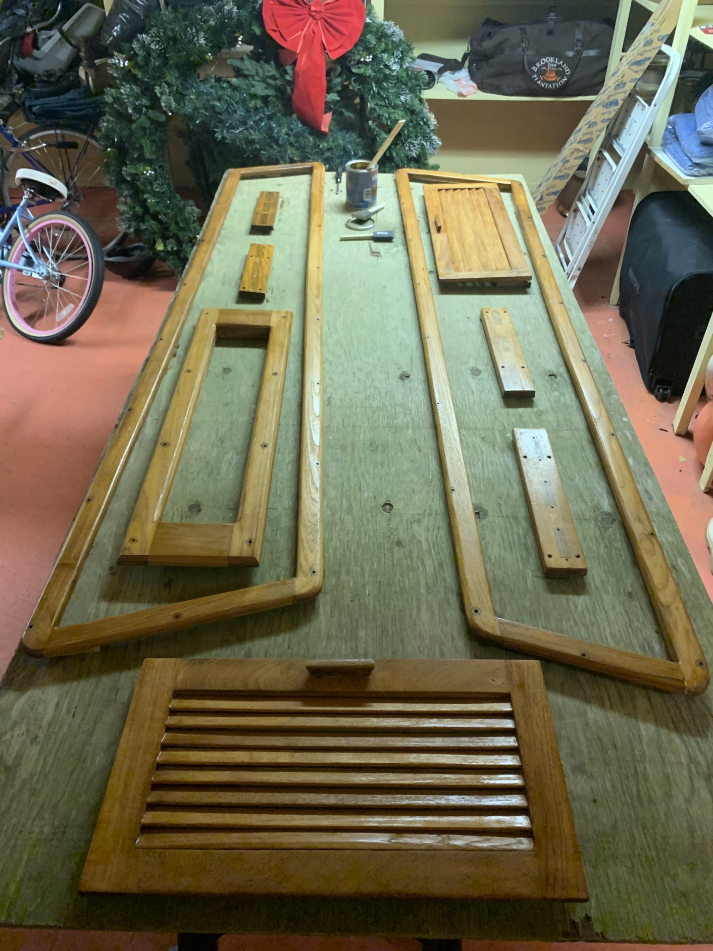

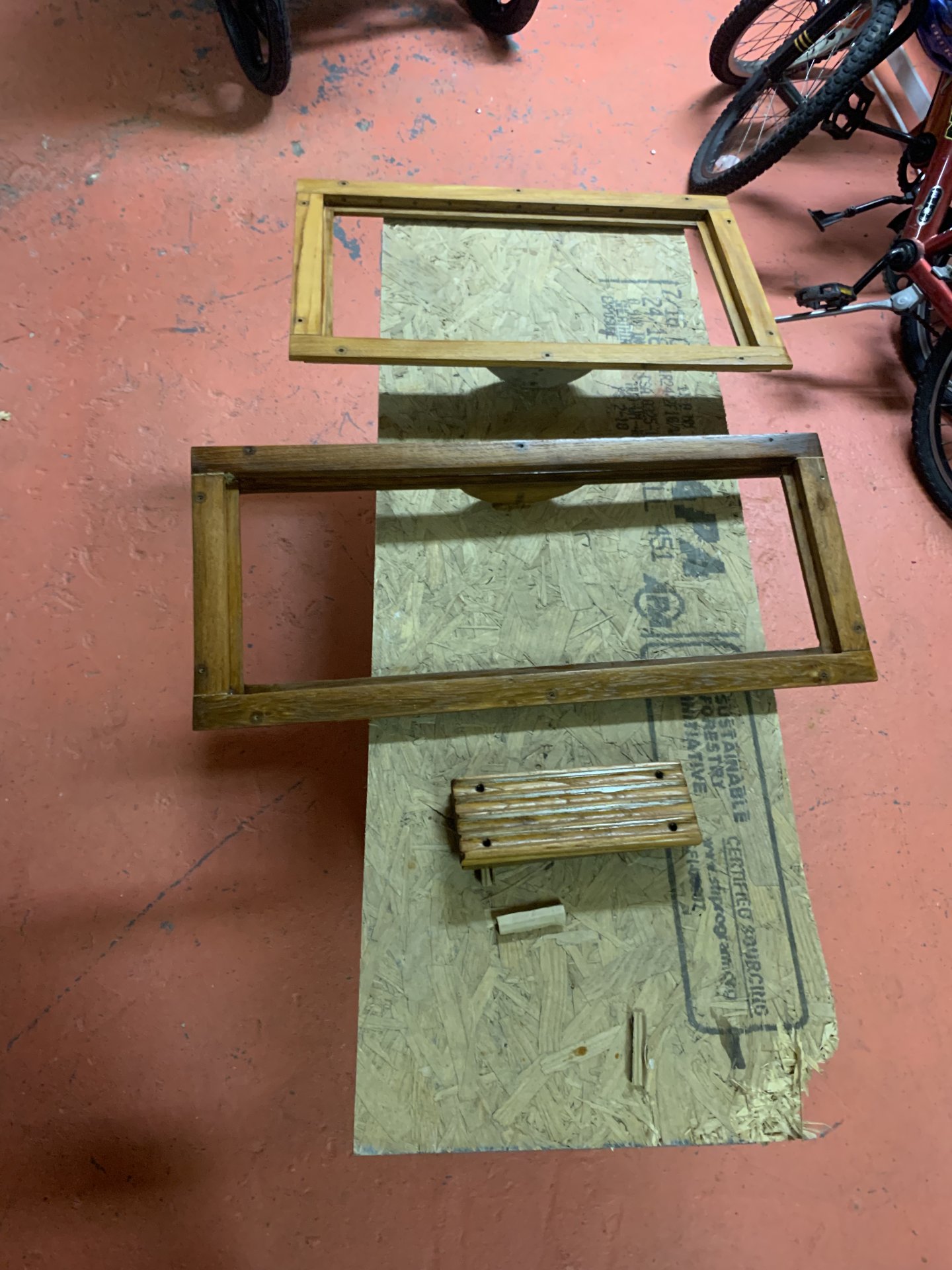

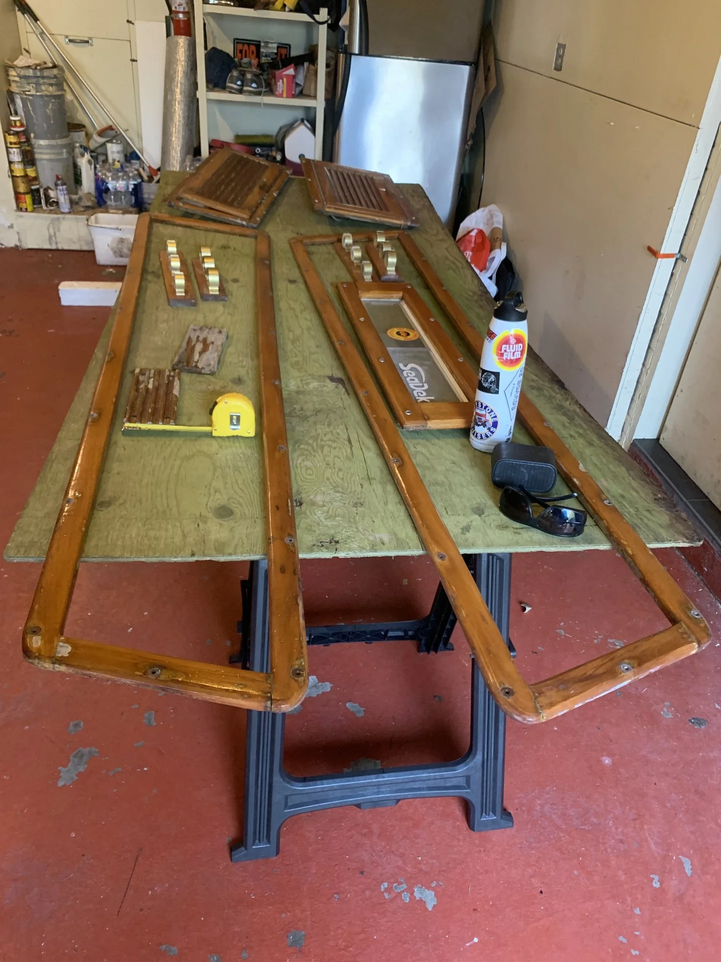

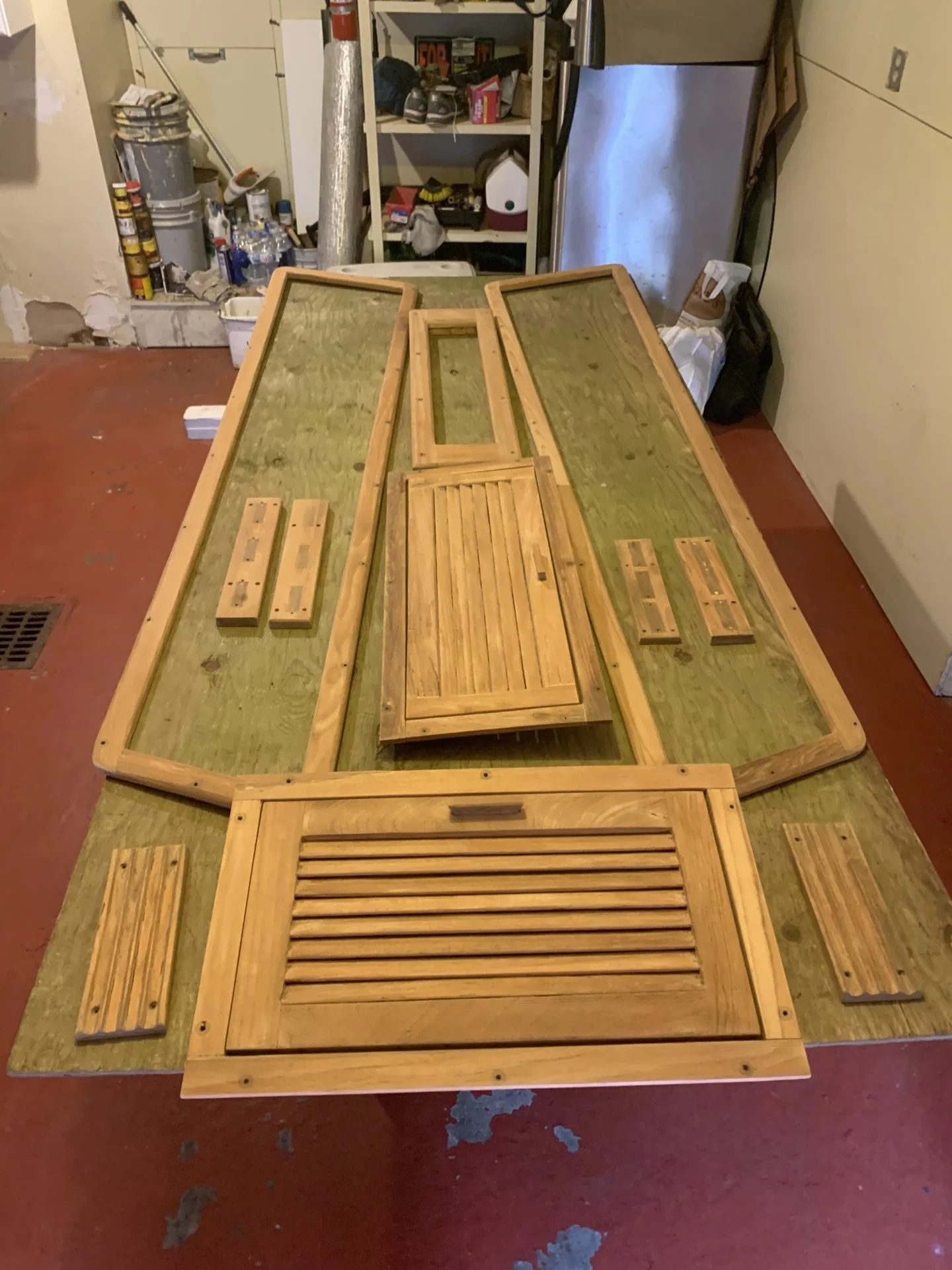

Been too long since I popped on the forum- here’s my excuse- a boat. Been working on the teak on my boat major pain in da ass. Taco is fine, got some maintenance done that’s about it. About to replace a stuck caliper on the 3rd Gen rav my dad has. Looking forward to wheeling soon. Those pics of the barrens were sick. Here’s the before and after of the teak.
Had to zip strip and scrape the old finish off, then sand with 120, then clean with 2 part teak cleaner and a brightener, then sand with 220 and a rub down with 000 steel wool and a wipe down with solvent. Now it is drying out in the house with this wet weather. Going to apply the final product soon. Also had to repair some damage from my clumsy overweight fishing buddies big ass feet. Good to check in and see what’s up see you guys and gals soon.
Got two coats on- have to wait 24hours between coats. This after after the first coat dried for 24

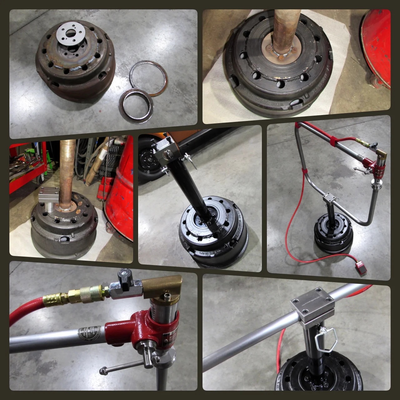

I've been putting together a stand for a recent tool purchase:
  • Took a truck brake drum and welded a VW rotor to it. Then turned down a second VW rotor for the lug holes to line up.
  • Welded an upright to the second VW rotor and bolted the two rotors together.
  • Turned a fitting that would fit in the upright and welded it to the tube clamp.
  • Painted the drum and rotor and powdercoated the rotor and upright. Drilled through the upright and fitting so that a hitch pin would lock things in place.
  • Provides a nice solid base for a Tinman's Garage Planishing Hammer.
  • I put a disconnect on the airline at the hammer so that I could easily swap things out.
  • And, finally, a closeup on the tube clamp assembly.
Next step is working on a storage unit for the dies and hoops.

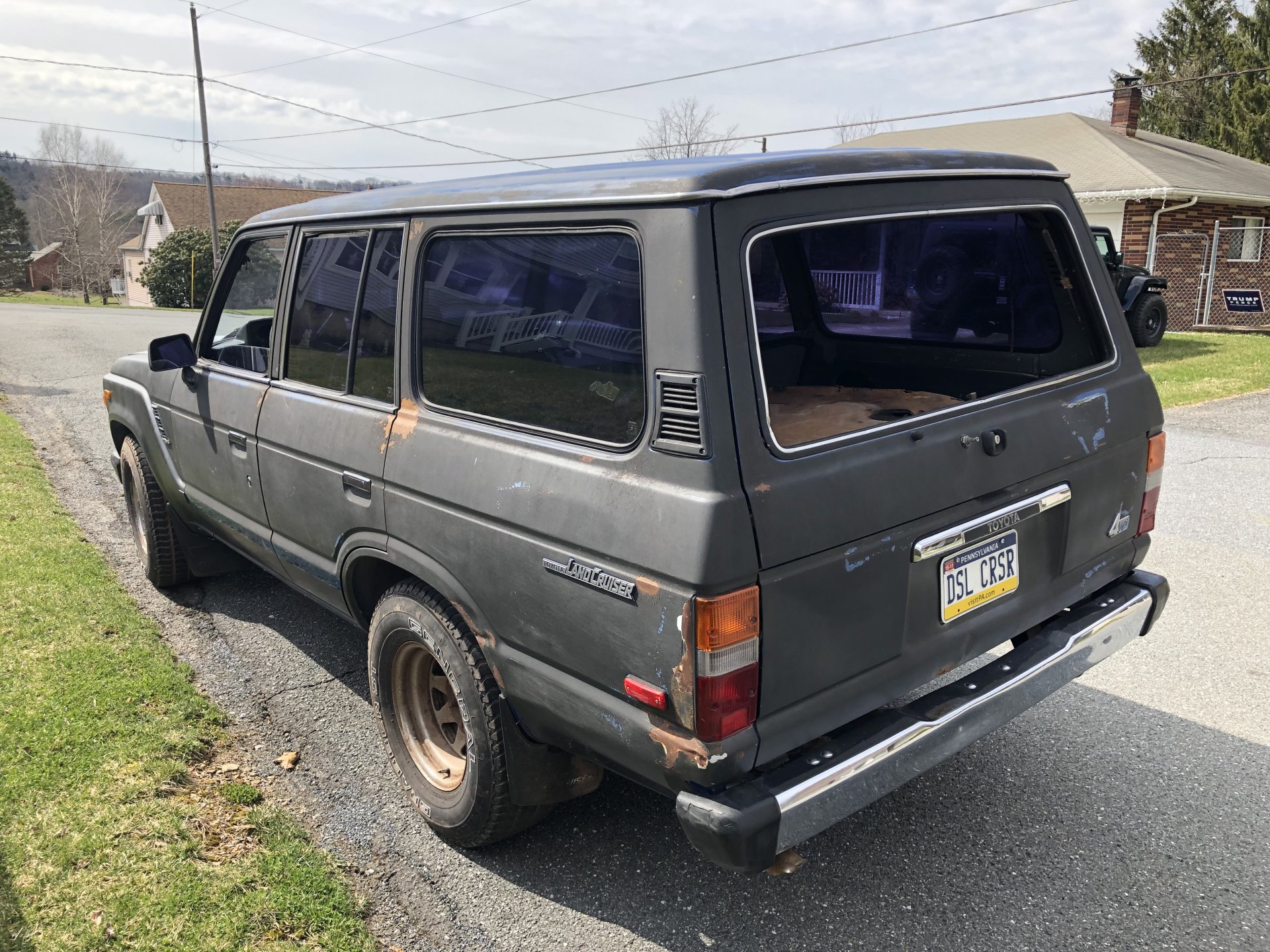

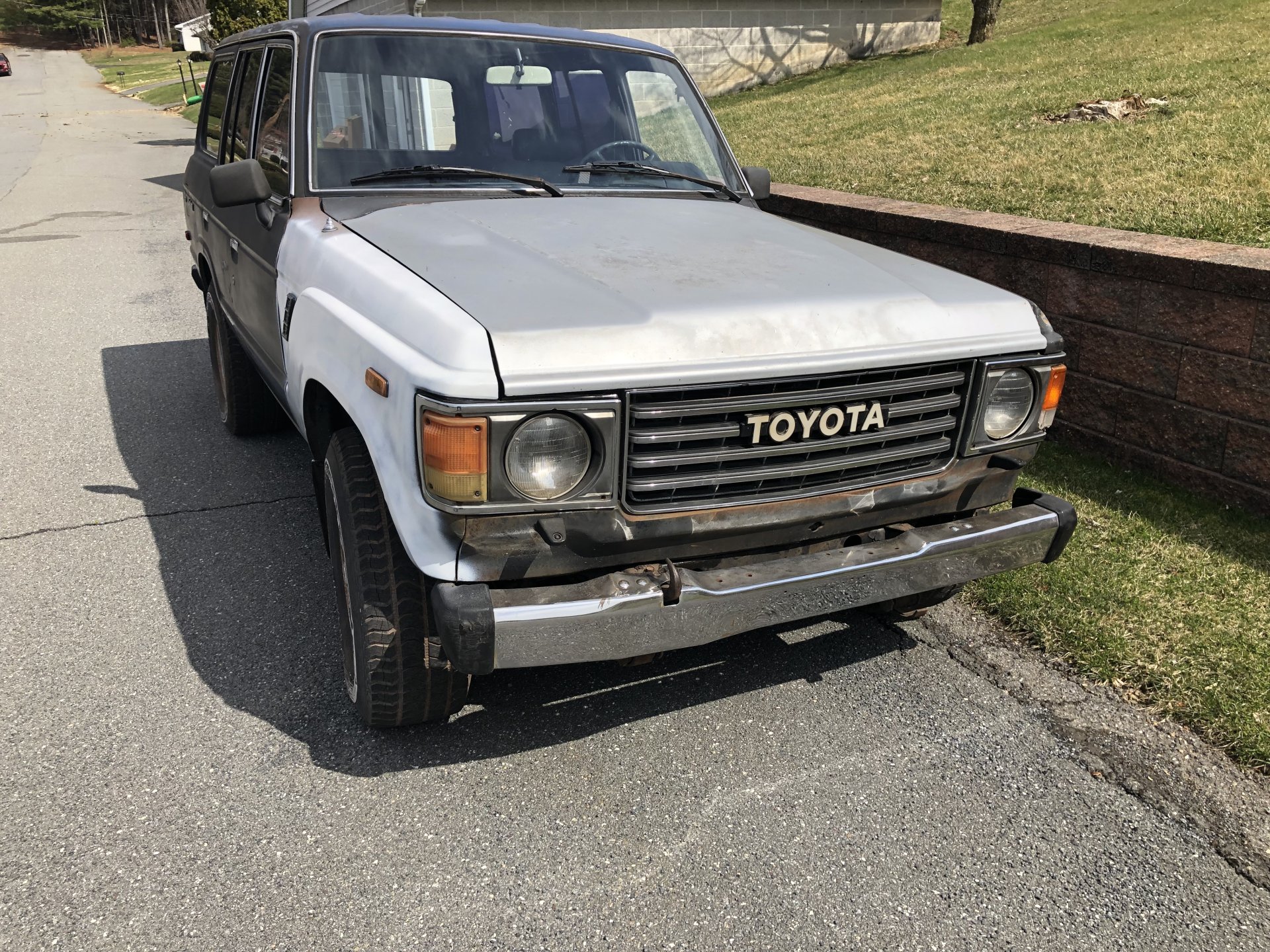

Been working trying to resurrect a long neglected 87 FJ60. Was a California truck when the guy I bought it from found it and had it shipped to PA from CA. Did I mention it was non-running as the carburetor had been removed? And the manifold not covered? That was in 2007 it sat pretty much untouched since then. I bought it, had it rollbacked to my place and have been going over it for the last few months. Had mice nests everywhere, I pulled the headliner down and removed everything in the dash to eliminate all their traces. Replaced the dash pad with a decent one I had on hand.
Back to the engine, the intake manifold was full of twigs and debris. I cleaned it as best I could, put on a carburetor and tried to start it. It turned over well but wouldn't start even though it had good spark and enough gas. I checked the compression and there were three cylinders with zero squeeze, so I proceeded to pull the head. Yes there were twigs stuck in the valves of several cylinders preventing them from closing. Borrowed John Merkey's valve spring compressor, disassembled and cleaned the head and put it all back together using OEM Toyota ($$$$$) gaskets. Fired up immediately. Engine sounds great, no bad smoke or noises anywhere. Had to replace he clutch master and slave cylinders but surprisingly enough the brakes seem to work fine. The gas tank seems fine I have only replaced one fuel filter. Clutch works great, as does the transmission and transfer, in fact the transmission and transfer are very clean and I'd bet the clutch doesn't have many miles on it. Electrically everything is working.
Frame is solid as are the quarter panels and most other body parts. The hood was rusted though at the very rear corners (????) but I had a good hood to replace it with. Unfortunately both front door windows were slightly open (for at least 15 years!) and water had gotten in to the floor outboard of the front seats. Both sides are rusted through there, but amazingly the rockers are solid. Freaky. Going down today I hope to have my body guy Phil repair the floors.
I was able to get a nice set of 33" all terrains on nice stock wheels from fellow club member Stan (thanks!!!). Even the spare tire lift/lower mechanism works properly. Has all four mudflaps and original bumpers. The seats aren't nice but I do have a set of reupholstered seats to go into it. I hate the thoughts of buying a headliner and a carpet set but if I keep it I'll be doing that. Still have to get the title and after that I might just have it on the road.

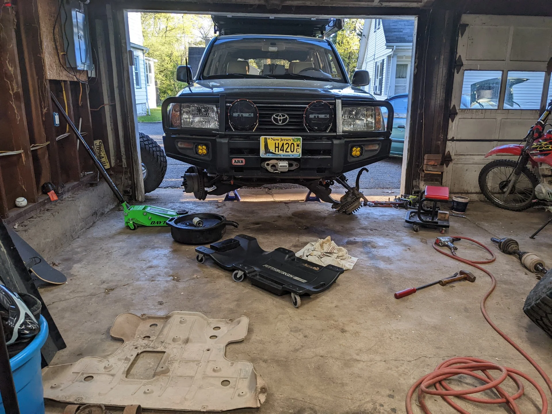

Doing axles on the ground is just no fun. I think this is the 3rd time I'm going this since I bought the truck in 2009 or 2010 and it's not getting easier each time.

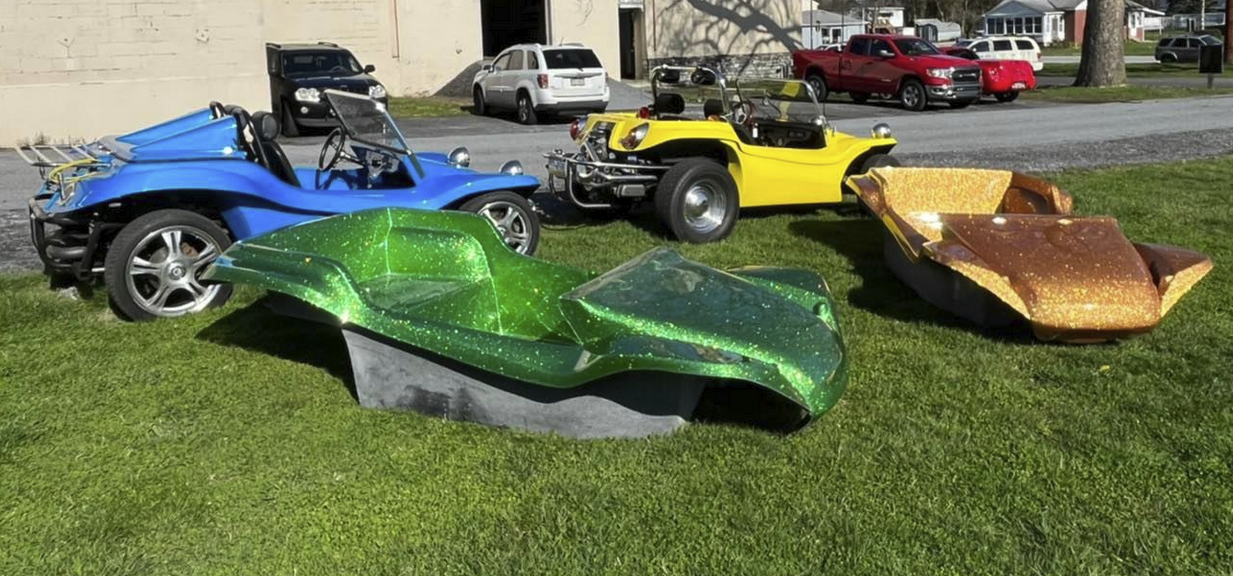

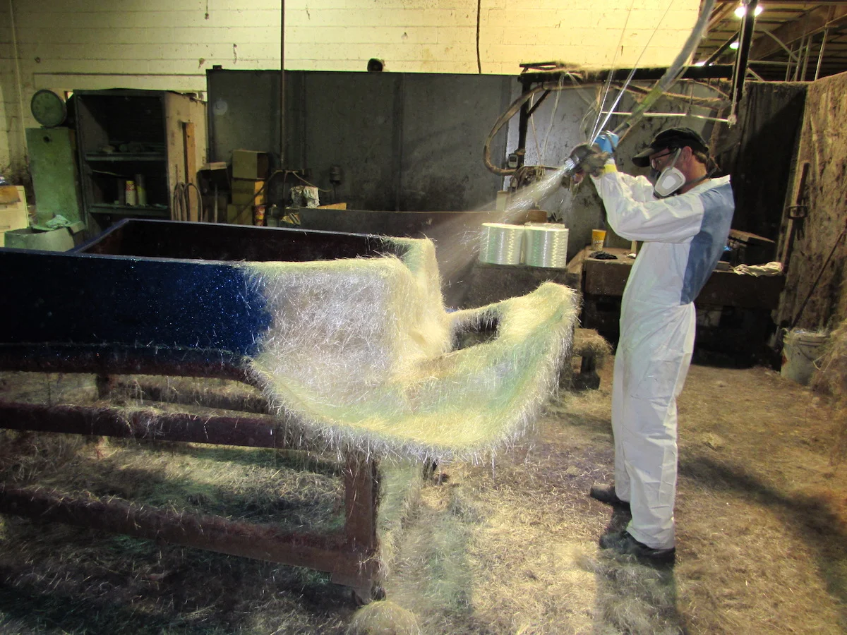

This past week I had my introduction to fiberglassing. I've done some smaller hand laid work over the years, but chopper guns and all was a new experience.
I'm itchy just looking at this picture. What are you making?
Yeah, it's a pretty hellish working environment between the fiberglass, resin fumes, and everything...
One of these in cobalt blue metalflake.
